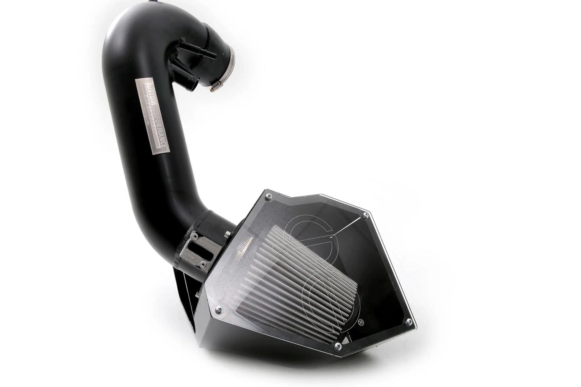

I'm installing this one tomorrow. Just waiting on my tune file to get back to me for a revision. It's got an aluminum housing, tube, and stainless steel airbox.
That is the best looking one, for sure. However, I read somewhere that the pipe/MAF diameter is smaller than the JLT. So it would not flow quite as well.
It's 110 mm. It's the same as the 15-17 JLT.
