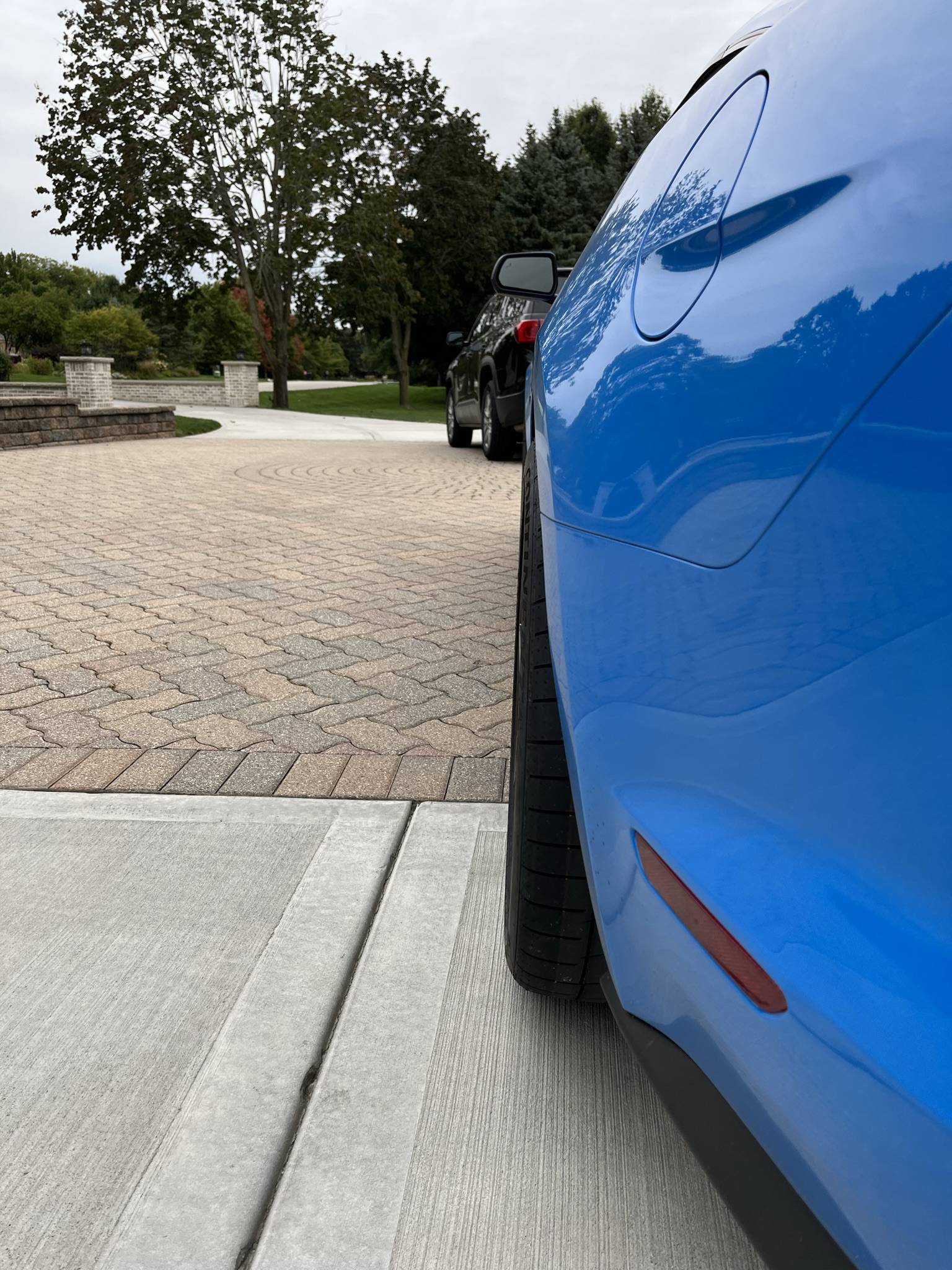

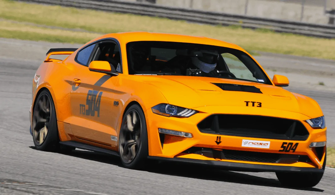

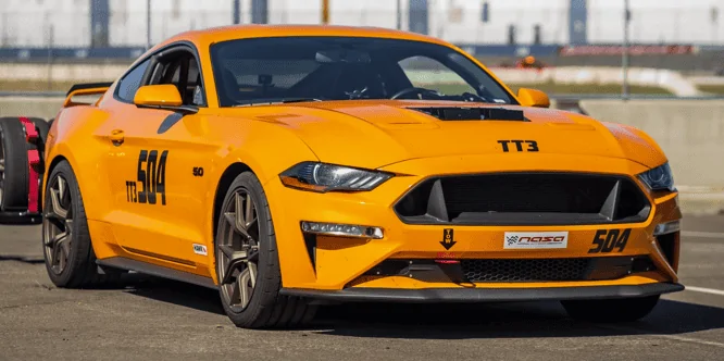

I run 285 all the way around in the warm months. +35 offset on the 20x10 wheels

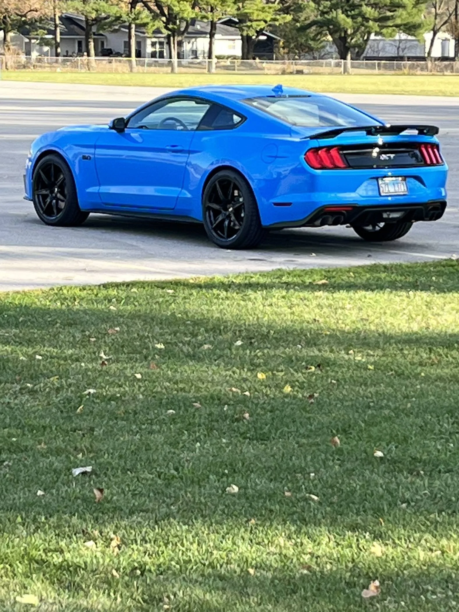

I'm running 275 front 285 rear eventually I want to go 285 squared
This looks good! Do you have any pics of the whole car from rear?
Does it pretty much look squared since the difference isn’t much or you can see the staggered look?

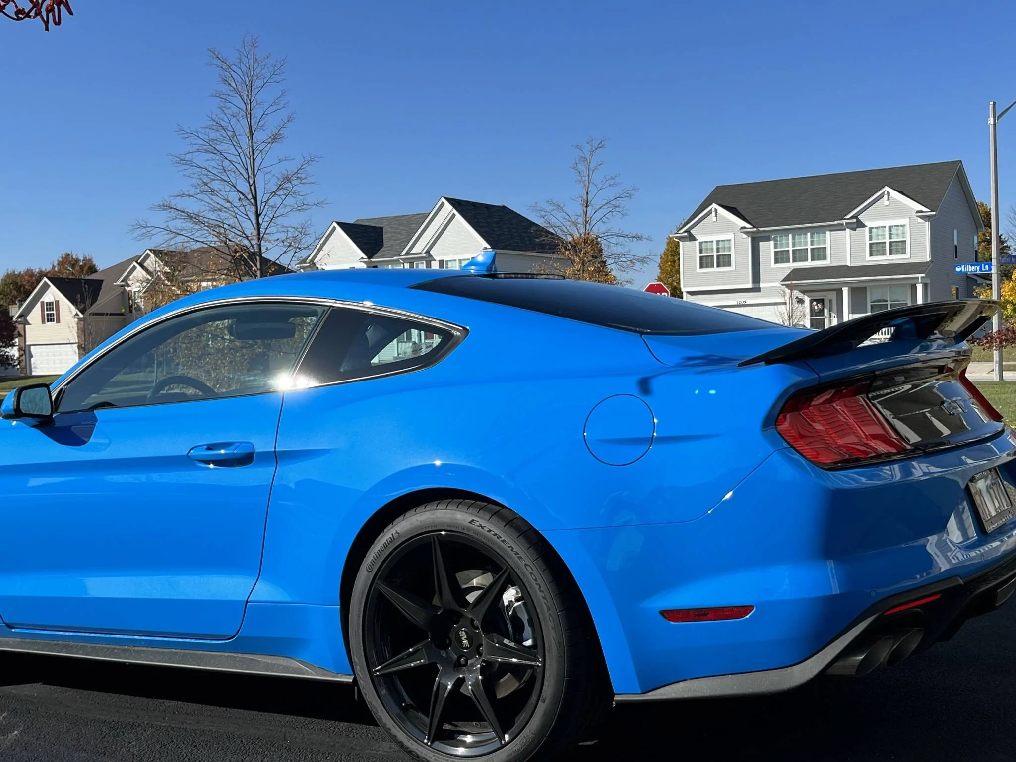

Unfortunately I don’t, this is the best I have. Winter tires are on now so unfortunately I can’t grab you a new one right now. I love the look though!
It’s not as beefy as a 305 or 315 but it’s still a pretty stout size, especially compared to the stock 235’s.
That picture gets me a good idea. My stock is 255 so that’s why I’m hoping it would be good enough upgrade in terms of looks. Performance will be better no doubt.
thanks for the pics!

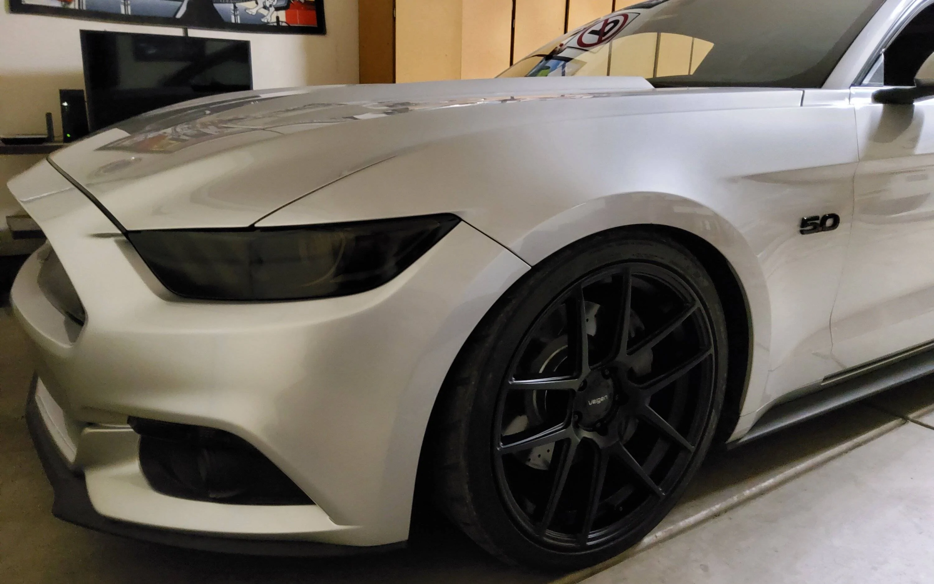

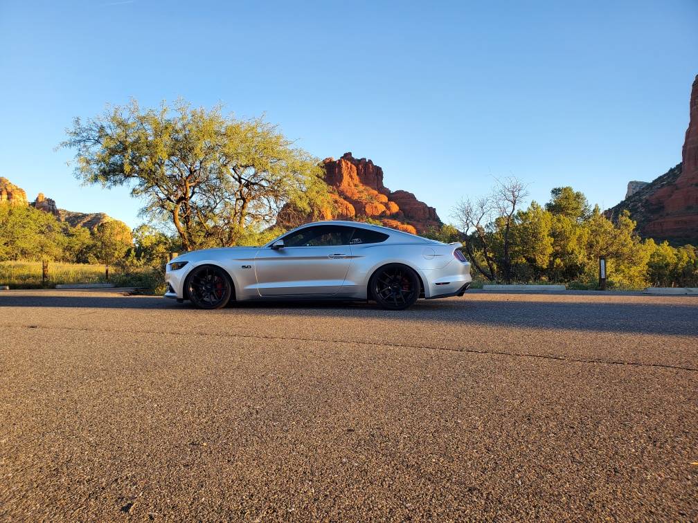

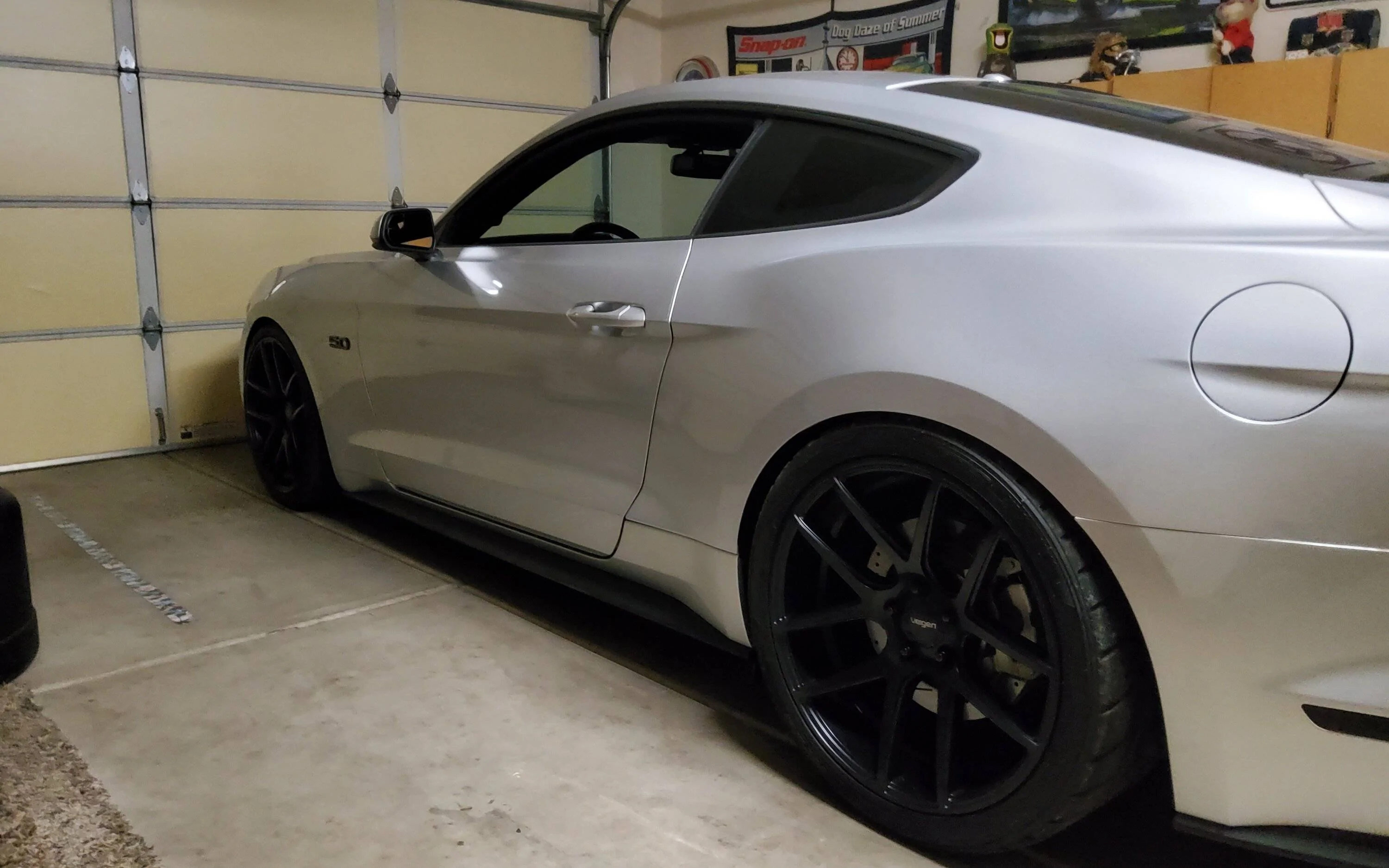

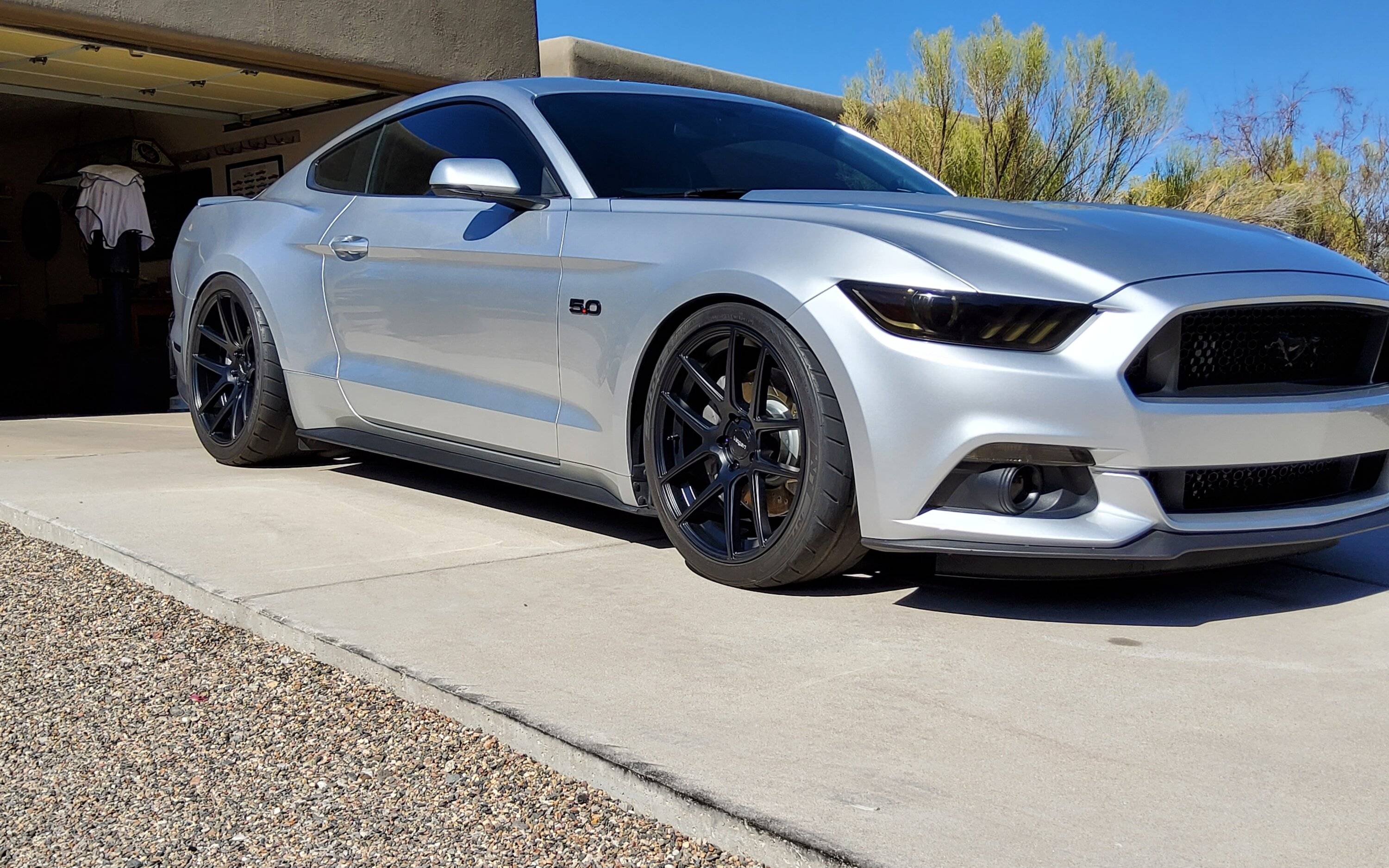

Not a 19 set up but 20 . Front 20x9.5 255/35/20+45 rear 20x10.5 305/30/20 +35 fit flush no rub.

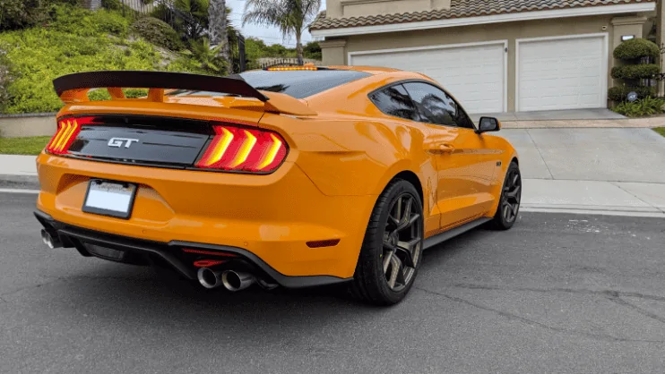

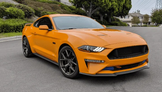

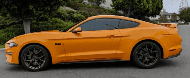

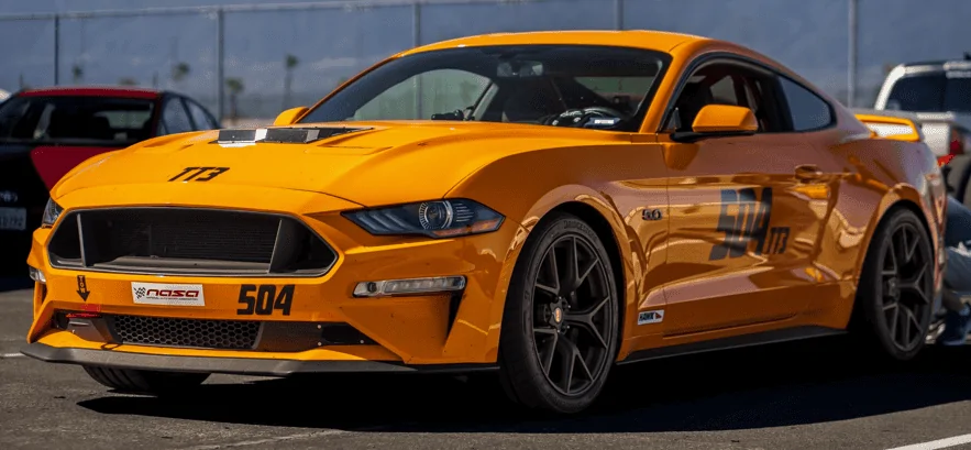

Do you happen to have 285 shot from the front or any other angle?
These are all 285/35/19 on 19x10 +35 wheels. Hope this helps!
Note: the last two pictures are with -2.8° camber on the front
a side question - did you notice any positive effect from the gurney flap? that's ZL1Addons, right?

Thank you so much! This really helps me.
Since I’m looking for 19x10+35 as well on the same wheels.
probably a dumb question but I know sve 19x10/11 kit has +35 off set in front and +50 in back. If going squared you use +35 offset in back too?
sorry new to offsets but I’m assuming since rear is 19x11 it would require +50 but if I run 19x10 I’d run +35 offset even in the rear.

Correct, you would get +35 all around.
The nice thing about squared is you can rotate them. before I had the SP2s I had the PP wheels and ran a 20mm spacer. with the SP2s I don't use any spacers.
Keep in mind a 285 is 30mm/1.18" wider then you factory tires. It will make a noticeable difference.
