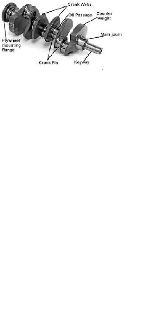

I have a thought…..hate to admit it, but I made this mistake when i rebuilt my engine.
I had the same issue with my crank and spent a significant amount of time trying to figure out why it wouldn’t rotate completely. After a few weeks of head scratching, I removed the oil pump and shockingly it would rotate freely and easily. Turns out, I got a few bolts mixed up and one of the crank counterweights was hitting the bolt.
Hope this fixes your issue.

Just wondering. Where is the crank counterweight? I have to say I have not seen a counter weight on a crankshaft.
Thanks

I must have got what you said wrong. I thought you said something about a bolt on the crankshaft counter weight which their are none. The crank counterweight lobes are used to balance the crank shaft by removing material from them. My bad
