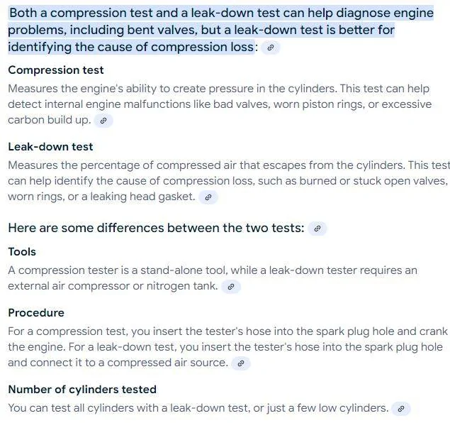

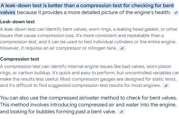

Everyone has their own opinion as to what works best for them. For me, The engine is to expensive to not do a thorough inspection and checks. For me, A compression check wouldn't be the best way to go to find a slightly bent valve. Its a good quick check for overall cylinder condition at a race track, but not the best for checking valves and valve seats. That's just me
https://www.google.com/search?q=com...IDBRIBMSBAkgcDNS4xoAeEIQ&sclient=gws-wiz-serp
https://www.google.com/search?q=compression+check+or+Leak+down+presure+check+to+check+for+bent+valves&sca_esv=12e82f26f75a1e30&sxsrf=ADLYWIJ4s-nC9auzNzQBdQ-kb2LofBzSIQ:1728585389931&source=hp&ei=rR4IZ8j9Nd3B0PEPxf2HkAo&iflsig=AL9hbdgAAAAAZwgsvUnRsRs3Fz0BoUNnm5QpLqZyJtaj&ved=0ahUKEwiIiIOxuoSJAxXdIDQIHcX-AaIQ4dUDCBg&uact=5&oq=compression+check+or+Leak+down+presure+check+to+check+for+bent+valves&gs_lp=Egdnd3Mtd2l6IkVjb21wcmVzc2lvbiBjaGVjayBvciBMZWFrIGRvd24gcHJlc3VyZSBjaGVjayB0byBjaGVjayBmb3IgYmVudCB2YWx2ZXMyBxAhGKABGAoyBxAhGAoYqwIyBxAhGAoYqwIyBxAhGAoYqwJIl50BUABYu5sBcAB4AJABAJgBiQGgAY0lqgEFMjguMjG4AQPIAQD4AQGYAjCgAqclwgIEECMYJ8ICChAjGIAEGCcYigXCAgsQABiABBixAxiDAcICERAuGIAEGLEDGNEDGIMBGMcBwgIQEAAYgAQYsQMYgwEYigUYCsICCxAuGIAEGLEDGIMBwgIOEC4YgAQYsQMY0QMYxwHCAgUQLhiABMICCBAAGIAEGLEDwgIFEAAYgATCAg4QABiABBixAxiDARiKBcICCxAuGIAEGNEDGMcBwgILEC4YgAQYxwEYrwHCAgYQABgWGB7CAggQABgWGB4YD8ICCxAAGIAEGIYDGIoFwgIIEAAYgAQYogTCAgUQIRigAcICBRAhGKsCwgIEECEYCsICBRAhGJ8FmAMAkgcFMjcuMjGgB4jKAg&sclient=gws-wiz
