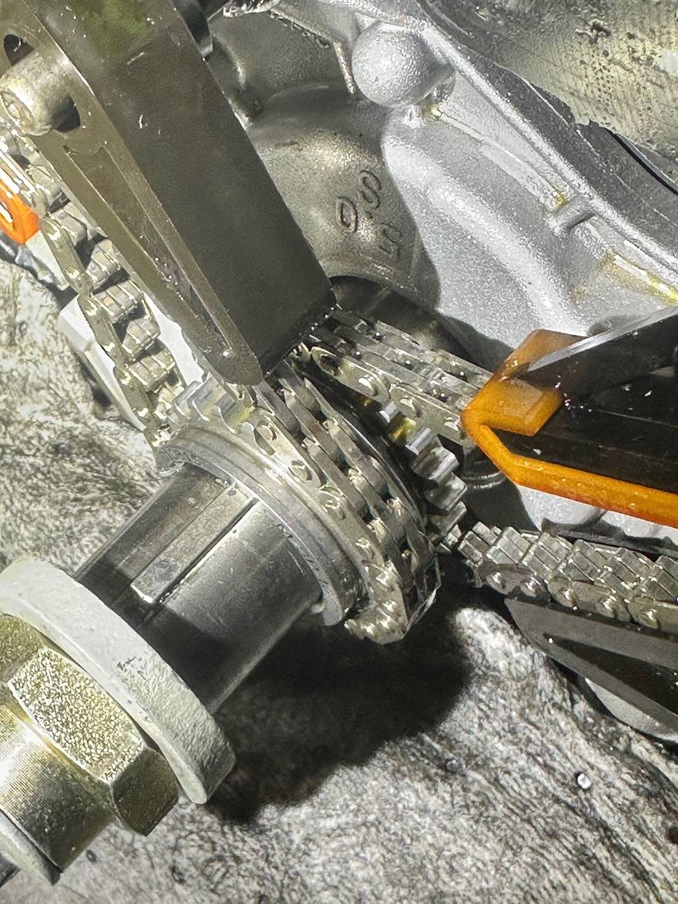

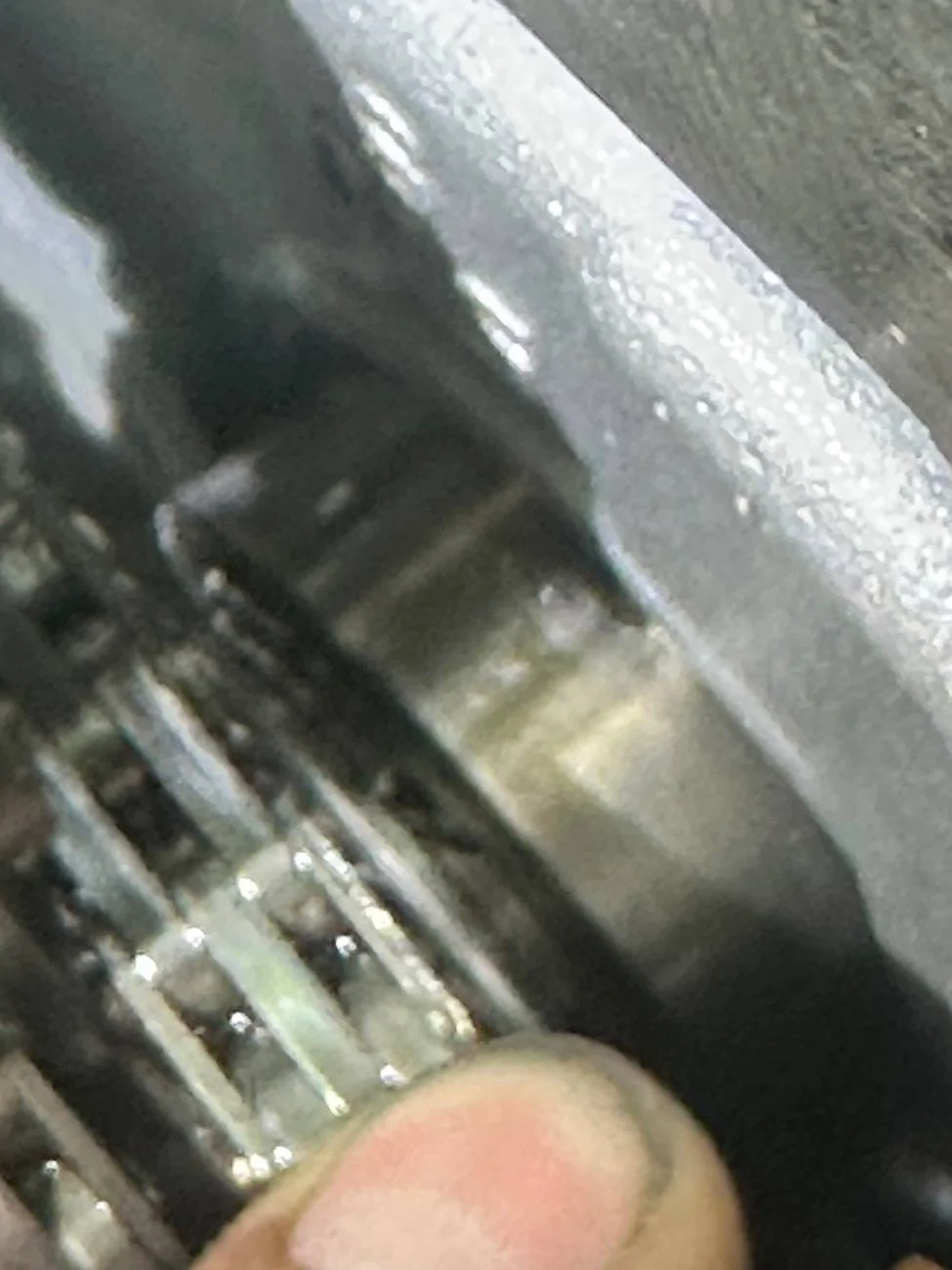

I installed a opg and the crank sprocket went to start the car and now it’s making a sound pulled it all apart and saw my crank sprocket isn’t all the way back at least I don’t think it is and now I can’t move it idk if they are press fitted once your but the cover on or what but I need advice does anyone know if this gap is normal behind the sprocket?

There should be no gap between the sprocket and the crankshaft. The harmonic balancer is what presses the sprocket against the crankshaft.

Yup you were right i pulled it all apart and it slid right back thank you hopefully the noise is gone now 🤞

The damper pulley bolt is torque-to-yield, so make sure you have a new one, or are using one of the aftermarket stud kits
