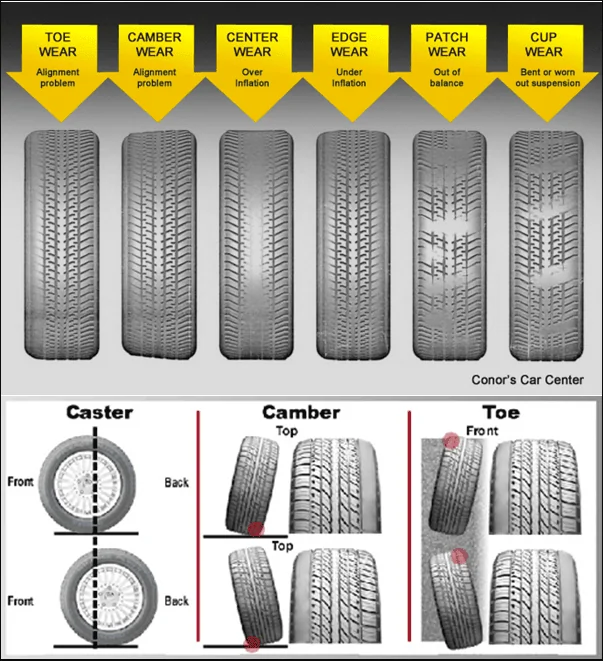

I'm to understand that wearing of inside edges isn't about camber, but toe.
Evidently the key is 0 toe.

We're not discussing track tires with 50 laps/1000 highway KMs on them.
The OP asked about DD street tires. I'm offering info others have shared with me about alignment, and from my DD tires with 18,000 miles on them that are fine everywhere except the inside edges, just like the OP's.

Your one example means nothing because you're out to make a point, and there's too many other variables. Never the less this is well known information;
