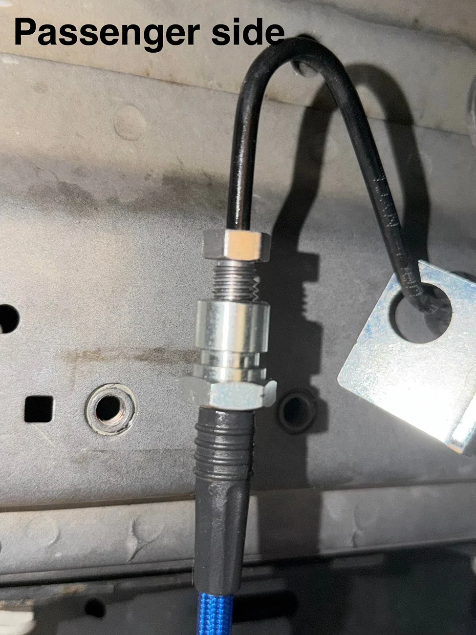

the situation: 2017 ecoboost (base). Upgrading front calipers to 4 cylinders and installing new Steeda braided hoses ((These are the new hoses)
The driver side hose screwed just fine to the factory hard line.
The passenger side. oh the passenger side. what a time consuming PITA!
I can turn the Steeda hose about 5 turns by hand then it stops. I am VERY concerned of cross threading the factory nut.
what's interesting is that I can take the original 2 caliper factory hose and thread it by hand all the way in.
Has anyone else had this issue. Maybe I just need to power through it by cranking it up with the flare wrench. Just don't want to deal with having to take the car on a tow truck to get the line replaced (if I screw it up)

Common issue. The fix is to get a nut from a hardware store, thread that all the way on, then off, a few times, to clean up the threads on the car. *I think* the nut you need to buy is an M10x1.0, but search around and confirm.
It's a super common problem anyone who has replaced the line has had to deal with. Sometimes all 4 are bad, sometimes just one.

Go to the hardware store and buy a 10x1.5mm nut and thread it on the line fitting. Whoever tightened the lines at Ford had a habit of over torquing them. It distorts the thread and the only line that will thread in will be the factory one that matches the stretched threads. Run the nut over the fitting line nut and it will clean up the threads.
If you have any other line from the kit try it. 9 times out of 10 its never the hose.

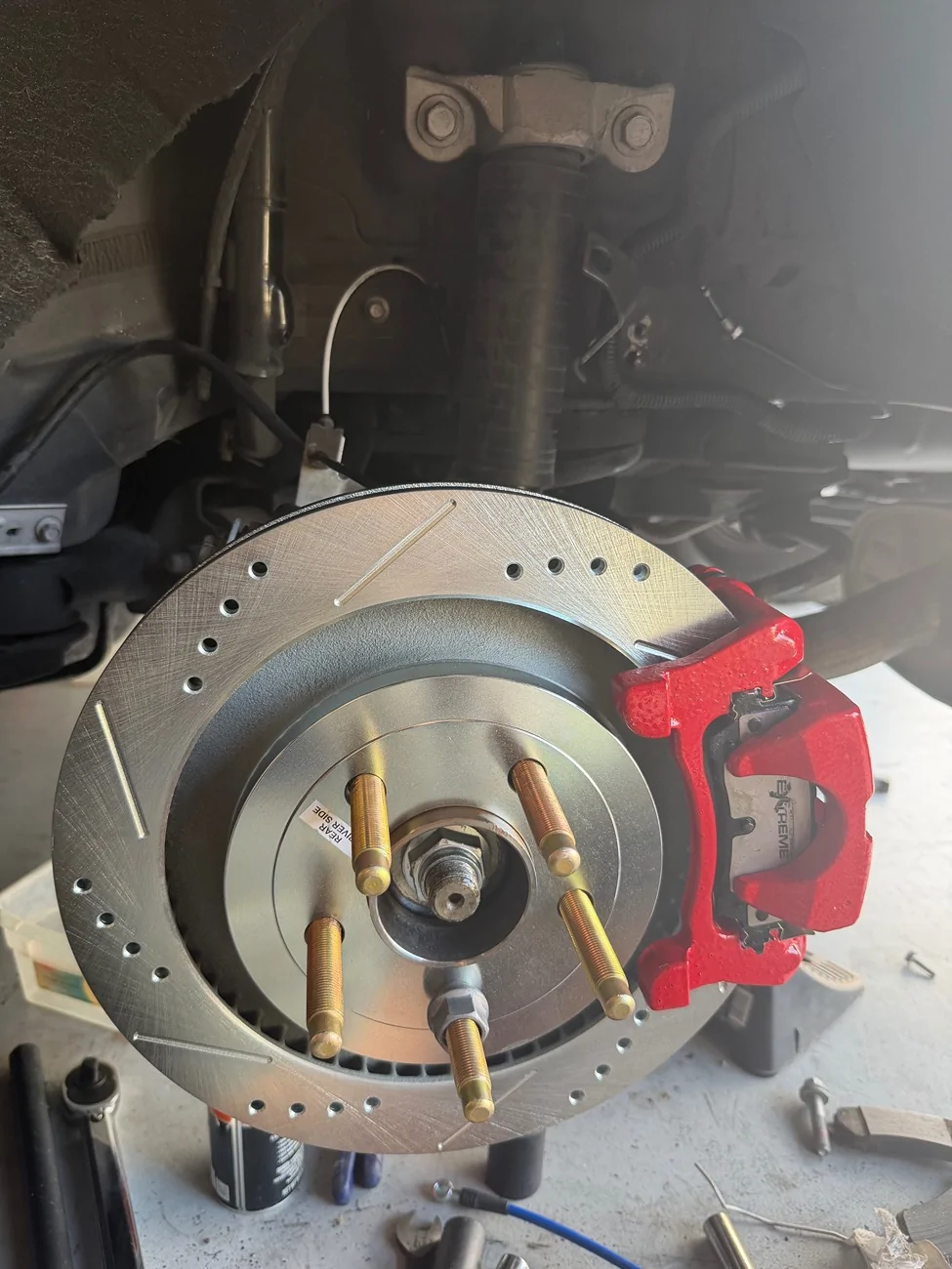

Update for y’all.
I was able to get the front line fine with the nut retreating idea.
The first rear line I removed today ( driver) is also strip. Curse Ford!!
The nut is not going to work on this one.
So what choice do I have now?

You may be able to stretch the line enough to cut it and re-nut it or buy a line section and splice in a new section, or the lines 'should' still be available from Ford. You can splice in the section you need in a convenient place from the Ford line. You would not be the first one to find them destroyed, and have to replace a line. Just need to match up the correct type of flare, you can compare them at a Parts store which type of bubble flare they used from your existing line, you will need a flaring kit, they all work fine, even the cheap ones.

Thanks.
I’m very handy. But I’m Not sure I want to mess with flaring the lines. I’ll try to run it through a thread chaser first. Then may need to get someone with better skills to help me.
I mean the brake job looks awesome and is very detailed so far. Even replaced the hub. Just these dang brake lines.

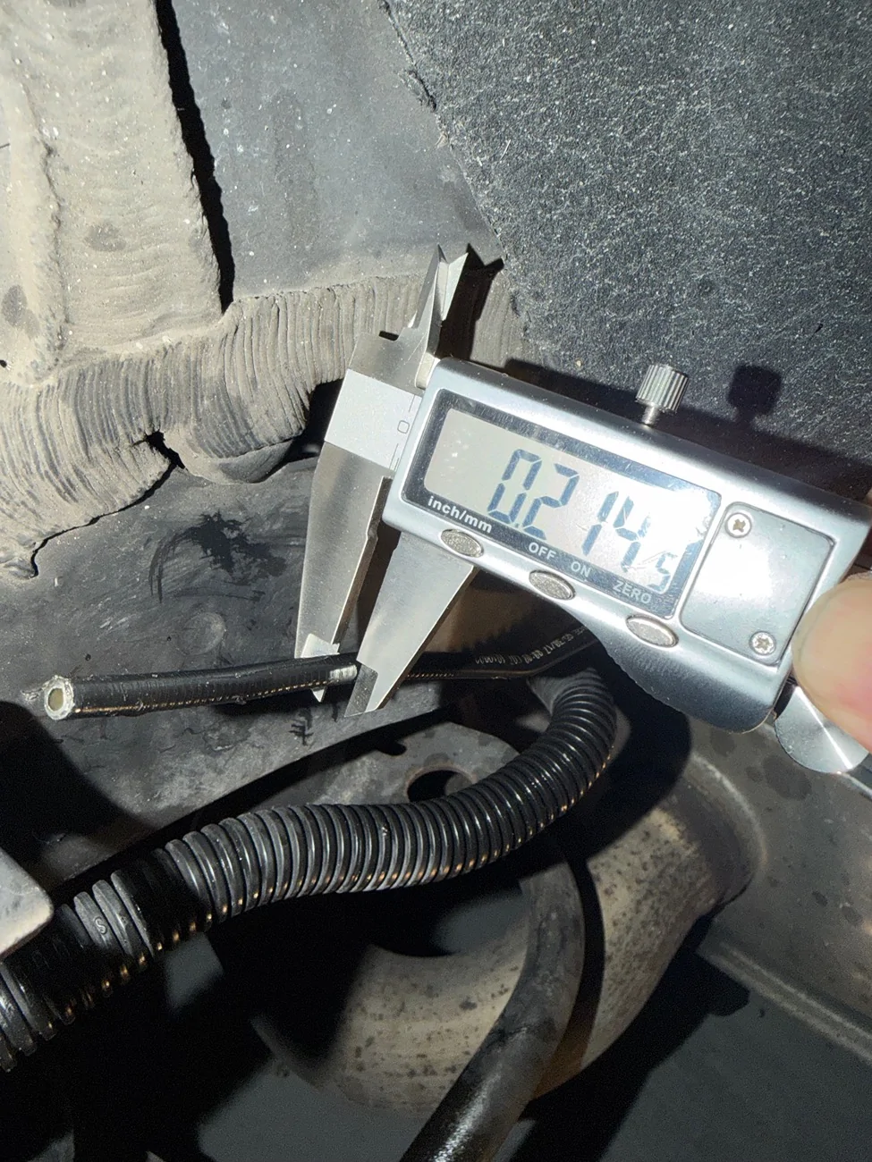

I decided to flair myself. Titan has an easy to use tool.
I bought 3/16” flare coupler and line (just in case). Also bought new M10 x 1.5mm 3/16 from brake connect.com.
Issue now is that new fittings: Coupler new flair nuts will NOT go over stock ford line.
it appears to have a black coating over the line.
Either I need to takeout the coating.
or
This is a 1/4” fitting. But 2017 mustangs came with 3/16” lines. From all I read.
Anyone have experience with this?
thanks in advance.

They make several different fittings with the same thread for different line OD.
hopeandadream
Feb 18, 2026
fort lauderdale, florida
2017 ford mustang ecoboost premium
The hard line actually measures 5mm
diameter I cannot find anything that meets those apexes. The Male M10 x 1.5mm I see are all 3/16. Very frustrating. I’ll call the dealer to see if I can find the whole line. But finding it online.
