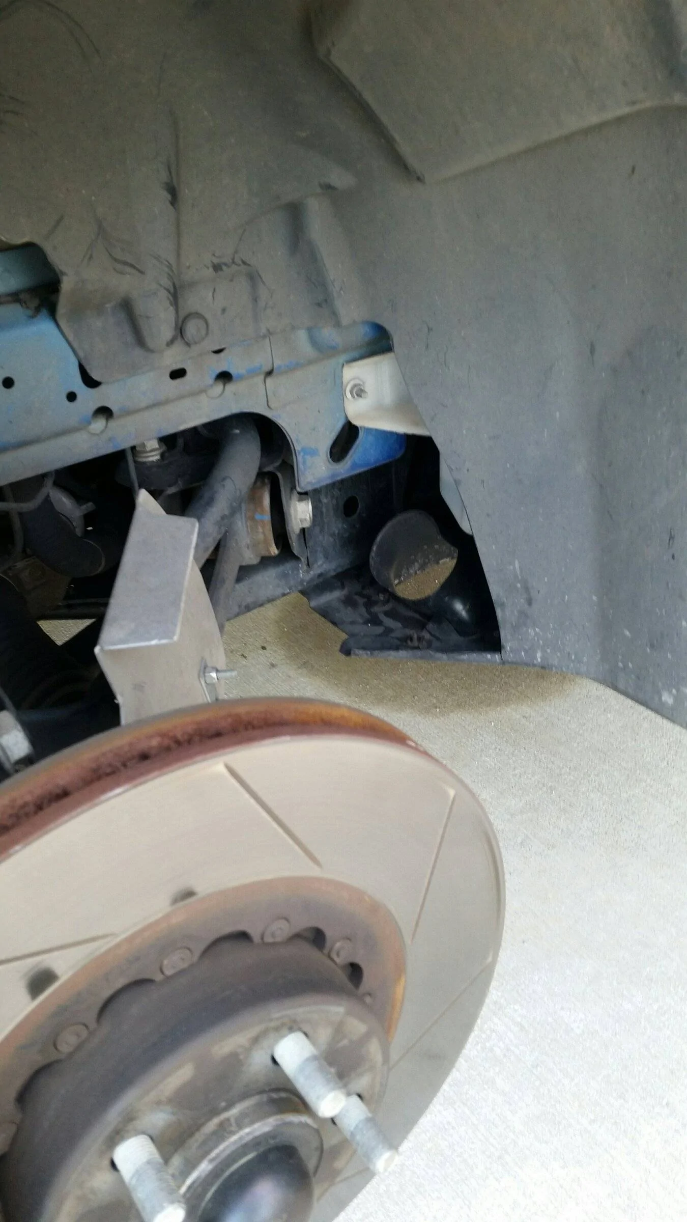

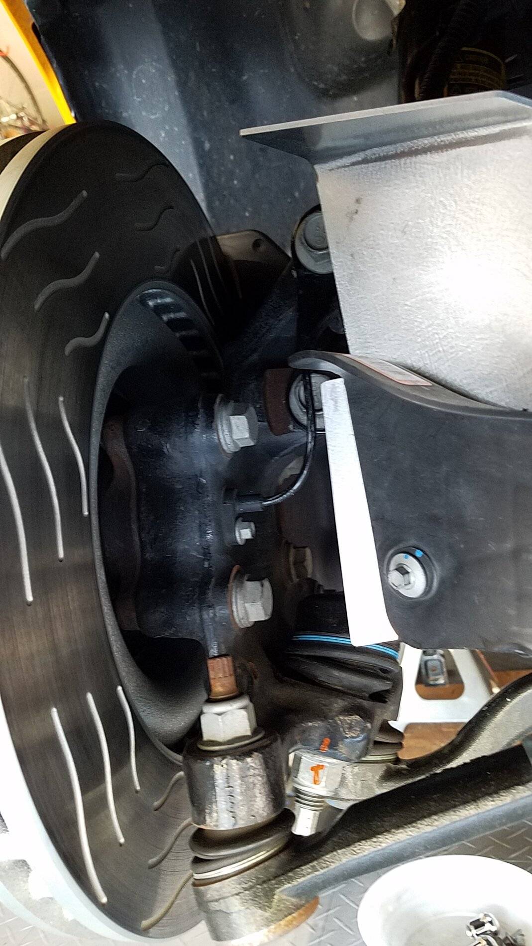

Well I'm a little slow but here's a photo... finally :)
