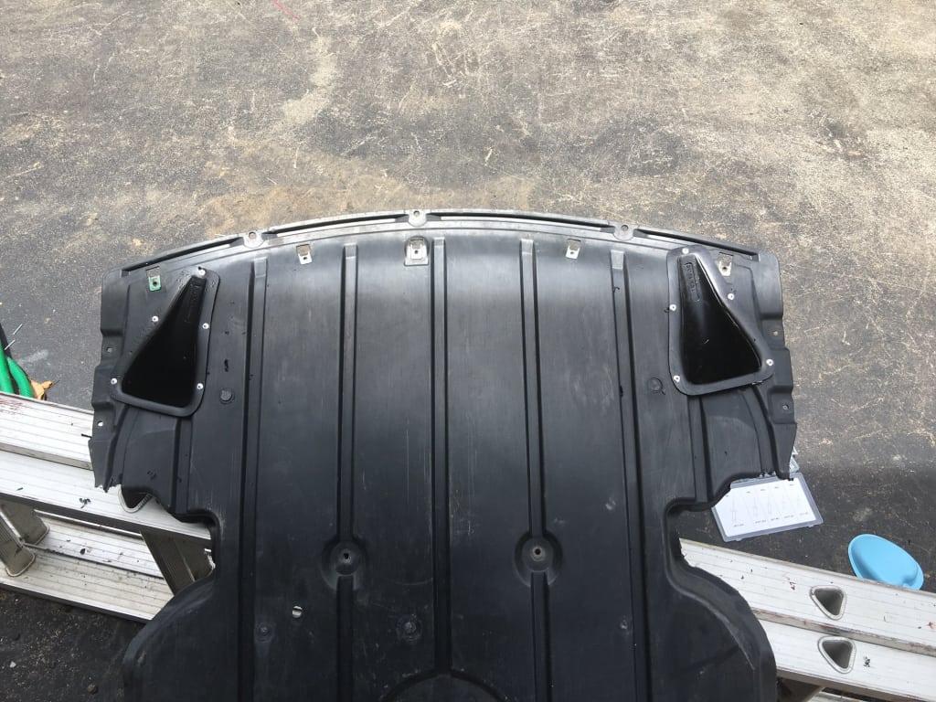

The belly pan would look something like this, except the scoops would be farther back on the Mustang's.

Also, the GT belly pan has small air valleys on it that look like they don't do much of anything but Ford claims they help cool the brakes, so herewith my idea - improve the belly pan to true functionality with NACA scoop inlets.
The GT performance pack (GTPP) belly pan has air channels to send air toward air deflectors on the GTPP control arms which direct air toward the brakes. The parts work in conjunction with each other so you'll need the GTPP control arms to get max benefit from the air channels. The gt350 belly pan also them and air channels for the transmission.

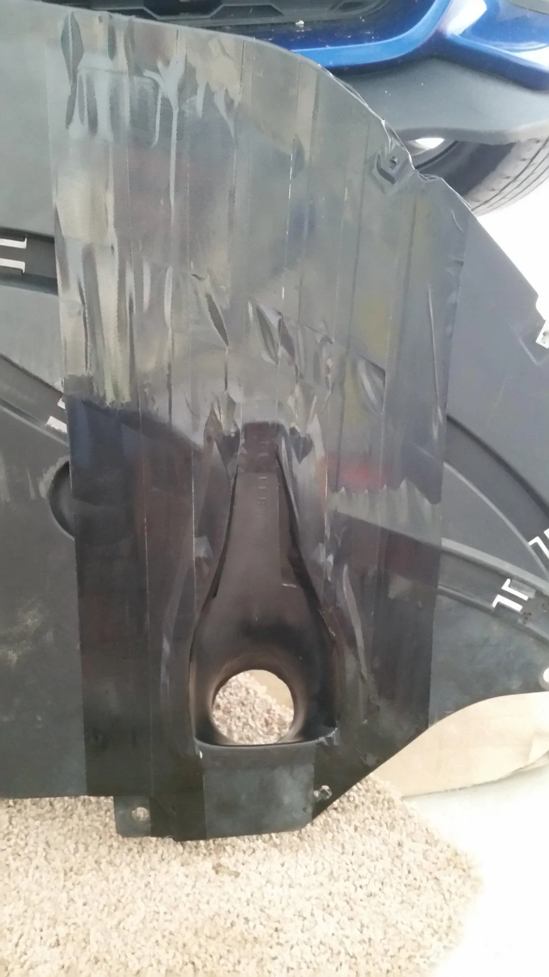

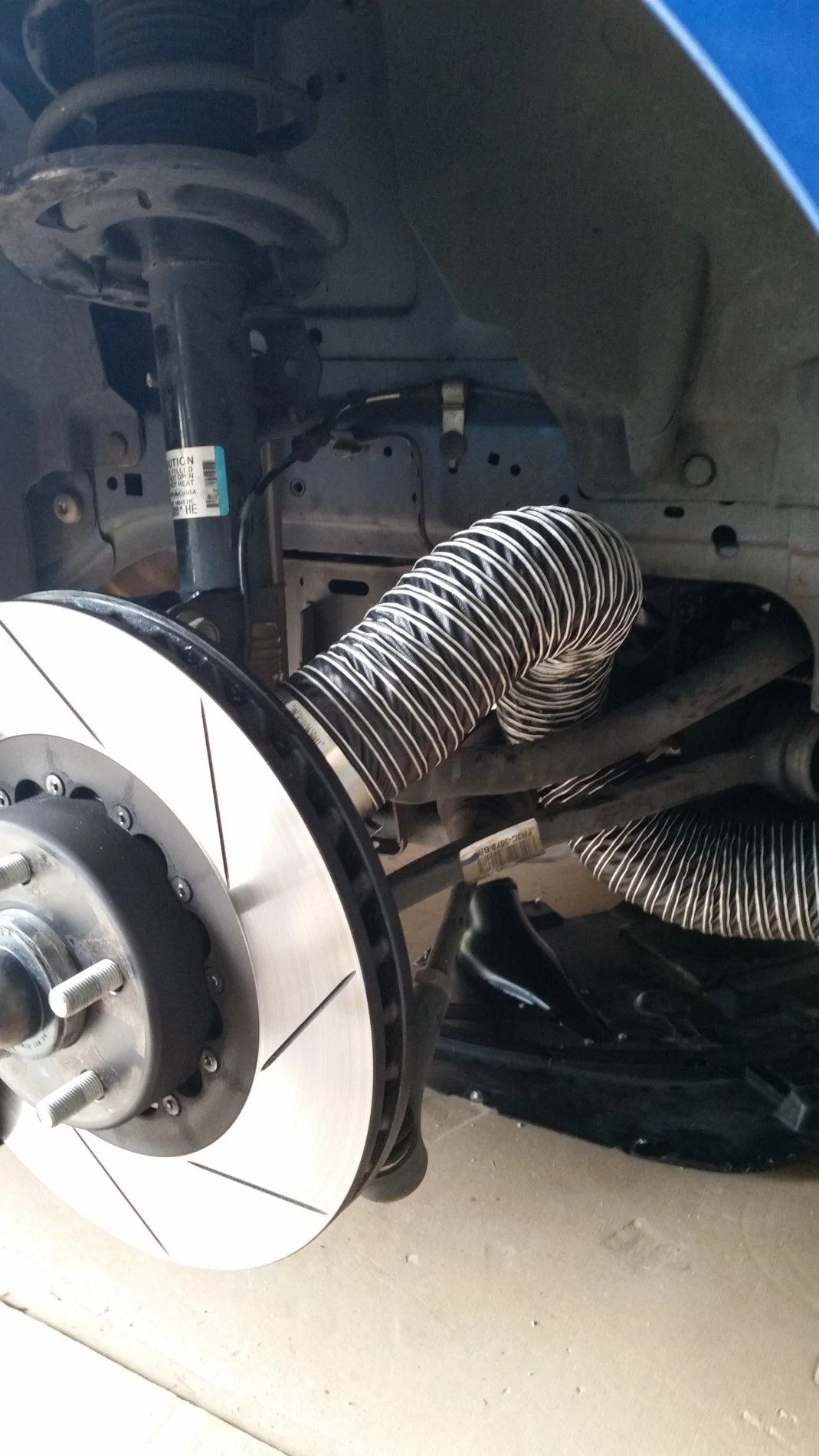

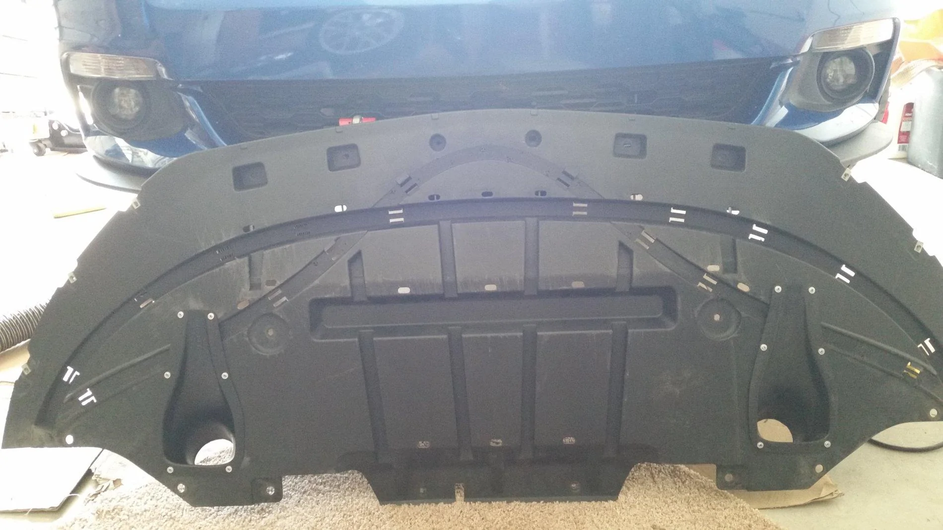

Project completed. Note the channels in front of the inlets that will cause turbulence; I did a quick and simple short term fix by adhering high strength duct tape in front of the inlets to cover the channels and hopefully work well enough to provide laminar airflow to the inlets.
I plan to cover one of the inlets with tape on the first morning run at VIR, then take readings of both front rotors and calipers with a temp gun as soon as the session is over to compare temps between the functional inlet and the closed one . Hopefully it will indicate a decent effectiveness. We'll see.
