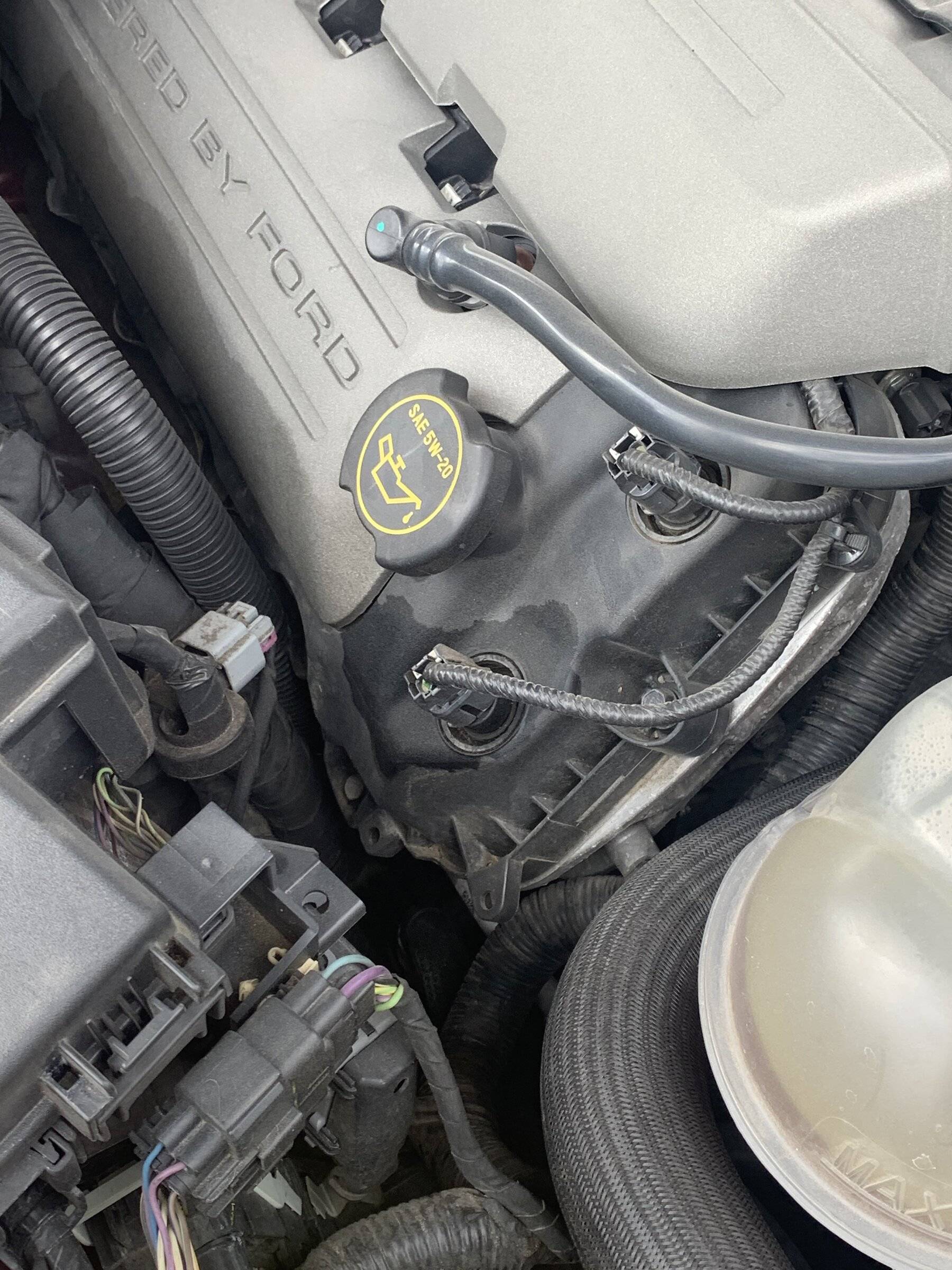

I also wanted to know if anyone had any insight on this pooling on the right side of my engine near what seems to be a sensor:

I d say the picture is oil residue either from someone dripping when filling or maybe the sensor has a seal that s bad. I would get some parts cleaner/brake cleaner and spray the area clean and then just monitor it. Make sure if anyone puts oil in that they don t drip any. I would n t refer that as pooling.
This. 90% chance that's just from spillage during an oil-change.

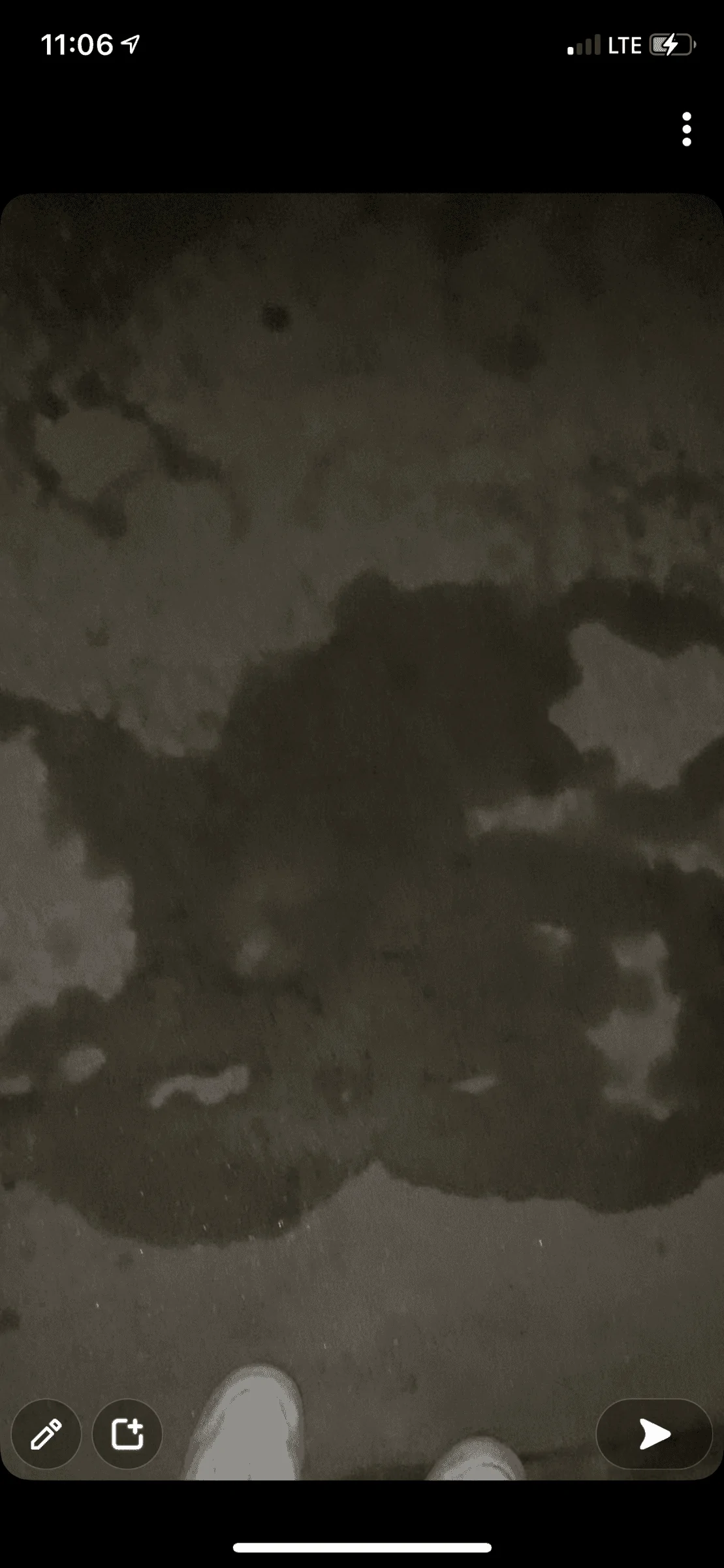

and as for under the car, here’s what happens: sorry for bad picture was in a rush

Usually if you are running A/C or the defroster, the condensation from the HVAC system purges through a drainage hole in the firewall (inside of engine bay, passenger side, bottom towards ground). The "fluid" is water and will pool on the ground. Usually this is present under passenger side and is more noticeable at home in driveway or garage.
The other spot you see on top of your valve cover is definitely oil residue. Spray with Simple Green, and wipe dry with a microfiber (paper towels will just tear up). I'd guess like others have mentioned - from an oil change.

the garage floor looks like water. so you really have no issues at all here. Good to go!

Living in atl I always see a sizeable puddle under my car in the garage and seeping out from under it on a hot day with a.c. rinning. try not running your ac and see if you still get liquid. Of you Ron hvac system on auto the a.c. will always run.go into your climate control and make sure you turn a.c. off.

Floor is easy to check. Get some on your fingers and rub them together. Water (condensate, as suggested above) will feel like nothing. Anything else coming from the car, be it engine oil, transmission oil, brake fluid or coolant, will feel greasy between your fingers.
