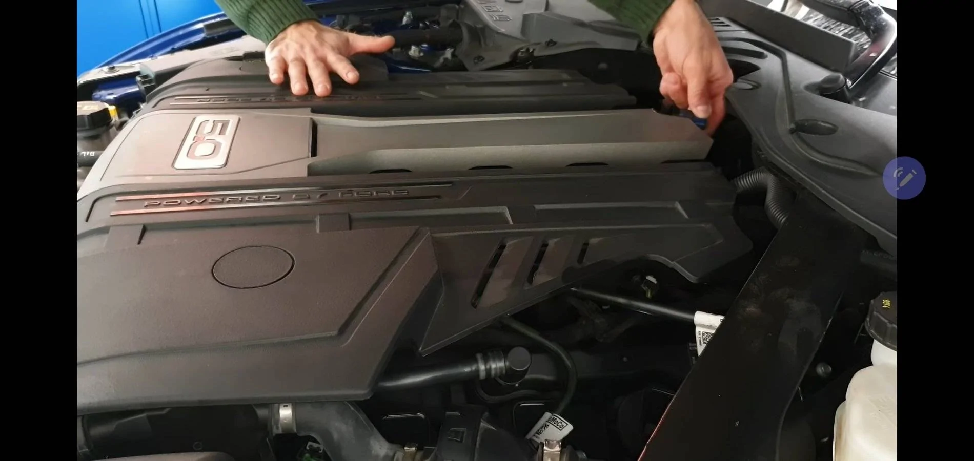

My manifold sounded very similar. When disconnecting the IMRC the sound went away.
Hopefully the swap will sort it out on yours
I hope so, fingers crossed.
Cobra Jet
Feb 12, 2015
771
17,554
19,981
Just had a phone call from the dealer, new manifold installed......noise gone....I can’t tell you how bloody happy I am right now. Pick up tomorrow!!
Great news!
