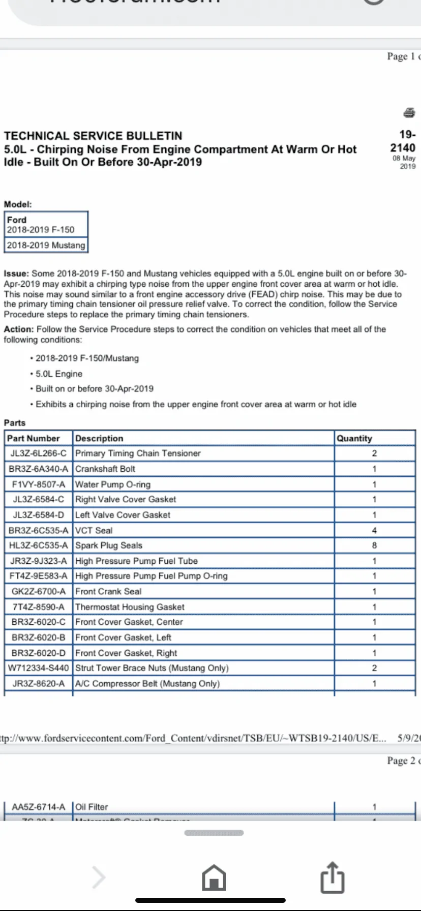

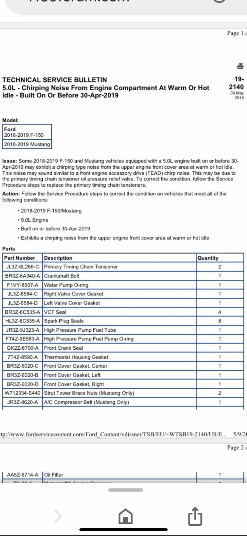

More comments from the peanut gallery. My car started chirping loud one day out of the blue only on start up and lasted until engine was at normal running temperature. Brought it into Ford they changed timing chain tensioners and its gone. So if there’s noises that accumulate from wear or whatever the case may be. The forums was where I found the tsb to bring to Ford to correct that loud chirping issue because everyone knows that some Ford dealerships you have to tell them
whats wrong and how to fix it. Everyone knows cars make noises fuel injectors, etc. 12 to 1 compression motors are gonna have noises. So to all the miserable too much time on there hands (if noises bother you) morons. Keep the negative comments to yourself.

Deceleration rattle was always there on 2019. Chirp started after a couple of thousand miles.

This tsb fixed chirp not the rattle. Technician said tensioners were no good. So I can deal with noises but ones that just pop up out of no where.
Id rather they had my car for 12 hours when they changed tensioners than have more issues occur down the road and tell myself cars make noise just keep driving and I’m stuck with a 4 cylinder fusion loaner for a month.
