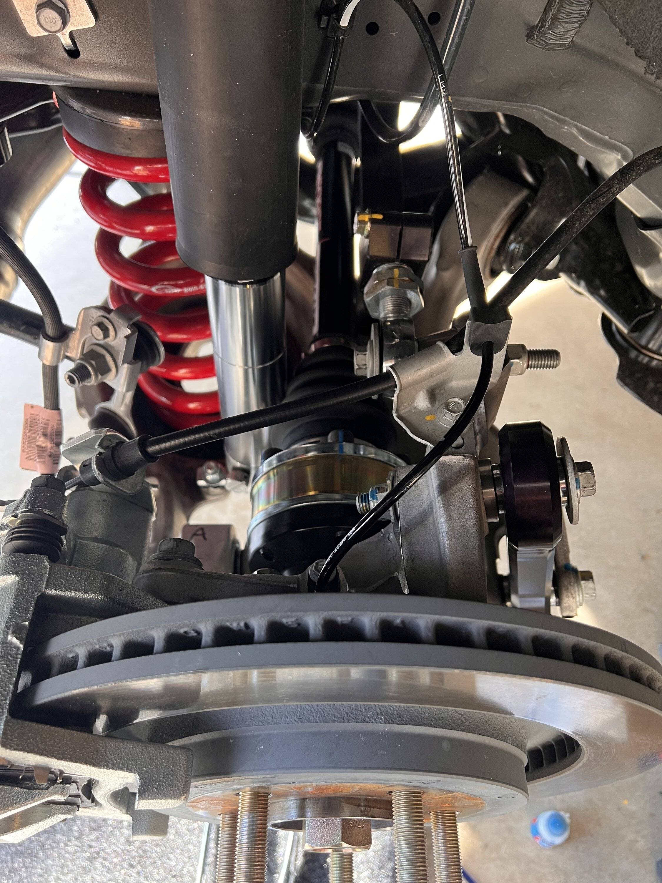

My IRS drag setup for 2023
WoodburnGT
Oct 24, 2021
41
336
869
Oregon
2022 Mustang GT
G-Force Renegade axles
BMR Drag springs
BMR Billet vertical links
BMR Billet camber arms
Viking Double adjustable drag shocks
Kelltrac IRS Lockout kit
ARP extended studs
Steeda billet differential kit.
Yes, I have plenty of NVH with this setupšŸ˜‚, but it’s a dedicated bracket car that’s never driven on the street.

I have a couple of quick questions for you. Did you install the BMR upper shock mounts too or stay with factory? How bad is the NVH on a scale of 1-10?
I have a magneride car and was looking at some Viking Triple Inverted Drag Shocks for my car. Was wondering if the upper mounts would need to be changed. Thank you.
I still have OEM shock mounts. As far as NVH….my license plate is ā€œNVHx2ā€šŸ˜‚ …..but my GT is a dedicated bracket car. I’d hate to daily it with everything I’ve done to the rear ended. I’d say every piece you add for drag racing will alter the NVH.
Just spoke to Kelly(Kelltrac) this morning….I’m gonna go with the inverted double adjustable and sell my Viking Crusaders.
What components do you think attributed to the high level of NVH? Are you just getting clunking with the components you have, vibration only or both? I have just about every rear suspension component I can add (except shocks, sway bar and springs) and my NVH is on the very low end of the scale.
I wouldn’t say it’s extreme….it’s just very noticeable. No vibration….just some noise and clunking, it’s definitely more stiff. Billet differential inserts definitely added some noise.
