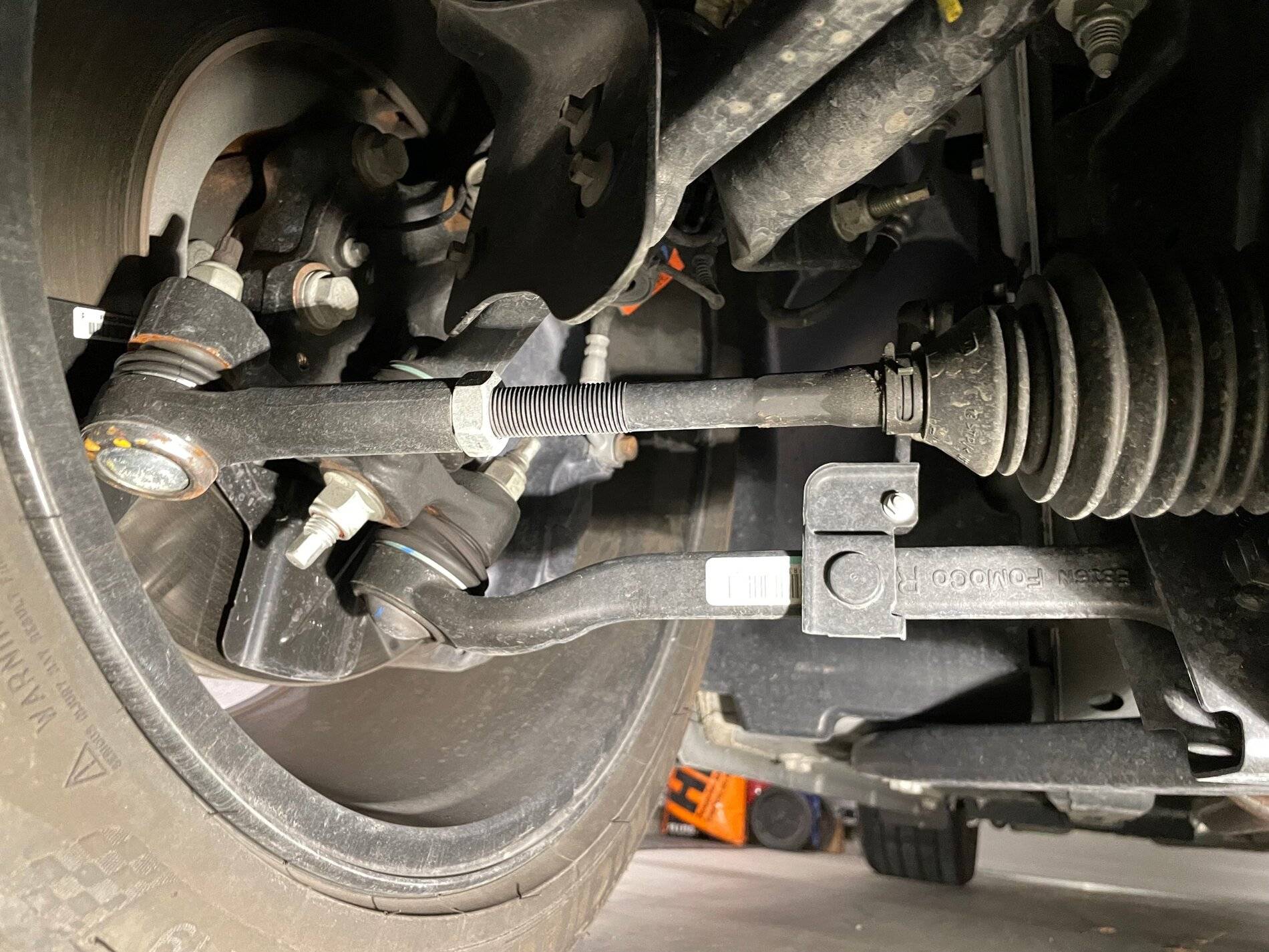

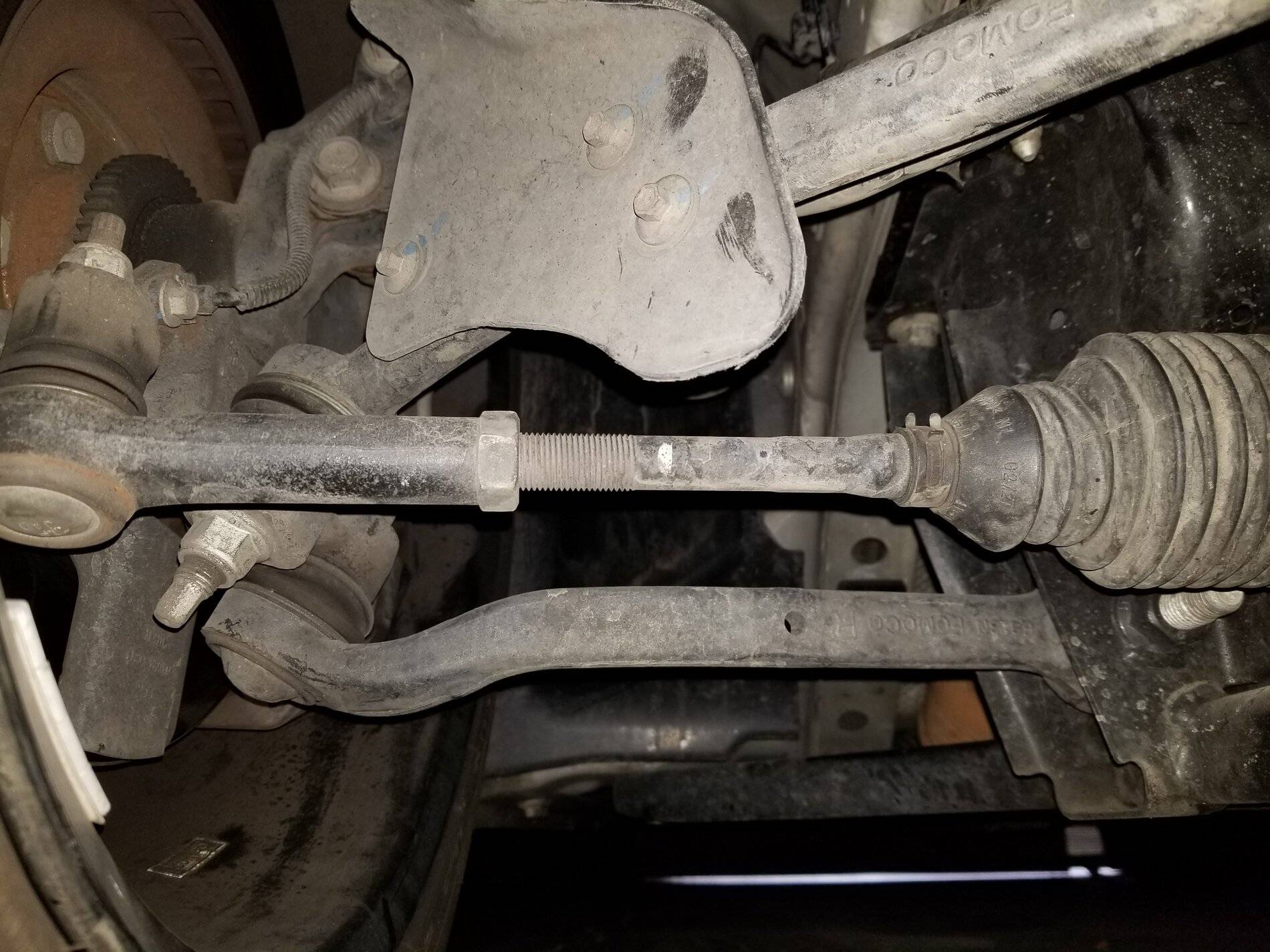

I know a shady tree body shop worked on this car before I purchased it. Found out after purchasing unfortunately so I have been fixing everything they did wrong one by one.
My passenger side wheel is tipped in at the top much more then the drivers side which I realized when I pur 25mm spacers on and one side rubbed.
I bought some camber bolts to correct it but now that im really looking at it I think the in correct parts were used on this car as replacements. Its supposed to be performance pack suspension but these arms arent the same. Looks like a brake dust shield is missing too.
2015 gt pp1
Before I put camber bolts on and get an alignment. Should I replace these arms or just be fine as is?

I'd get the right PP parts on there first, yeah. I'm not sure if the upper control arm is meaningfully different other than the mounting points for the air deflectors, but that lower control arm looks completely different too. Control arms aren't very expensive.
Do you happen to know which side is the correct one? I was thinking drivers side since its beefier. So I just replace one instead of both lol

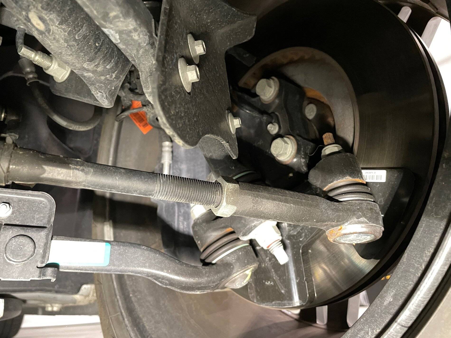

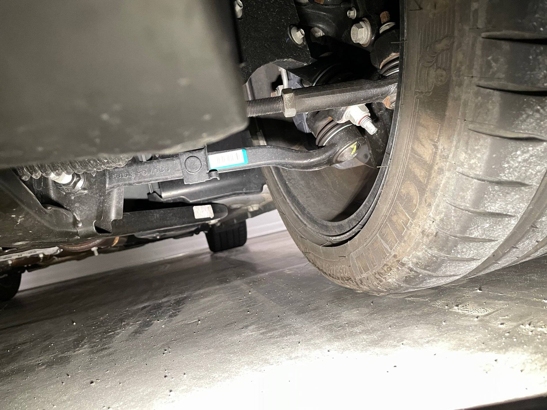

I just climbed under mine. Looks like your driver side is not correct. Here is underneath my 2019 PP1 w/magneride. Magneride adds the ride sensors to the lower control arm.
PP1 cars have a very small dust shield because of the air diverter
Driver side
Driver side
Driver side
Passenger side
This is perfect thank you for taking the time! Now to order a few parts.
