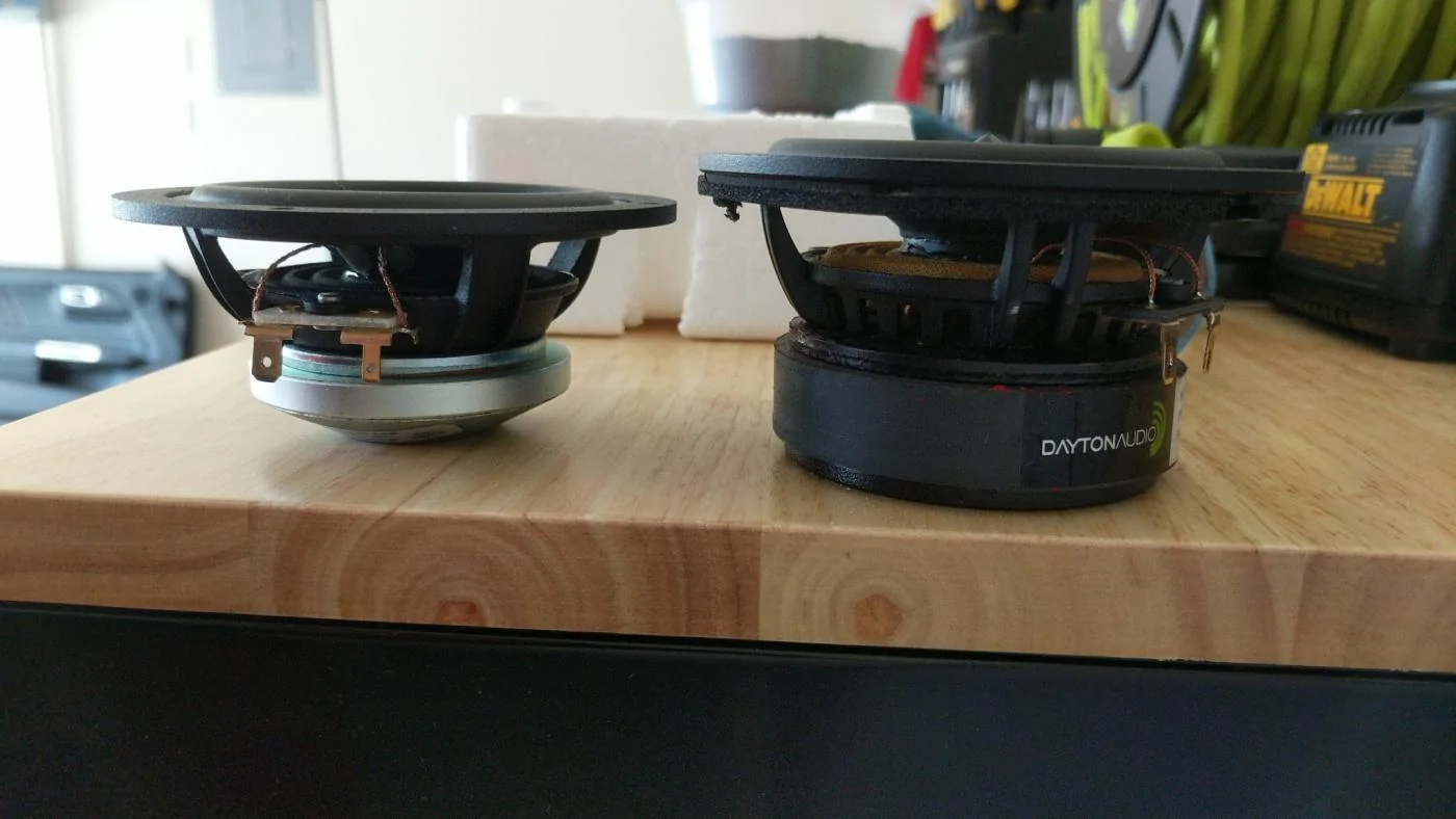

Midranges were a pain to put in, very restrictive spacing. The mounting hole is 3"...the Dayton Audio 4" midranges have 2.75" magnets. There is a metal plate behind that really restricts fitment. Spacer is definately needed including a couple layers of speaker gasket. Had to dremel out a larger opening so the speaker terminals arent touching the body. That would be very bad when the amp turns on. My skinny arms and long fingers were extremely useful to reach into the woofer mounting hole, behind the midrange, for washers and nuts. Was only able to apply 2 screws/nuts. If you do not have skinny arms..find someone who does, or use self tapping screws.

I wanted to update this thread since I upgraded the midrange speakers from what I had before. I didnt like the buzziness these daytons have. I think since they are listened too very off axis due to the location on the door the response at that angle isnt that good. I went with these Scanspeaks that cost a little more. They are neodynium so the magnet is smaller and has better fitment and their off axis response is better. They are noticeabley louder (3dB better sensitivity) and clearer. What I couldve done to make it better was grind down the spacer so the speaker would be facing the driver more, but I got lazy. I also had my friend redo the DSP tune slightly, putting the mid/tweet crossover point a little lower.
