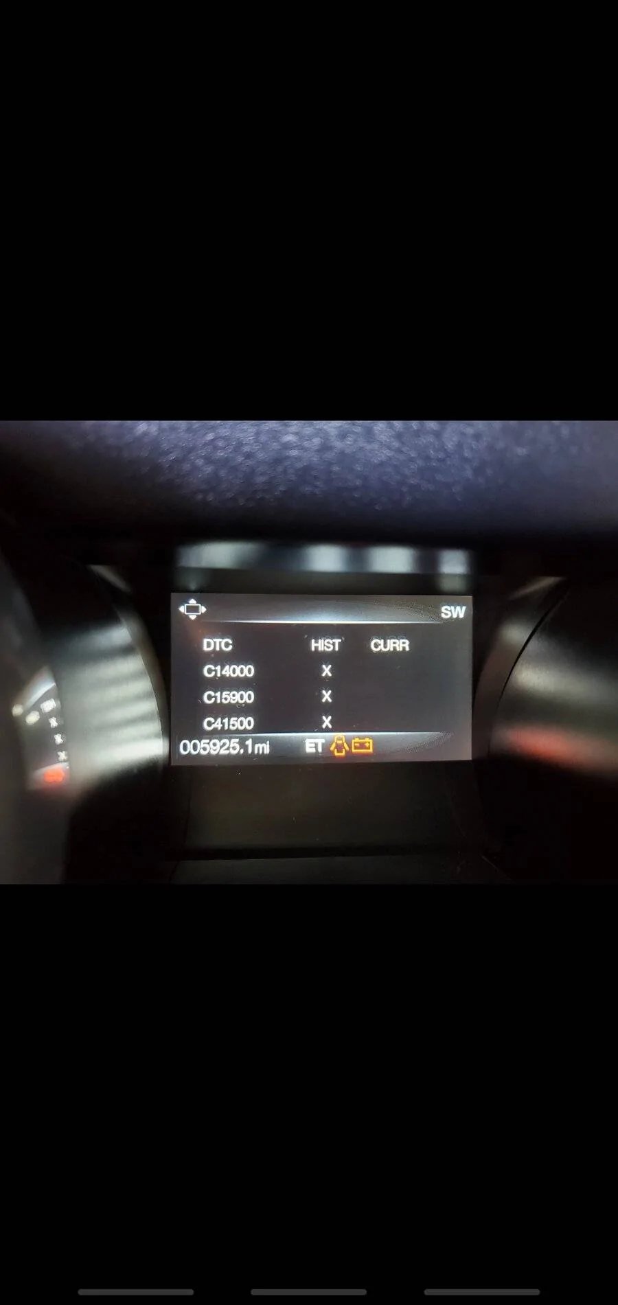

So for the digital dash, you put ignition on, dash in blank mode (which is in the double-gear menu, where trip info is), then press 'OK' button and leave it depressed, start engine, and wait until engineering mode pops up? Not very clear instructions after jumping to 2 threads.
Finally, can you read soft codes there, or just hard ones? Curious about that. Thx.

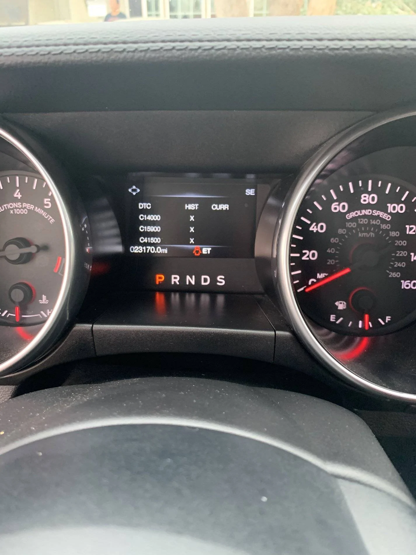

I don’t have a digital dash in my 2018; was passing along the info (because DTC’s always come up on this site) and prob would be best to respond in one of those threads to get better answers, as I don’t want to give you the wrong info.
As far as I what codes in the Engineering Mode (both cluster types) when originally discovered quite a while ago, it seemed the discussion was that what is displayed is all the codes whether they were hard or soft codes.
brianbr
Apr 12, 2020

2019 Magnetic GT PP
