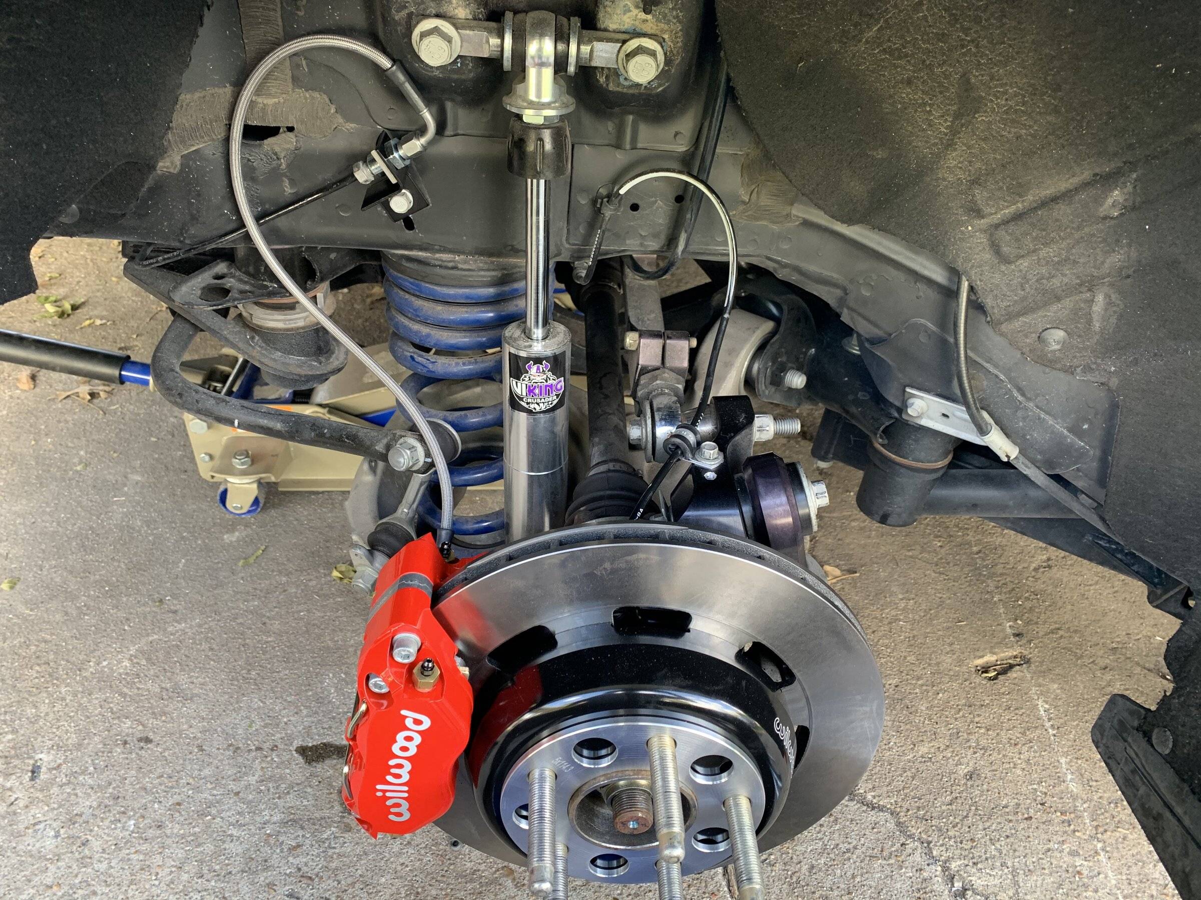

I run 315/60R15's in the rear and they're damn near 30", but if you run coilovers up front you can probably fit a taller tire up front too.

Oh for sure. I run a fixed rear height and it's not anywhere near the end of travel. My comment was just you can definitely run a taller tire than 28.3"

True enough. I'm running 305/30ZR-20 in the rear and they are 27.2" tall compared to your 29.9". Definitely could fit taller, but then you have to start considering the clearance issue you mentioned, some of which can be mitigated with the correct wheel offsets, replacing the OEM upper shock mounts for one of the BMR or Steeda replacements, and alignment camber adjustments to get more clearance. And of course if you are going for the flush look, this is more critical, whereas if you like "poke", then the main thing is to ensure the clearance between the top of the tire and bottom of fender have enough clearance for max suspension compression so they don't touch.

For sure. I have a fortune in my rear suspension to be able to run that setup. Just the billet knuckles are over $2K alone.
