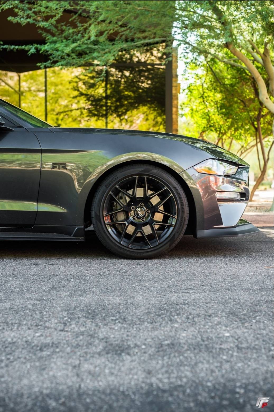

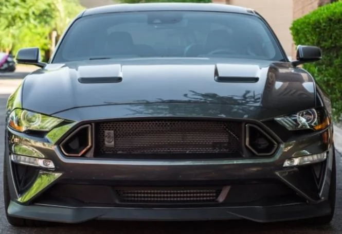

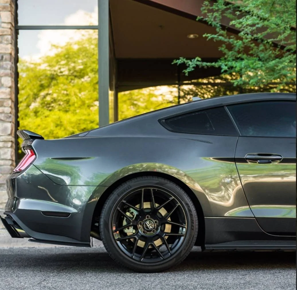

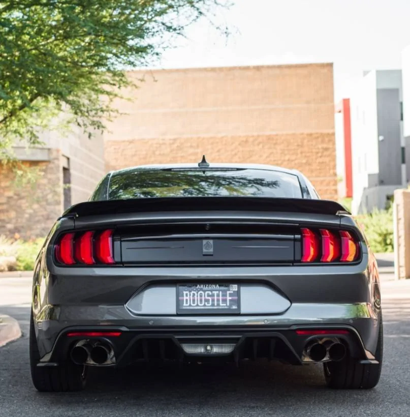

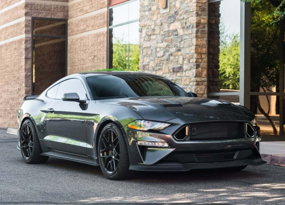

I picked up a Fully loaded 2020 HPP in Jan of this year and have really enjoyed modding it out. Here is my list.
RTR Tech7's 19x9.5 +33 offset
RTR Rear diffuser
RTR rear splitters
RTR Side splitters
RTR Hood Vents/Hood stripe delete
RTR upper/lower grille with LED's
RTR Fender badges
RTR Floor mats/trunk mat
Anchor Room RTR FP dash plate
OEM GT350 Trac Pack spoiler
FP Magneride lowering springs
FP Hood struts
Steeda IRS alignment kit
Steeda IRS subframe braces
Steeda billet hood release lever
NGK tune+ sparkplugs
CVF street IC/May upgrade later
CVF H/C charge pipes
CVF Catted DP/Stock Active Exhaust
Turbosmart electronic BOV
Airaid Tube with AEM dry filter
NX2 Turbo
91/e30 tuned by PD TUNING
The car feels great and is a blast to drive, I'm in AZ and this is my DD.
