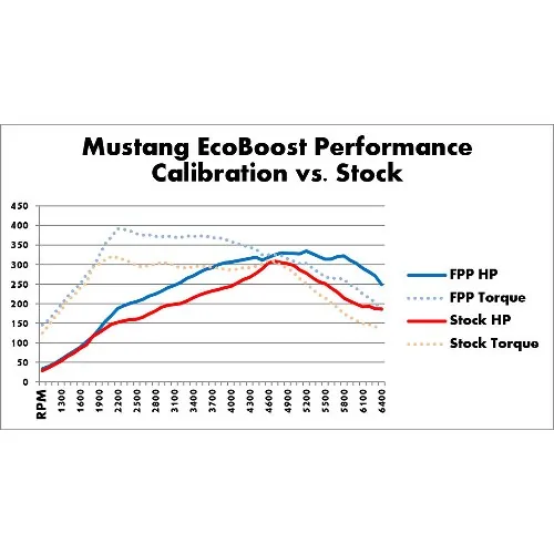

Heres the ford perf dyno for 15-17

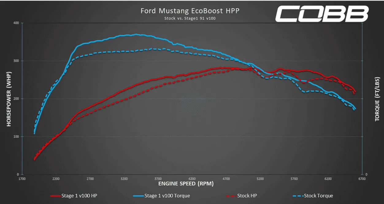

here's the stage 1 for the HPP from Cobb. it shows base dyno/vs their stage 1. but for purpose of discussion, compare the FP numbers, vs the stage 1 stock numbers on HPP that Cobb dynod. I read their comments and other comments showing the FP had more power.

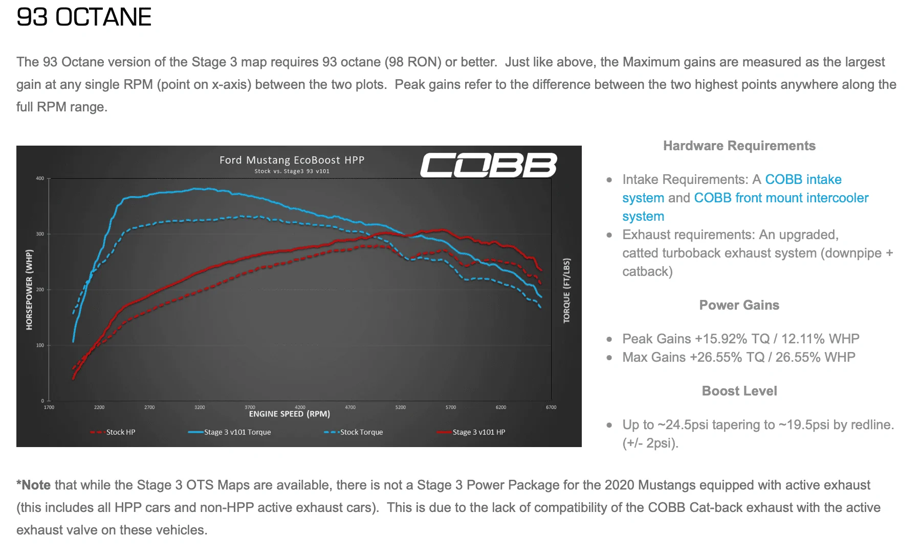

but wait. I will post stage 1/2/3 Cobb for regular EB, and stage 3 for HPP from Cobb. (these are basically full bolt on comparison of both ecoboost.

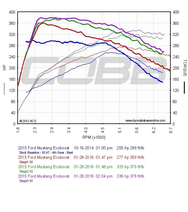

regular EB stage 1/2/3 Cobb numbers, each stage 1 2 3 is diff. 1 is regular with drop in air filter, 2 is intercooler and drop in filter, and 3 is downpipe+exhaust+filter+IC
Reg eb

when both are full bolted on, and Cobb tuned with the proper stuff, the HPP clearly shows more torque carried I feel at glancing at charts. but stock HPP tune vs FP regular tune, I feel like FP shows higher numbers.
but I think they are close really. its same engine, just 3mm larger turbo in the end.
