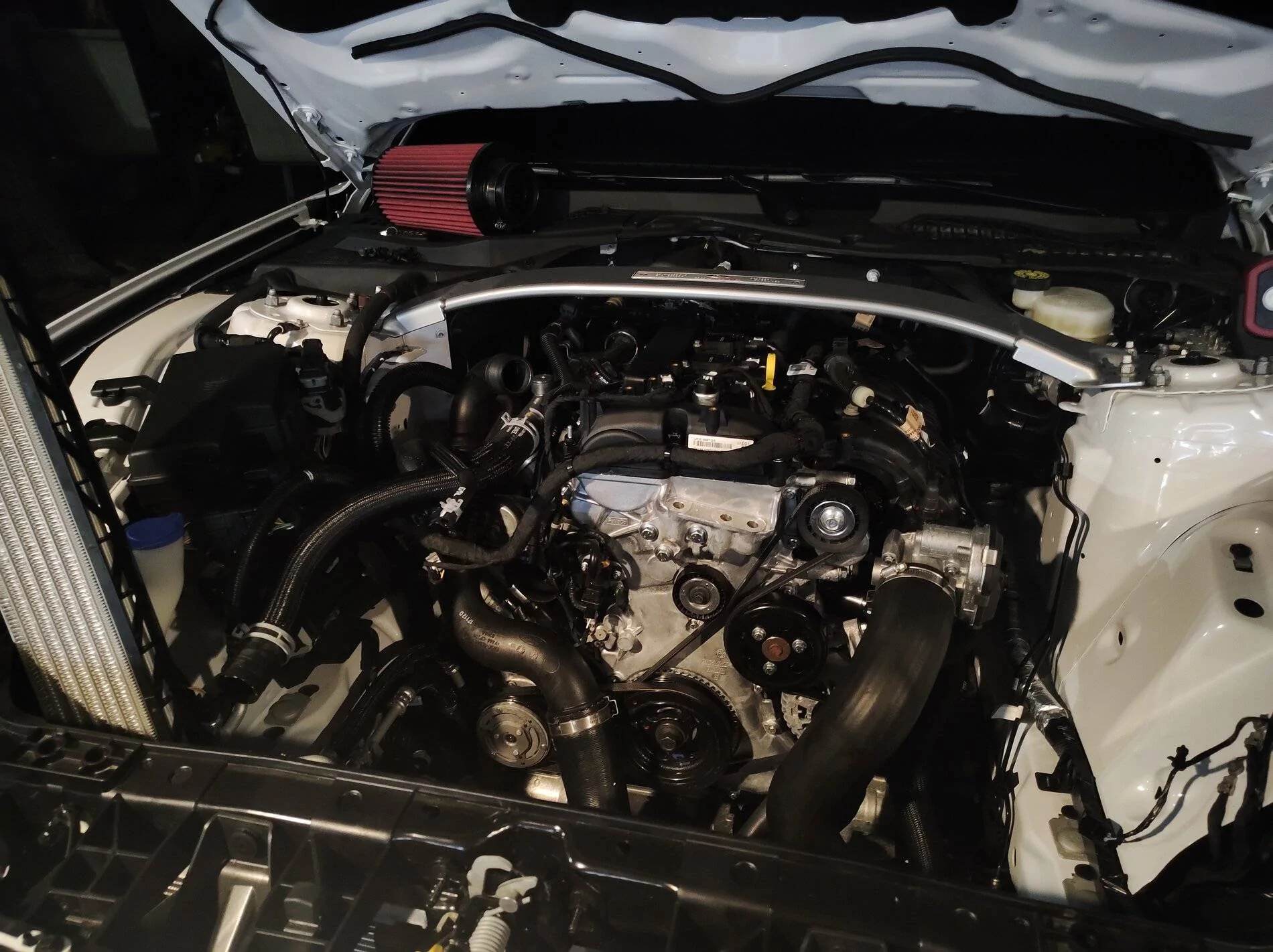

well to be fair, OEM intake + drop in filter does equal to SB. so ignore the intake. its all looks.
This is what I DID.
full steeda suspension, included sway bars. 1500
cjpp strut bar 150
drop in filter - 50 kn filter
Roush Y pipe- 215 at Levittown ford perf

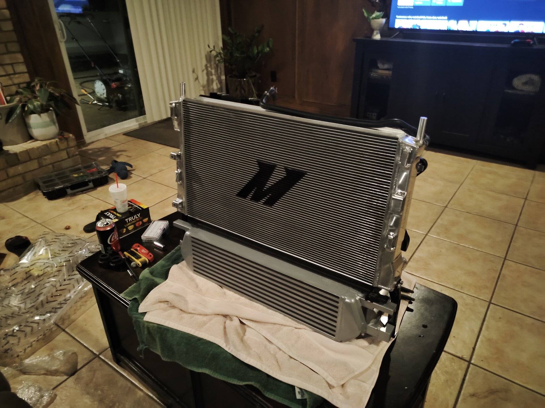

mishimoto radiator- 450 (asked mishimoto for 10% off and they obliged)
CPE street intercooler- 270 shipped during Black Friday 2 years ago
downpipe is optional, thats if you want to go protune/cobb stage 3 which isn't offered anymore. - if you do downpipe, you are needing a new tune, FP and HPP both won't play well. trust me, I did the DP with FP and it worked alright, but it ran better with the downpipe. since Cobb doesnt offer stage 3 anymore you'd need to get the stage 3 file off someone, or get pro tuned.
I didn't mess with rear links. cant see a point in benefit for them with my suspension
in the end, you'd better off getting a regular EB premium and pro tuning, you'd have a lot better car for 5k spent vs hpp package.
I only say this, because I did exactly what I wrote.
https://www.mustang6g.com/forums/threads/2017-mustang-ecoboost-build-log.160535/
but. IF I found a screaming deal for a HPP on sale, id just honestly slap a intercooler in it, and enjoy it for what it was. should be extremely reliable/enjoyable/nice daily.
I have access to the stage 3 files from Cobb. You can ask them to send them to you, they just don't advertise them anymore because the supporting downpipe Mod was not Carb certified. I agree, the downpipe can rob power until the proper tune is completed.
