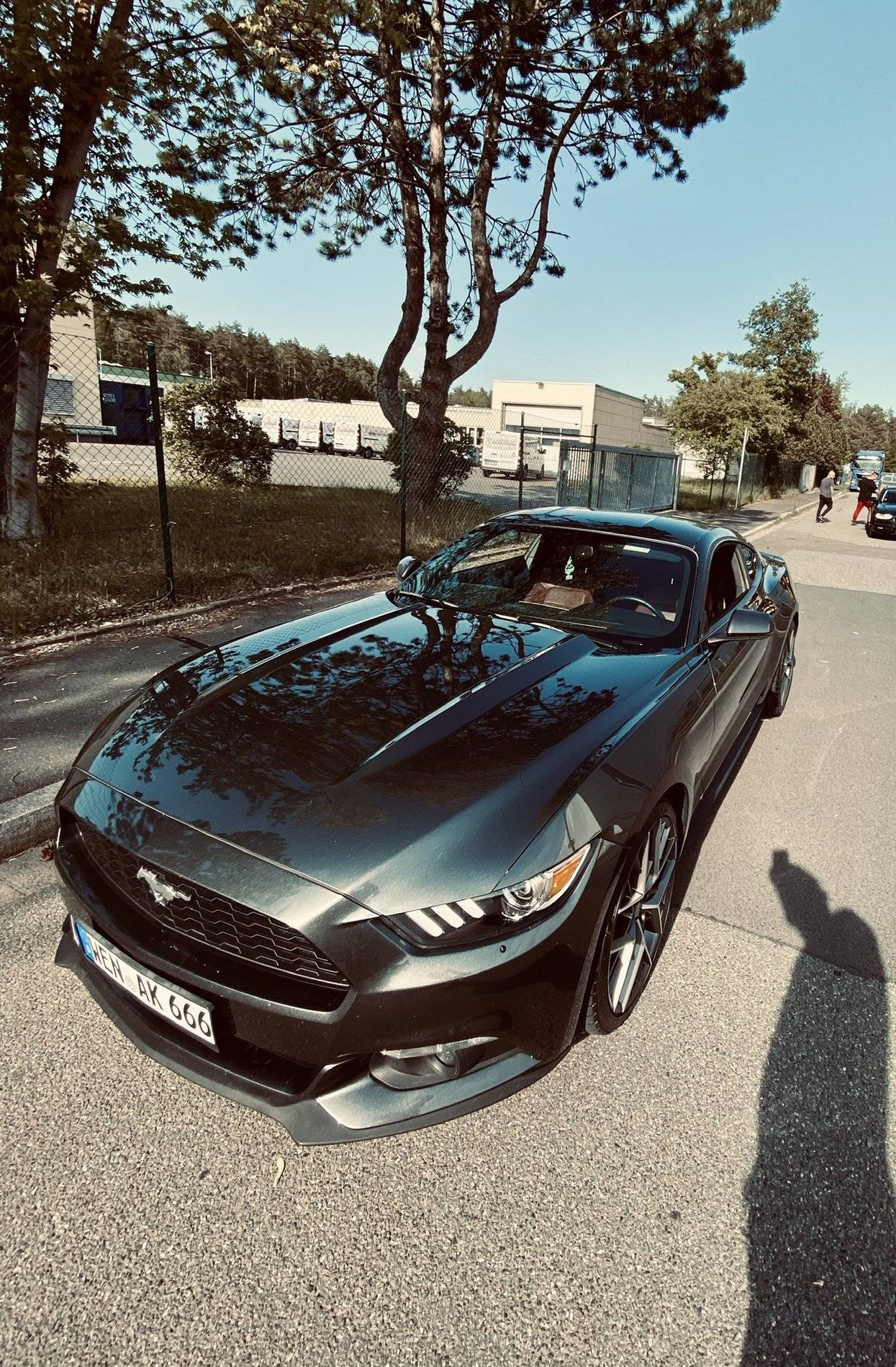

Hi everybody,
For more than one year I’m owner of a Mustang S550, and I’m based right now in Germany.
I’m looking forward to install a full exhaust with valves, CAI ( roush ) and a tune. My question is now, is it worth to buy the intercooler now too, when I do all these modifications ? Is it worth another 500€ or 700€ with the pipes ?
Also what do u think about the pop and bang map ? Is it really bad for turbo ?
I already changed an engine on it, because the first one blown up due to a bad ecu tune I suppose.. unfortunately.
Also, what other modifications are mandatory for it ? Or what else should I do to it ?
I don’t have the performance pack on it, it’s the premium pack. So my brakes are pretty small, and I kinda wanna upgrade them, but the kits are really expensive, over 1.500€.

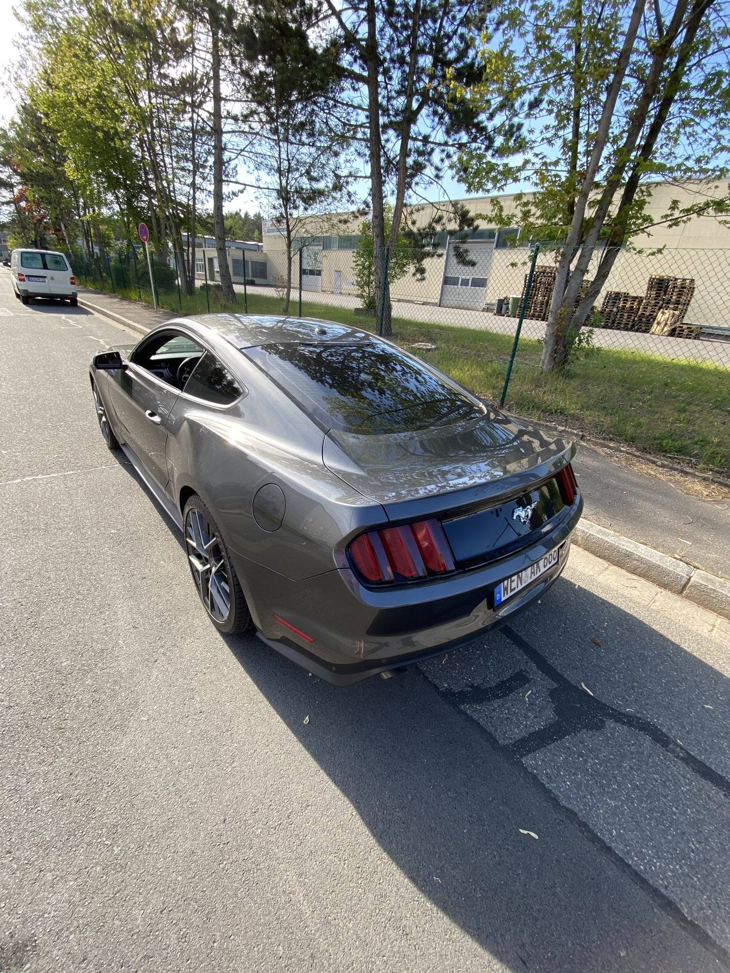

Also, my car it’s imported from US, so US model. I have the red tail lights but they’re not sequential, and I have no idea why. Maybe they got turned off from ecu or mechanical ? Idk..
I have so many other questions for you.. .
