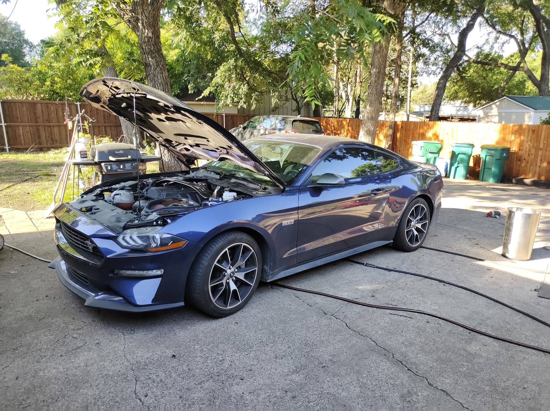

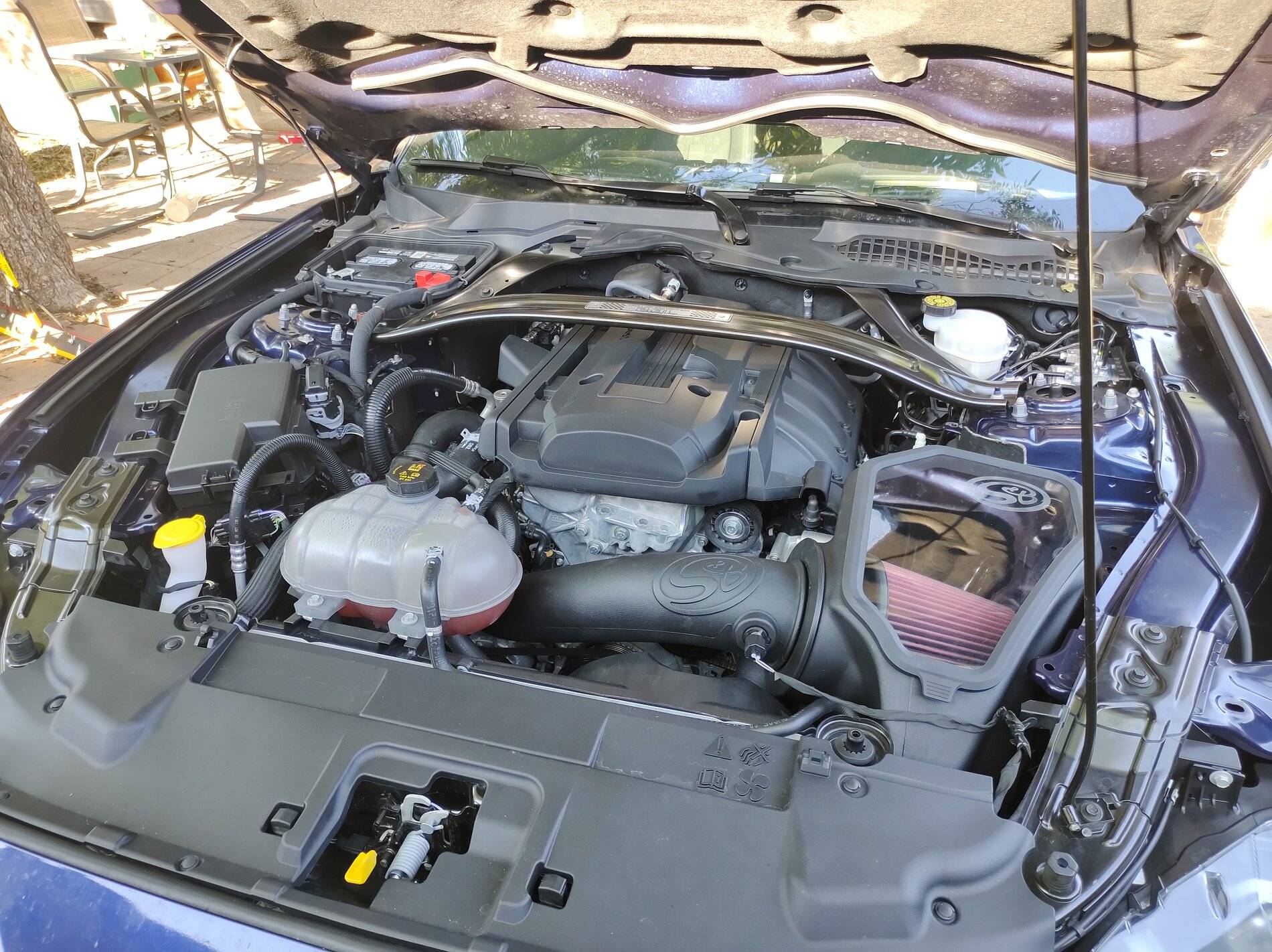

Here are some pics, as you see, other than the intake, it looks fairly stock which was a goal of mine. It needs a wash bad lol
