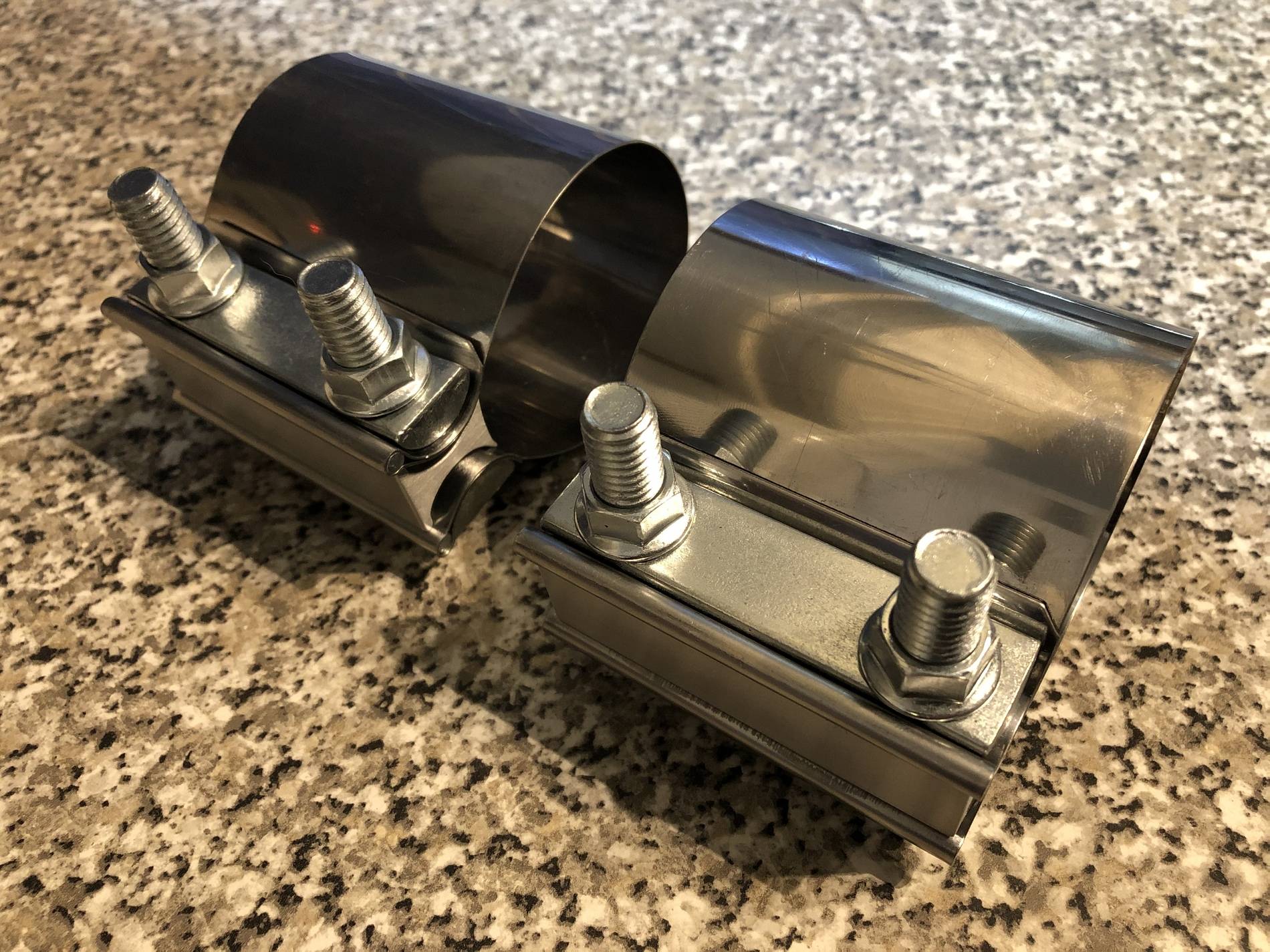

Is it the internal sleeves that make the difference ? Other than the sleeve, they look very similar to the clamps that came with my steeda H :
WD :like:
The inner sleeve is of a similar gauge to the Steeda clamps and reinforced clamping force comes from the outer sleeve. I torqued them to 50#'s and they have held to tips perfectly for 3 months now.
