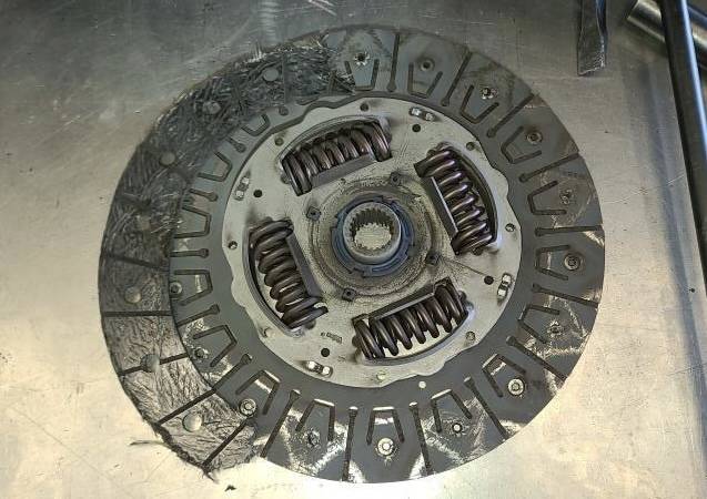

Mine is in a similar state with a whole new clutch assembly. I might’ve mentioned it here or in another thread. There’s a lot of repeat threads.
The friction disk decided to leave the chat room…

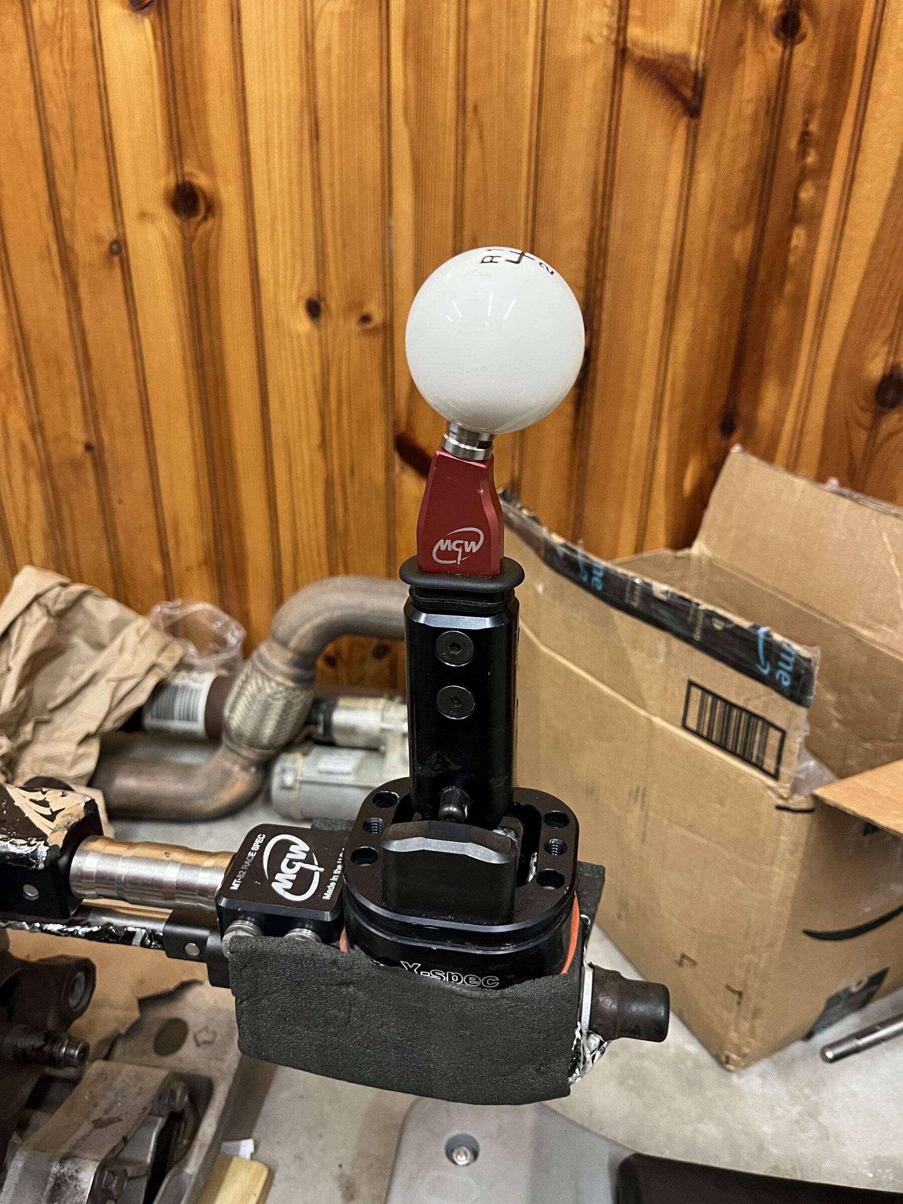

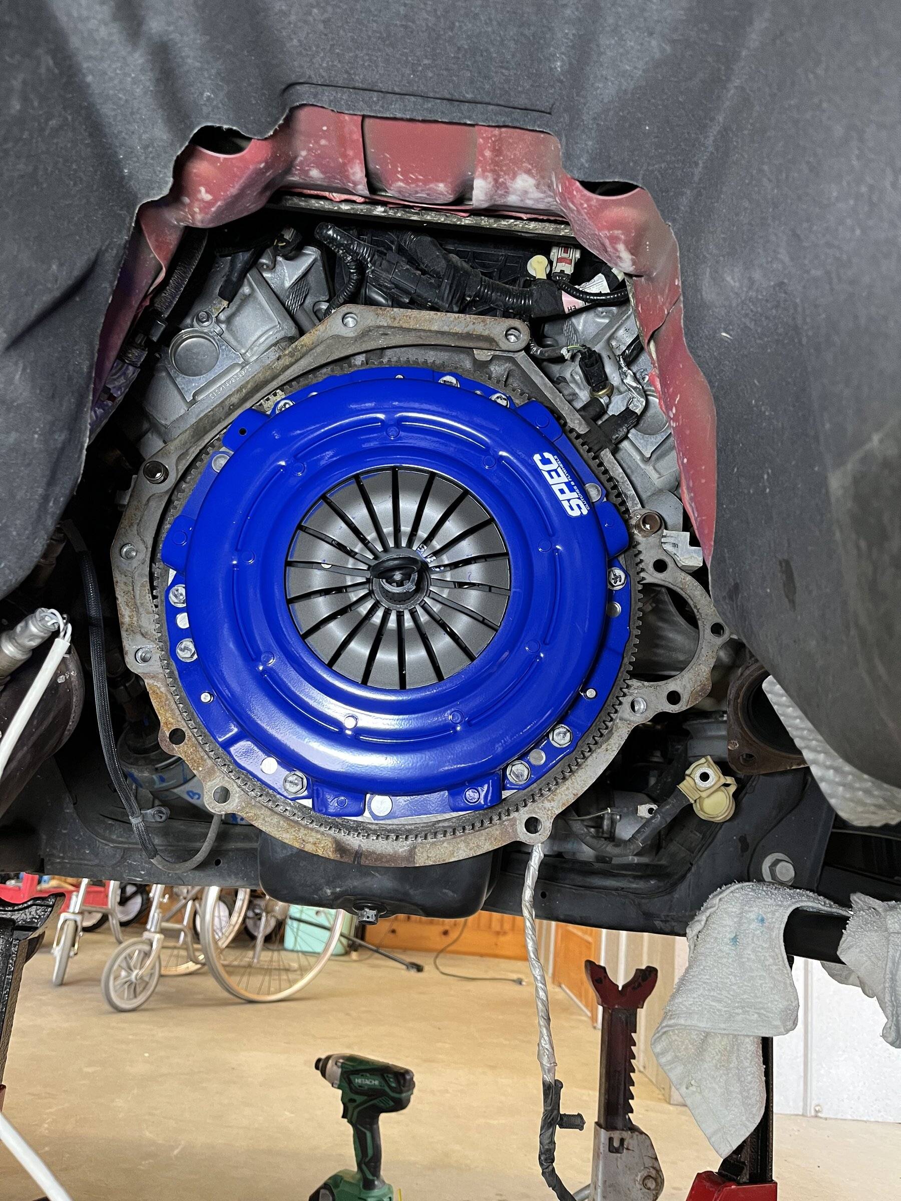

I got the new clutch in and installed the shifter and yesterday I got the transmission back in. Also installed the new clutch fluid line. I’m at work today but tomorrow I’m going to try and finish up the exhaust and driveshaft and get her back on the ground and started up.
