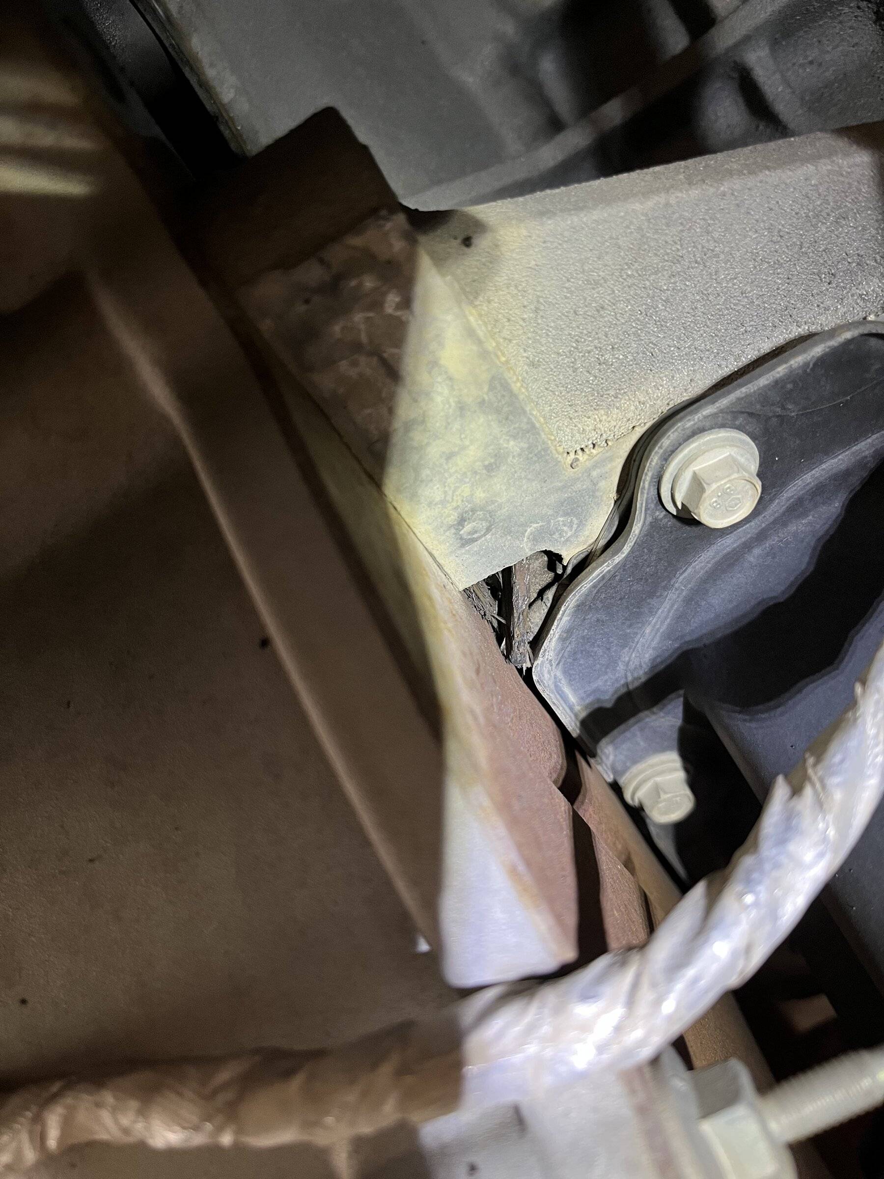

Took the starter off yesterday and while I was down there took this picture. That’s my clutch material in pieces in the hole in the middle of the picture. When I get the trans out I’ll take more.

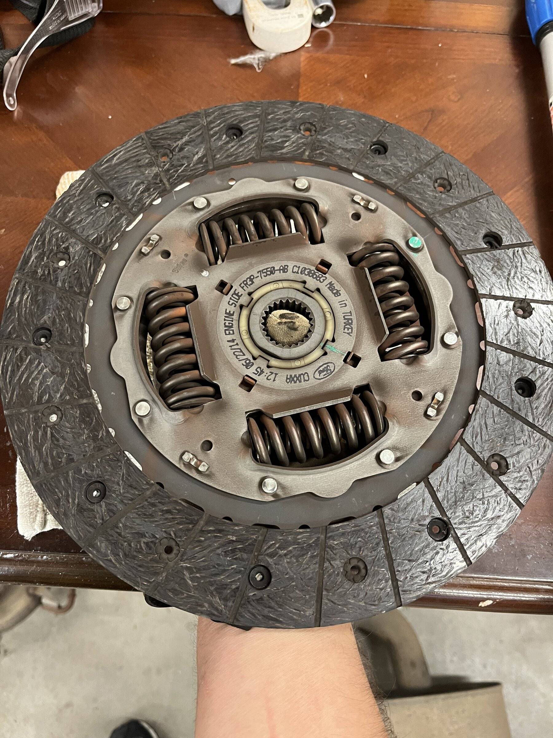

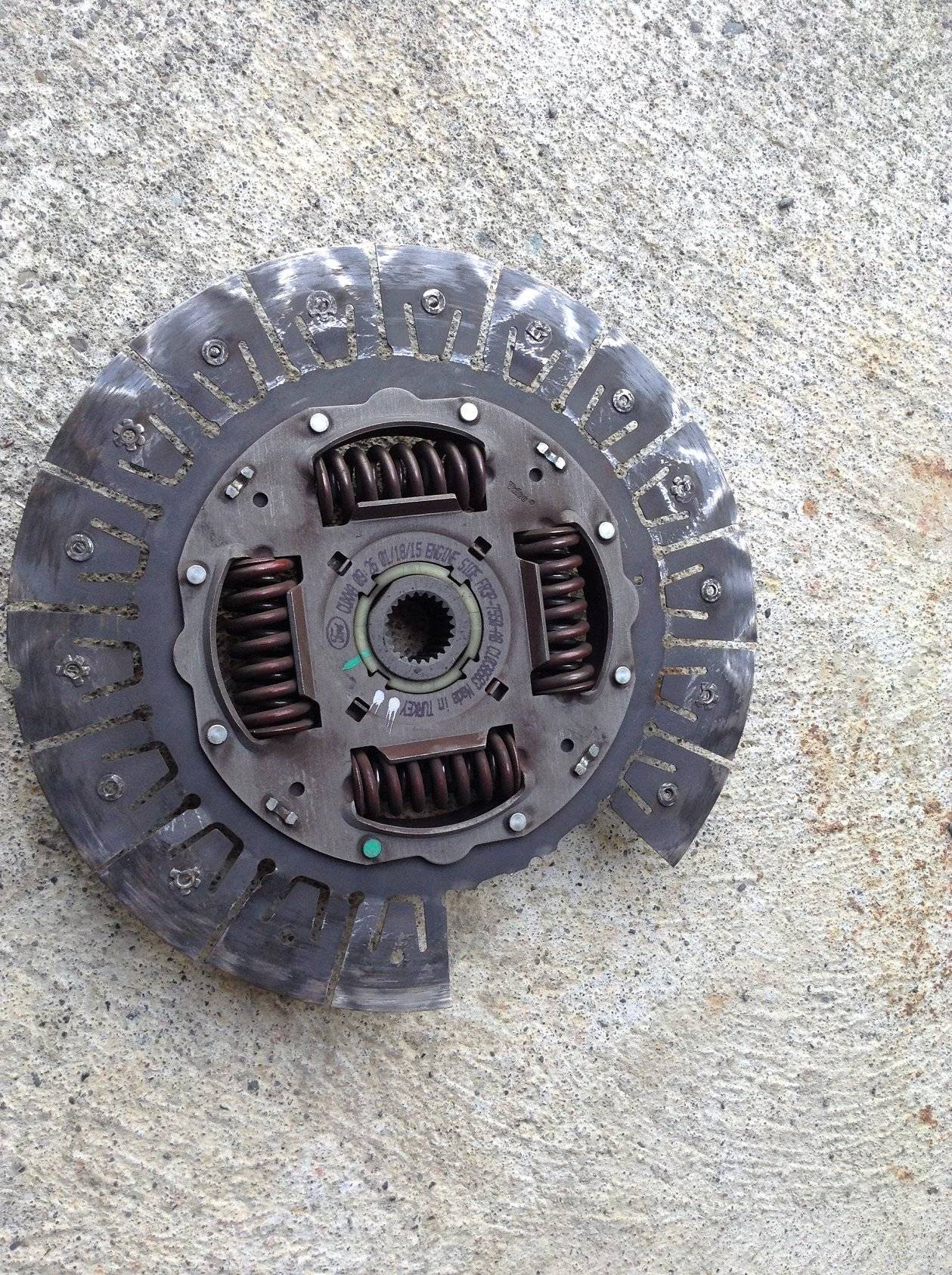

Make sure you post a pic of your clutch when it comes out, I am sure that is the issue. Mine was blown to shit after a 7200 rpm shift and limp back to the pits.
What was that out of? Stock disk "Made in Turkey" That is nukin futs........... Pisses me off. Come on Ford..........

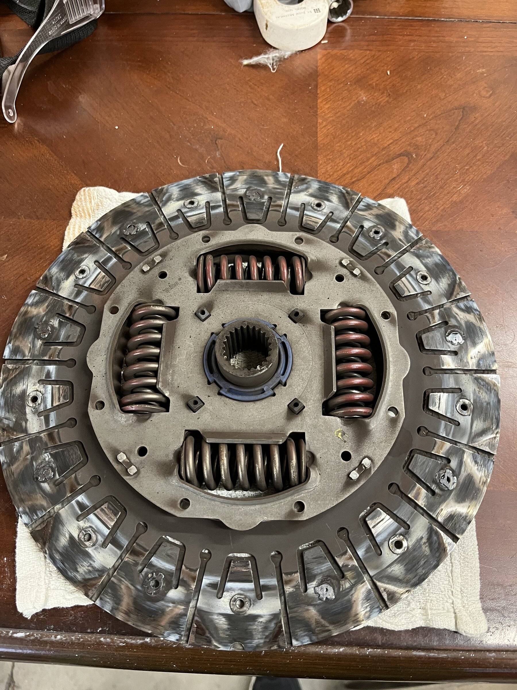

Well I got the transmission out today. As I said here are pictures.
