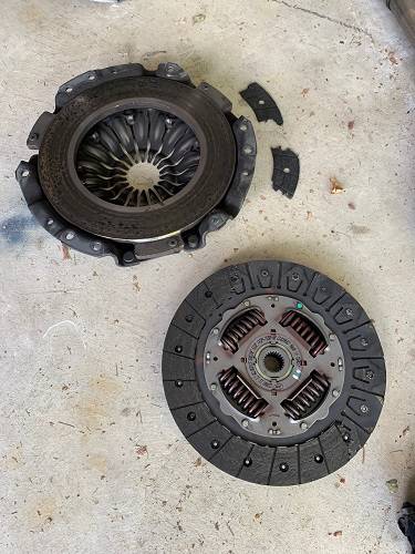

Sounds like the cylinder same thing happened to mine not to long ago. Car would go in gear only when its off. Replaced everything clutch - RXT, slave cylinder, braided line, and some other stuff.
CatalleyaS550
Aug 7, 2021
Maryland
Carl
2017 Mustang GT
Adding on to what I said earlier this what the shop found lol. I guessI needed a clutch. Again I changed the slave cylinder, pilot bearing, installed braided clutch line, and rxtto prepare for boost later down the line.

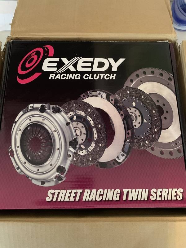

High RPM shift never ends well on a stock clutch.
MyStang
Dec 30, 2015
50
592
929
Michigan
2015 GT
Trans was fine, pride was hurt more because I know better.
This was my choice and couldn't be happier.
