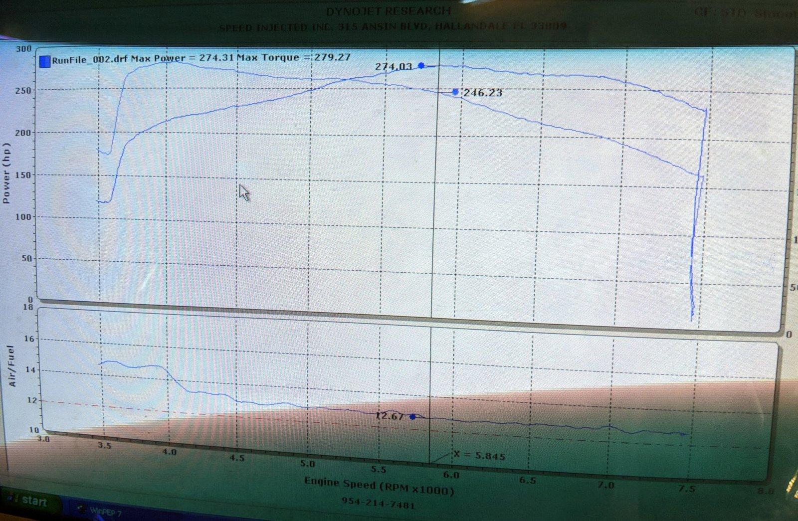

Either my false knock is robbing a ton of power (I'd guess it might have peaked around +5 or 6 degrees based on other driving) or MPT sucks now. With ported intakes, ported throttle body, Roush CAI, shorty headers, x-pipe, and axlebacks...I got 274.31/279.27 today with a DA of about 1300 (PBIR shows 1285 and Homestead shows 1444 right now, this place was between the two).
First run was 269.06/270.48 with AdvanceTrac off then I pulled fuse 62 for the following runs.
I don't have any previous dynos to compare to, but I was definitely thinking I would hit the 300 mark.
cyclonetron

Does seem low with the mods you have.

Ya man those are not good numbers with your mods.....something is off. I see close to 300 with your mods minus the ported intakes.
