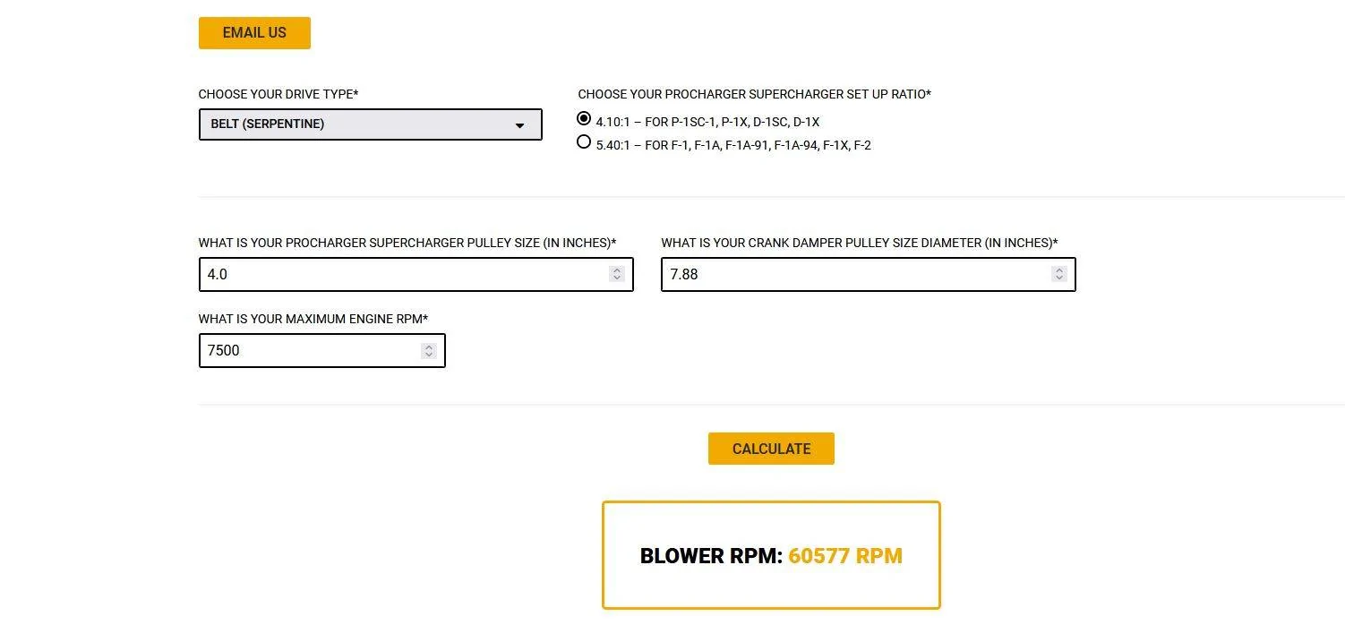

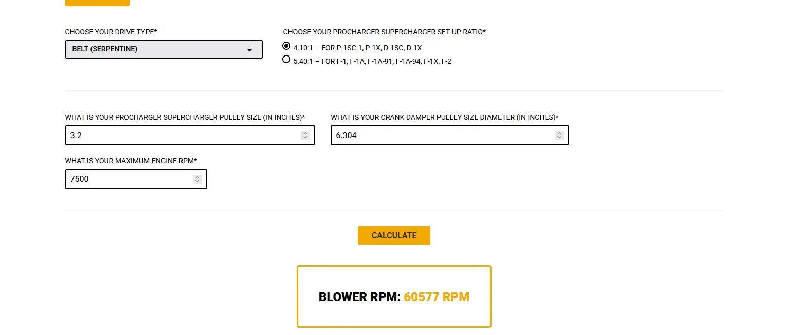

I actually did some simple math
6.5 + 20% = 1.7 which is 7.8 not 7.88 Significant digits mean something here
closest thing would be 6.566~/6.57~ " stock lower
More interestingly if we go BACKWARDS
7.88"-20%= 6.304"
then look at what happens....
numbers and ratios, same RPM with a 20% smaller crank balancer than the 7.88
it obviously doesn't work out the same the other way but it's within 3% of the blower rpm as I previously stated.

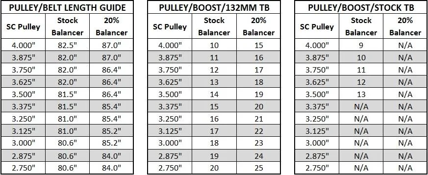

From whipples website. I know its centri but it makes a big difference on a whipple
