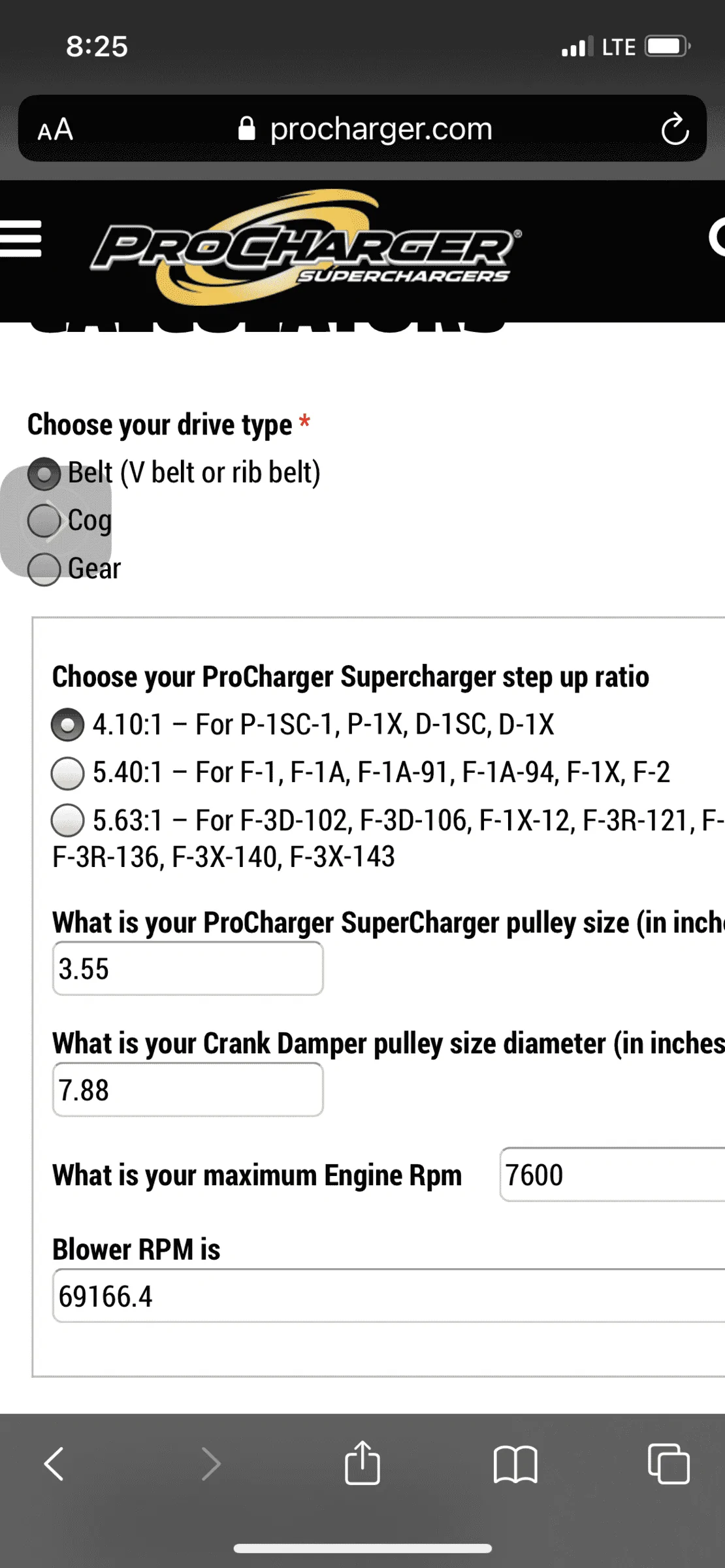

Just installed a 20% overdrive harmonic balancer from innovators west. How much more boost if any she I see with the larger lower?

No. This is on a procharger p1x that as of now is making 17lbs on a 3.55. I was just curious where I was going to be be boost wise ecause I believe I will be running out of injector with the fic 1000's.
