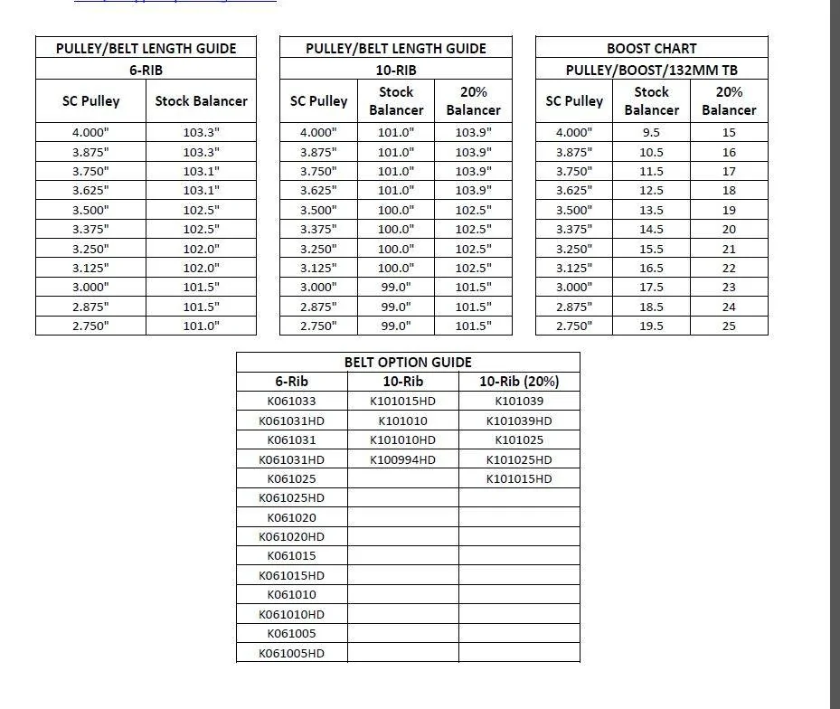

it's not wrong, when it comes to a PD. Also because the restriction is lessened with a bigger TB which most of PD guys have when we do these kinds of things, it's not always apples to apples.
in the case of whipple what I said above is true... per whipples own chart:

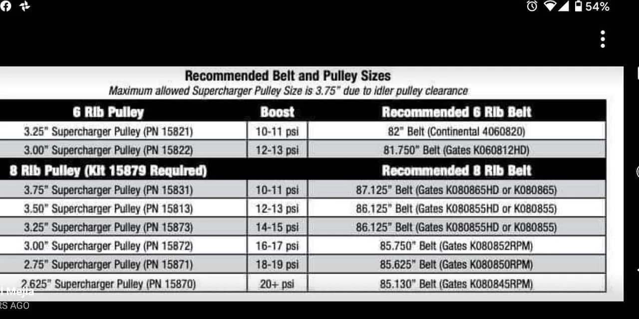

in the case of the edelbrock with a 15 % lower, it's not exact but they give you a range instead of an exact number. could be lower or higher due to being able to run a different TB or whatever.
EB 3.75 - 15% = 3.1875 which is pretty close to the 3.25
whipple 15 PSI with the 20 lower, 4"-20% = 3.2"
whipple 15.5 PSI with the stock lower 3.250" again not exact but pretty close.

it's likely true because the boost is linear on a centri I suspect. But I don't know. I would assume that you would spin it faster, quicker getting to a certain number earlier in the rpm range, how much earlier is up for debate. I know there are lot of other factors in it with the centri but in a perfect world my guess it that it would still make a target number quicker than with a stock lower.
notice on both charts how you get 4-5 psi more boost with the same pulley but the bigger lower.

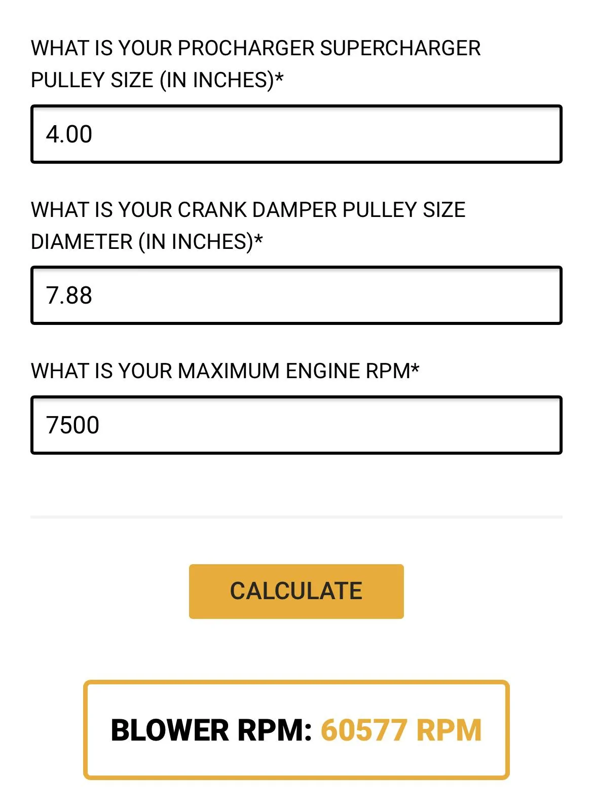

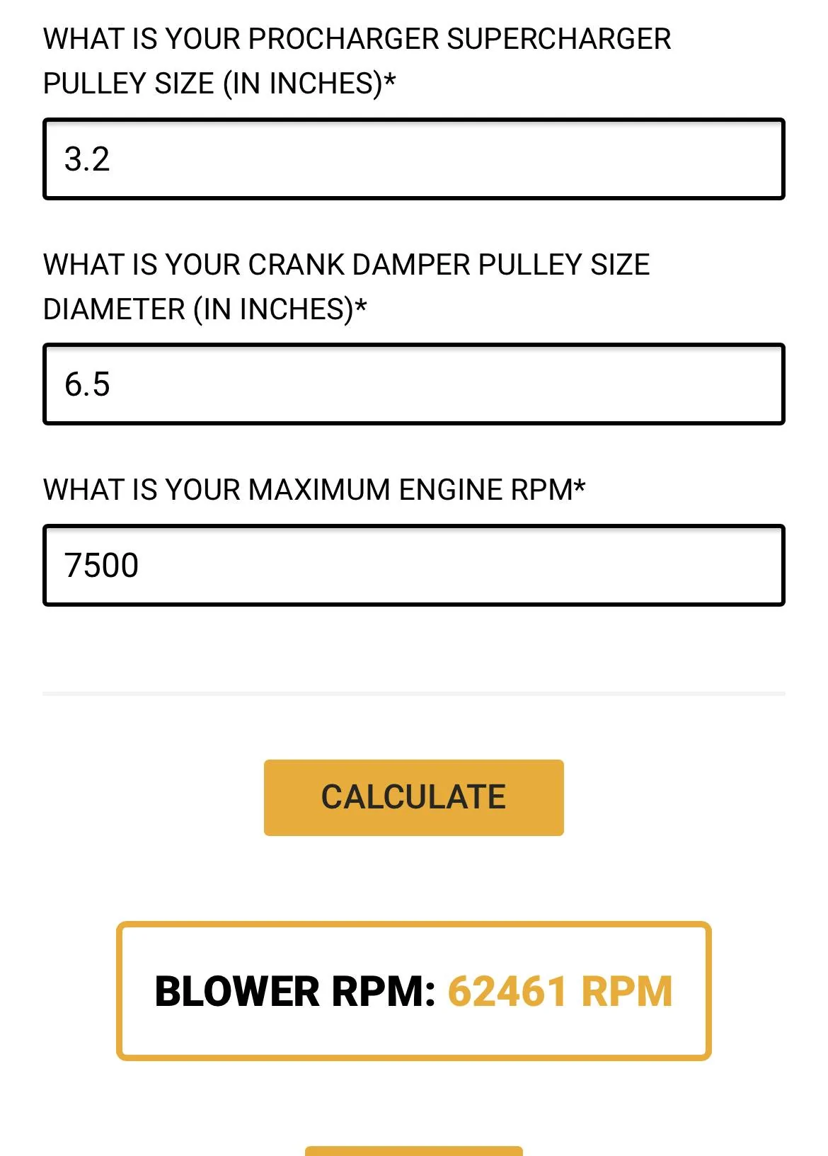

It’s not true. No matter what supercharger you have more blower rpm is more blower rpm. Yes a PD is linear but that just means that you get to your boost all at once. The rpm of the blower determines how much boost you make.
if you have a 4.00 upper and a 20% lower you will not have the same rpm as a 3.20 upper and a stock lower. It’s basic math. So if you have less rpm then you have less boost. I can’t believe I even have to point this out. Come on just admit when you’re wrong. You will get more respect

A 20% od balancer = 7.88”

I don't have a problem with being wrong, but H ow do you explain more boost then on both the Whipple and the 2650 boost charts with the same upper but overdrive lower that is more than 1.5 and 2 lbs of boost just because a PD is instant in terms of boost, doesn't take away the fact that you are overdriving all the accessories on the belt drive IF you leave them all the same size.
youre telling me both Whipple and Edelbrock has it wrong?
