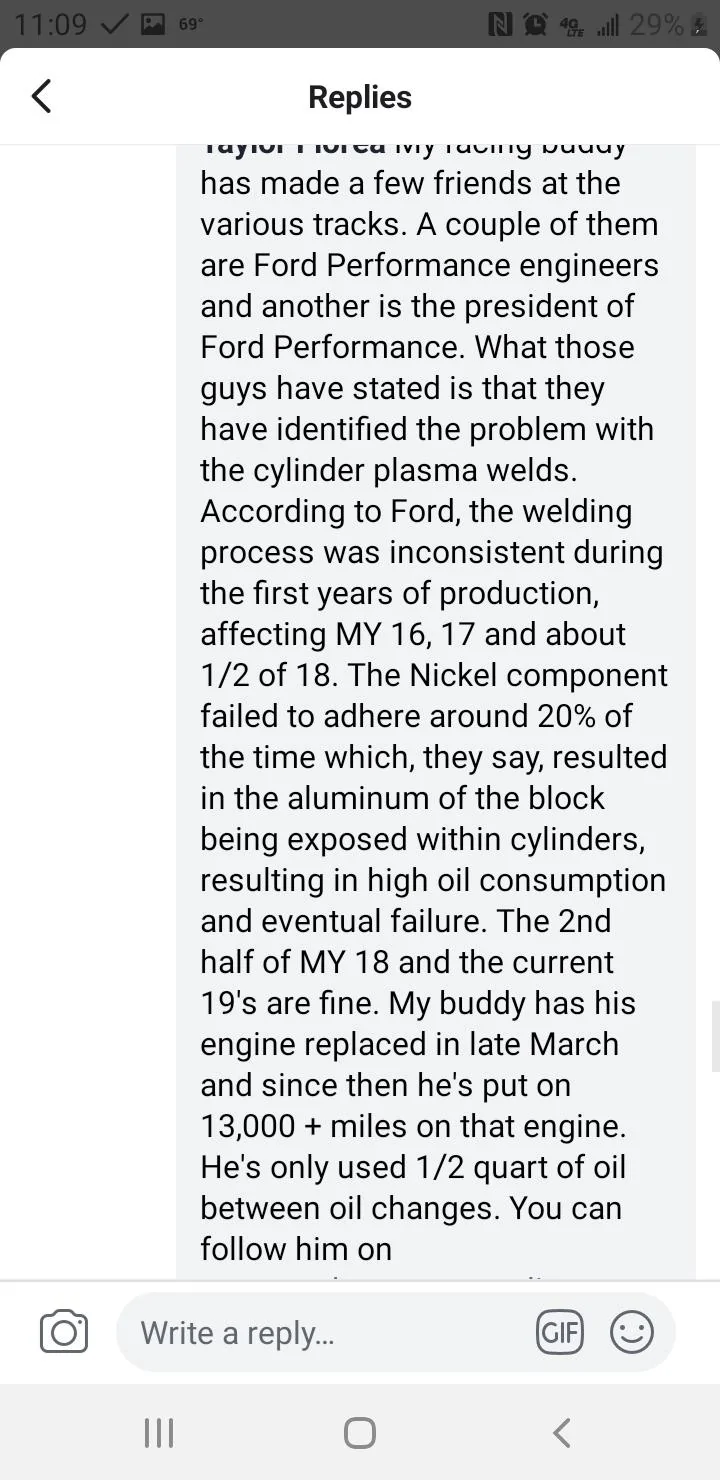

Never believed that 1qt per 500 is normal. Like manual says 1qt per 500 is normal but for high performance, high rev, engine braking - driving style. And i can see 1qt burned in 500 track miles. But not commuting to work. Now way. Especially when some cars burn no oil and then they start burning oil afte 2-3k miles or more.something is wearing out faster then it should.
Found this on gt350 facebook page, some guy commented about oil consumption....interesting. i dont know if its true, bit at least promotes my thinking . what you guys think?
Wow !! This interesting and actually makes sense. Does anyone know if this is a reasonable explanation why these Voodoo's are failing so inconsistently ?
