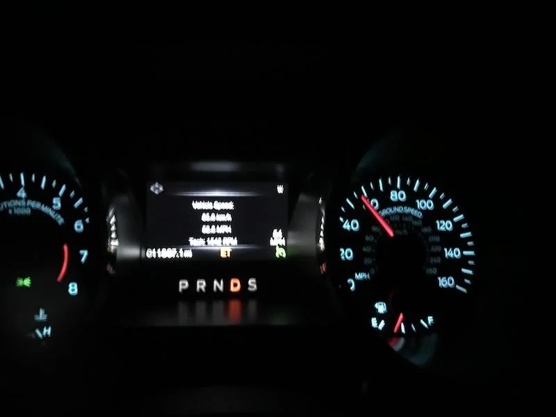

Here's the kicker though...you can enable cruise control while in engineering mode. So, sorry for the terribly blurry pic, but the digital speedometer was reading 52.8MPH, cruise showed it was set at 54MPH, speedometer was showing 55 or very very slightly past (even though the angle of the photo makes it look like it was around 57, it was not).
With that said, now i'm curious if the engineering mode speed ever changes with calibration, and maybe it's possible that changing the as-built value is only calibrating the analog speedometer. Guess i'll have to do some playing this weekend again :)

Maybe that engineering test mode relies on the wheels sensors for data, whereas the speedo relies on the transmission speed sensor? :shrug:
The analog speedometer is pretty precise if you're careful, which is why I suggested using it and trying to place the needle dead-center on a hash mark.
I honestly think that the cruise control uses whatever internally unrounded MPH you happen to be going at the instant you set the cruise. So if you set it for 75mph, internally that could be anywhere from 74.5mph to 75.4mph. And then it's rounded for display as the cruise setting in MPH.
