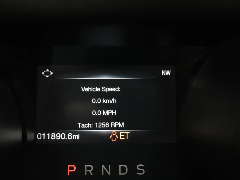

If you want accuracy down to the tenth on the speedometer, you can enable a digital speedo in engineering mode.
Press and hold the ok button on the steering wheel as you are starting the car until you see ET at the bottom of the display, then release the ok button. You can scroll through the menus using up and down until you get to the screen with the speedometer in both MPH and km/h.
I turned that on once for shits and grins. I remember someone saying once that the MPH output wasn't quite right. Does it match up to what the needle indicates? And can you use cruise control while it's enabled?
