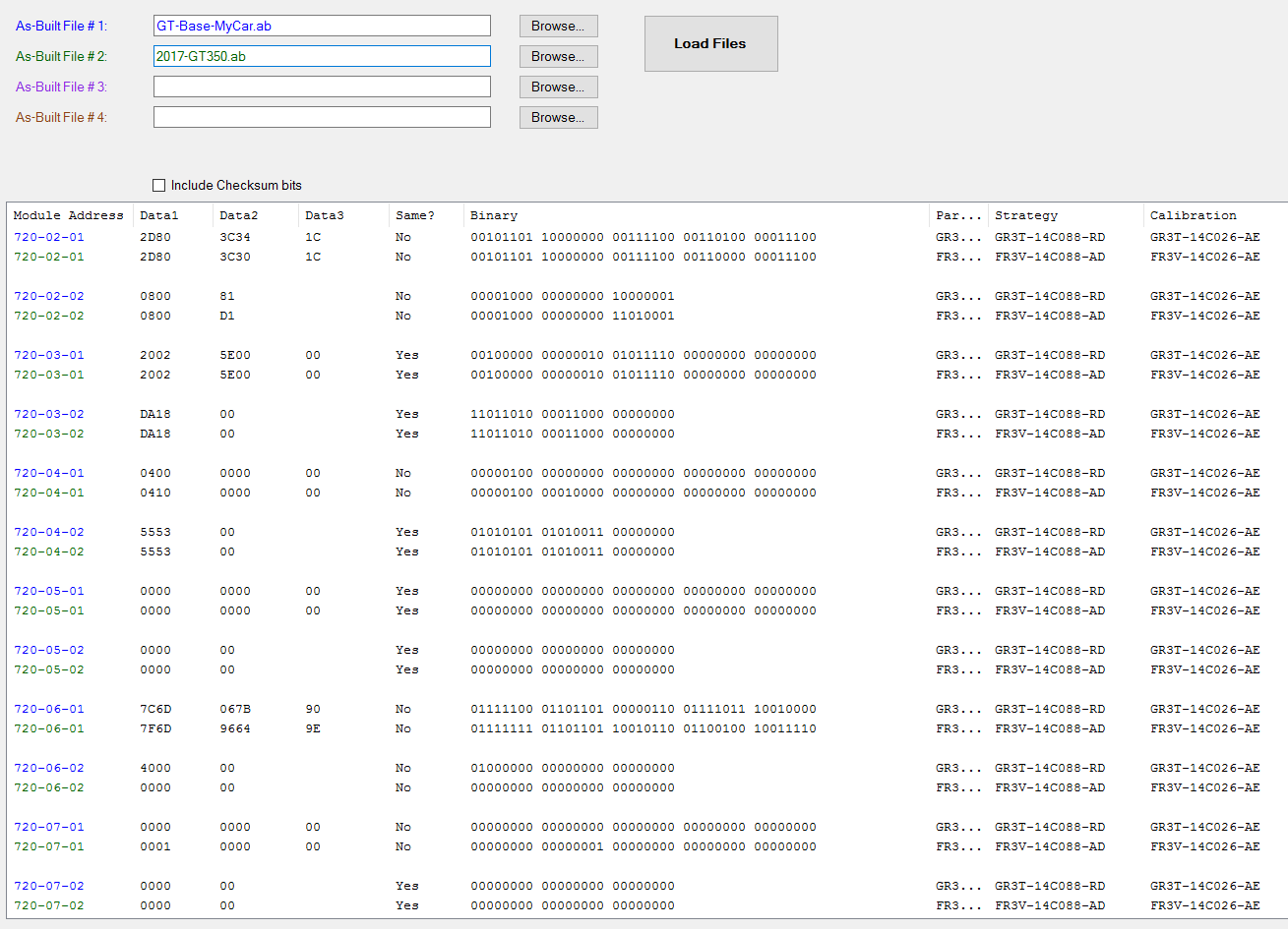

Okay, so doing my best guesswork on the digital speedometer.
This is probably in the IPC (720) somewhere if it exists at all.
The attached image below has all the lines where my as-built 17 GT Base w/PP & 6MT (blue) differs from a GT350 (green)
[MENTION=23778]AngelDeath[/MENTION] tried messing with 720-07-01 with no joy (I think?)
I'm guessing that the idea to look at 720-07-01 came from the F150 side, since certain settings there can make their digital speedo disappear. But that location seems to do a *lot* more on the F150's. There doesn't seem to be much going on there in our cars in 720-07-01.
720-06-01 on the other hand seems to have a lot going on, and I think (???) we know that the fifth hex digit controls whether the diff and transmission temps show up in the center display. 0 is both of those off (as it is in my car) and 9 is both of them on (as it is in the example GT350.)
If nobody beats me to it, I'm going to play around with the values in 720-06-01 and see if a digital speedo doesn't magically appear.

Some more digging, I compared an EB base, my GT Base, a GT Premium, and a GT350 - all 2017's with 6MT.
In the IPC, here are the hex digits where the GT350 is different and the other three are identical to each other:
720-01-02 xxxx 0xxx - GT350
720-01-02 xxxx 1xxx - Others
720-02-01 xxxx xxx0 xxxx - GT350
720-02-01 xxxx xxx4 xxxx - Others
720-04-01 xx1x xxxx xxxx - GT350
720-04-01 xx0x xxxx xxxx - Others
720-06-01 xxxx 9xxx xxxx - GT350 (Trans & Diff Temp on?)
720-06-01 xxxx 0xxx xxxx - Others (Trans & Diff Temp off?)
720-06-02 0xxx xxxx - GT350
720-06-02 4xxx xxxx - Others
720-07-01 xxx1 xxxx xxxx - GT350
720-07-01 xxx0 xxxx xxxx - Others
Also, here is 720-06-01 to be pondered over. Blue = GT Base. Green = GT350. Purple = EB. Brown = GT Premium.
No joy on any of this stuff. The bytes it did let me change didn't seem to actually have an effect. I wouldn't call it all hope lost for a digital speedo, but maybe a cluster swap or reflash is the only way...
I was ready to place bets on the dig speedo being here. It even aligns with the F150 guys. But I am a bad gambler.
[MENTION=25607]Spart[/MENTION] Edit: I tried 720-07-01 xxx1 and got write fail error. Same for you?
