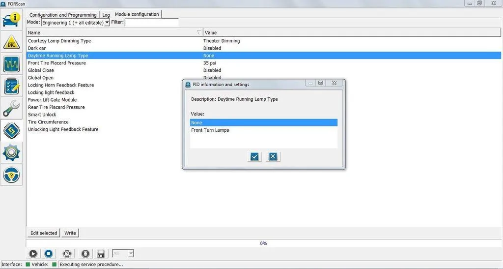

Can anyone screen shot the non-Asbuilt portion? I'm curious. I take it that it provides a more simplified "on-off" control of various functions so we aren't constantly modifying hex to make it work.
I can do that, but its in sections, so what section do you want, and yes its limited due to time taken to figure out what it does. I can take a shot in hex and in lamen terms so you can see the difference.
Screenshot from a Previous thread I started
don't have it connected to car right now, but here is a cap from the forscan forums. it would look similar to this. (see attached)
