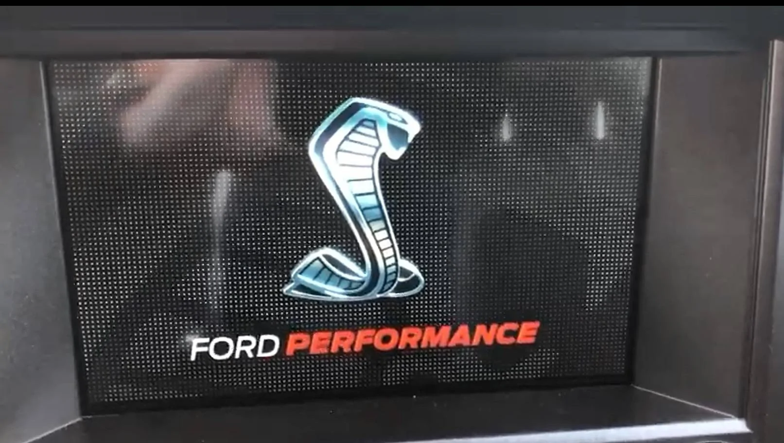

Not sure if this has been shared yet, found in another forum.
GT500 (Mustang EVO) Splash Startup and Shutdown:
7D0-02-01= xxxx 10xx xxxx
7D0-03-01= xxxx x0xx xxxx

I'll try these splash screens on my 2017 GT with Sync3 Version 3.0. Want to replace the GT splash screens that were eliminated with the Version 3.0 update.

It seems that this splash screen is available in Sync3 Version 3.3, not 3.0.
