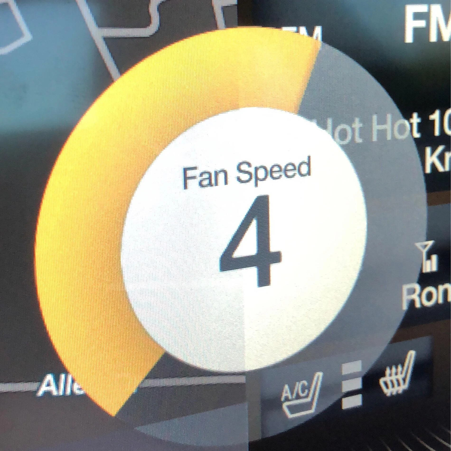

Has anyone figured out which Sync 3 APIM line controls the climate ‘Fan Speed’ display (see pic) when you use the fan speed hard buttons ? This shows on my Mustang and I’d like to modify my Expedition to have it display as well. Thanks.
