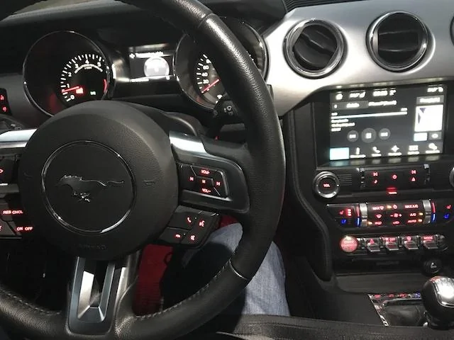

So what exactly is a "Mycolor power & support" feature in the list?
BTW does anybody know if the color of the button light can be changed? Tired of the factory ice blue and want a uniform interior lighting. Thanks!
I have been change the color of the button illumination but it needs soldering.
How did you change that? Through FORScan or you removed the bulb behind the buttons somehow? I would like to change the color as well.
You literally have to disassemble the buttons and replace the LEDs. Most of these are tiny surface-mount LEDs which require extreme precision soldering, and you won't be able to do color-change RGB LEDs as those require an extra control wire/circuit trace which the buttons do not have, so you'll be stuck with whatever color you choose to replace it.
Not impossible, but intensely difficult. People who have done this (there are one or two) swear never to do it again.
Thanks man. I am not going to change those LEDs then!
