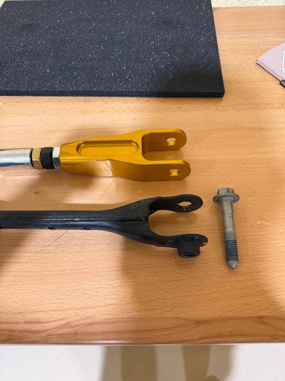

I just received the @Mod Mustang Racing adjustable rear toe arms yesterday and started to install them, but it appears I may be missing something. I’m installing on my 2024 Mustang, but the arms are for 2015-2024, so I would assume the suspension is the same. The stock toe arm has a nut welded on one side where it attaches to the knuckle. The MMR toe arm just has holes on both sides, so it appears to me it will require a nut/washer to connect. No nut was in the package and there are no instructions, so I’m not certain. I called them yesterday and they recommended I email so I could send pictures. I emailed and received a response they would check into it and let me know. I did not hear anything further. I want to get the install finished this weekend, so I’m hoping someone can provide guidance. I’m assuming I will need to source an M14-2.0 grade 10.9 nut/ washer to connect the toe arm. Is anyone else who has installed able to provide feedback on whether you had extra parts or what you did? I’m guessing it’s possible the S550 had a loose nut, rather than welded like my S650, in which case the S550 would not need any other hardware, but I don’t know. Any help would be appreciated.

I would just take the bolt to the hardware store to match the thread pitch and get you some grade 10.9 or 12.9 flange nuts (no washers needed) and call it good. That’s what’s on the factory toe links, only they’re tack welded in place.

Thanks. That’s what I’m planning to do, but just wanted to be sure I wasn’t overlooking anything.

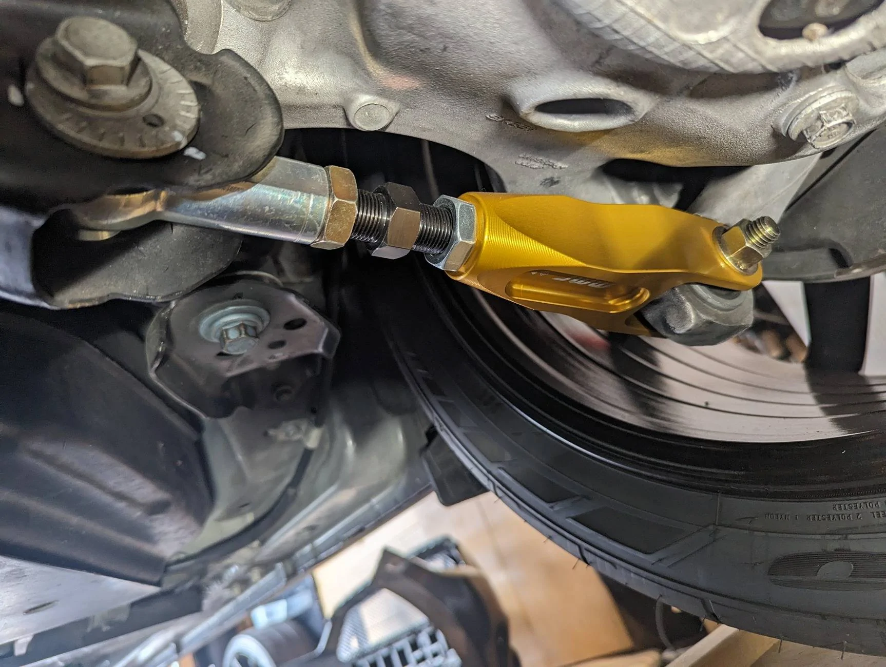

Check this video out. I have the Steeda adj. toe links on mine. I can’t remember whether I used washers behind my nuts or flange nuts (which would be better), but either way you’re on the right track.

Yeah it's bad that they don't provide the hardware needed. Obviously they haven't actually installed one. Order a yellow zinc flange bolt and nut online. Local places won't have that.
