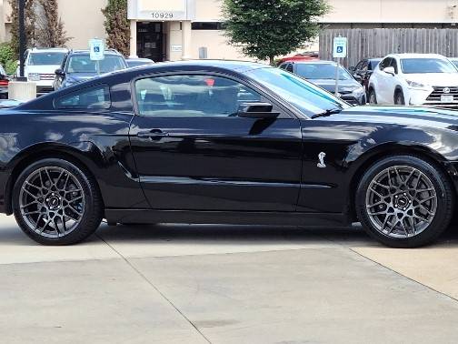

Firsttexan
Sep 7, 2021
1,214
1,039
2011 GT500 '19 GT PP1 '13 GT500, 98 GT, 92 LX 5.0
It looks funny. If you stay close in total tire dia front and rear, now you have a larger sidewall in the front and a skinny one in the rear. May hame some benefits on handling and such, IDK, but I could never get past the eye sore it created.
Looks pretty good there.
