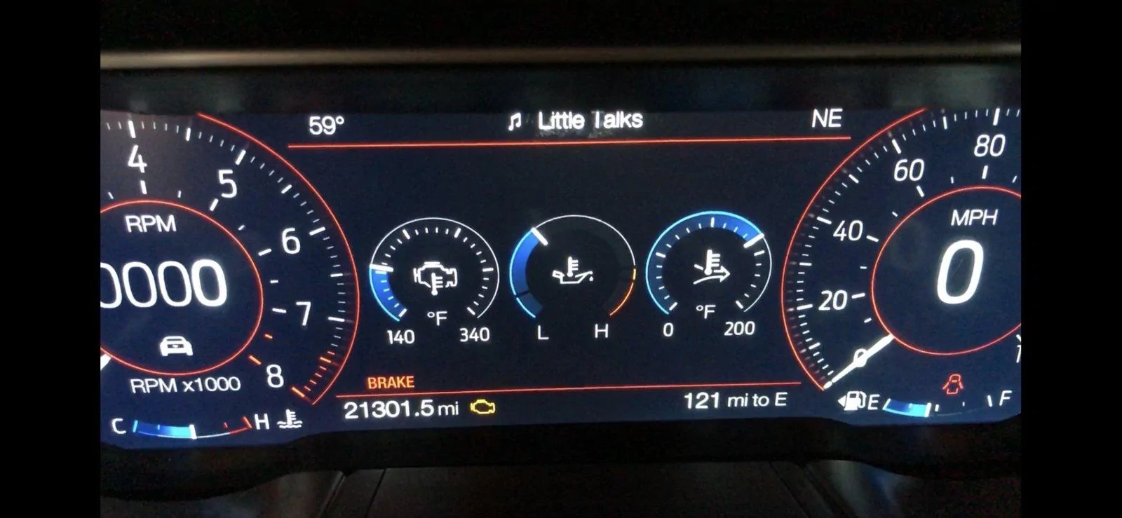

Here’s a pic I have to give you some reference. In regards to my IAT gauge, it reads IAT2 instead of IAT1 like most cars would but I am Lund tuned plus I’ve been idling quite some time before I shut the motor off.

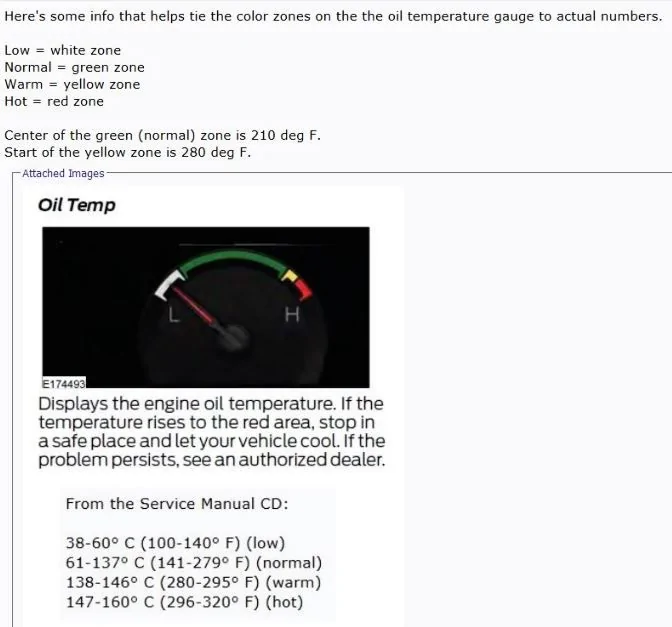

My 18 non-digital gauge cluster show Oil Temp in the small LCD. However, it typically only displays the word 'Normal', no actual temp.
If you press "OK" when it's on the Oil Temp you should see a virtual gauge like below ... that's how the 2015-2017 works at least.
Yes, sure does. I thought I tested that to check for more detail. However, I just retested and you are exactly right. Thanks!

^^^ BTW ... that photo is of my GT at full operating temperature, and the oil temperature gauge needle is just to the left of center which is 200 F based on what each color zone represents (needle at the middle of the green zone is 210 F).
I then took an IR temperature gun and measured the black oil pan temperature and it was 199 F. So that tells me the virtual temperature gauge is pretty accurate.
