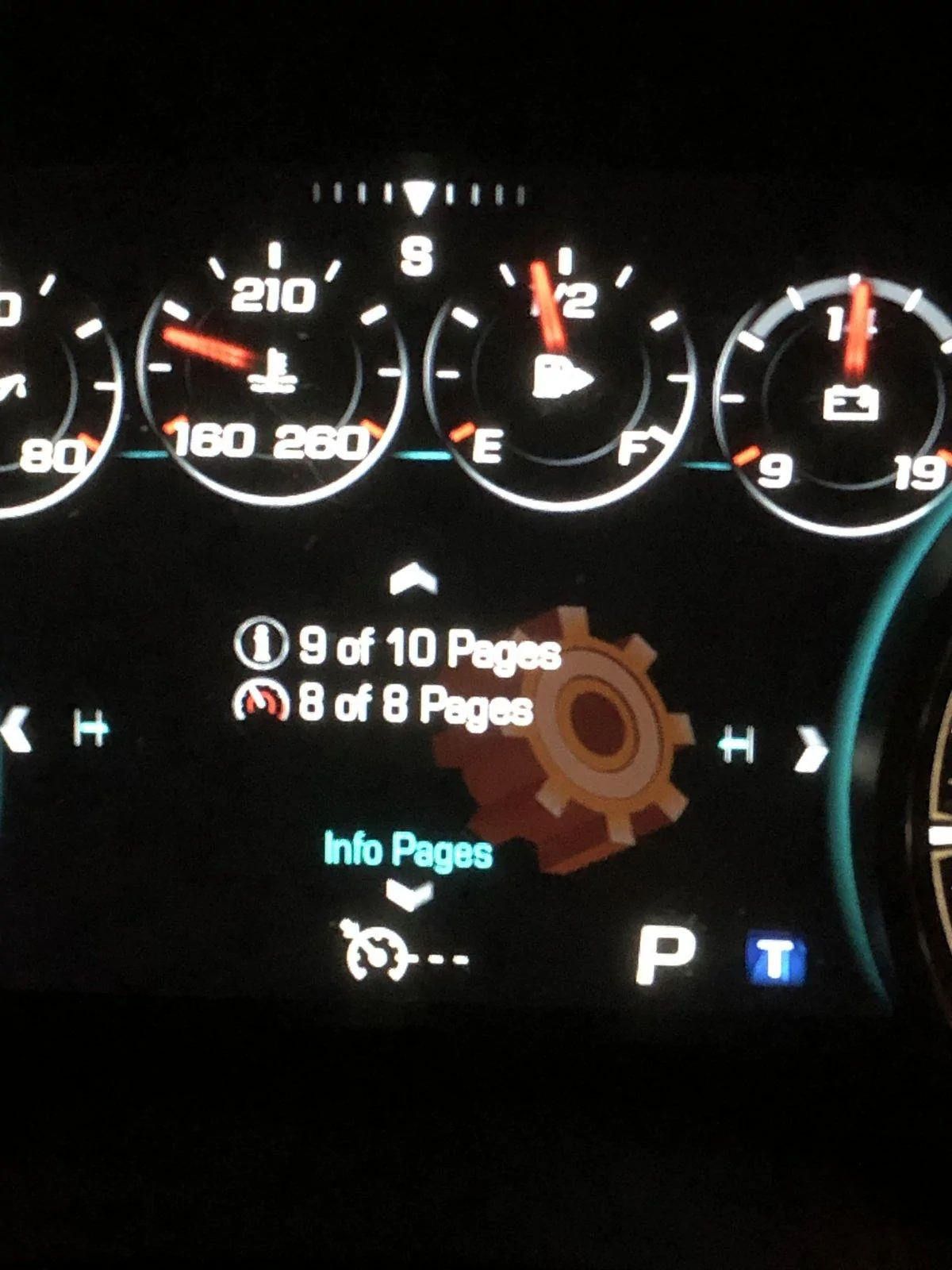

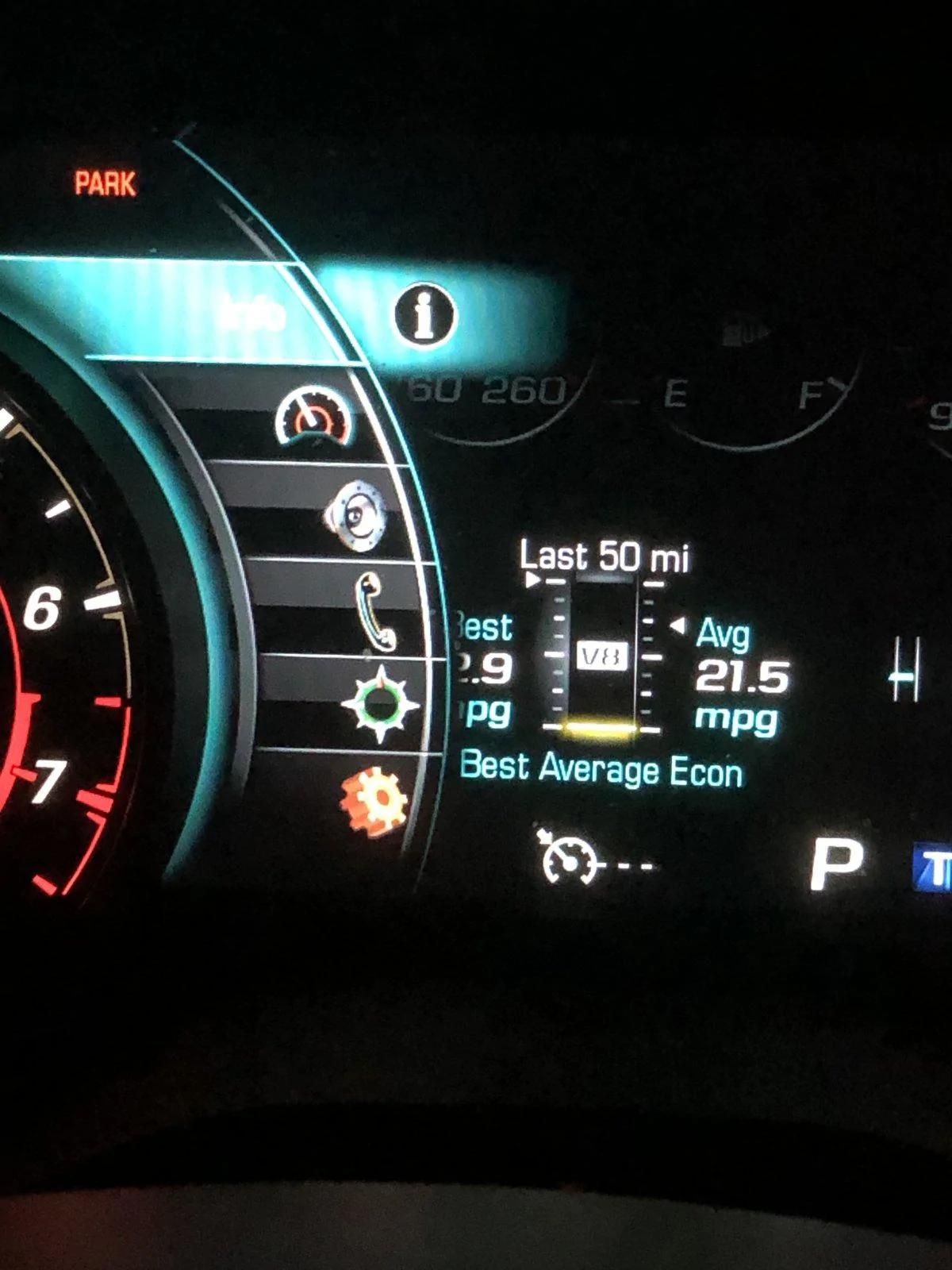

If it’s like the Camaro instrumentation set, you will not find it when scrolling through the information pages. You have to put it on the information pages. The way to do that is through the SETTINGS pages. If my photos post here you’ll see what I mean. This is, as I mentioned, on a Camaro, but maybe Ford does the same type of menu personalization.
Look for the SETTINGS icon on your menus. For my car, it’s the gear at the bottom of the display.
Then select the PERFORMANCE pages. I currently have all 8 of 8 pages set to display. But on the INFO side I am displaying 9 of 10.

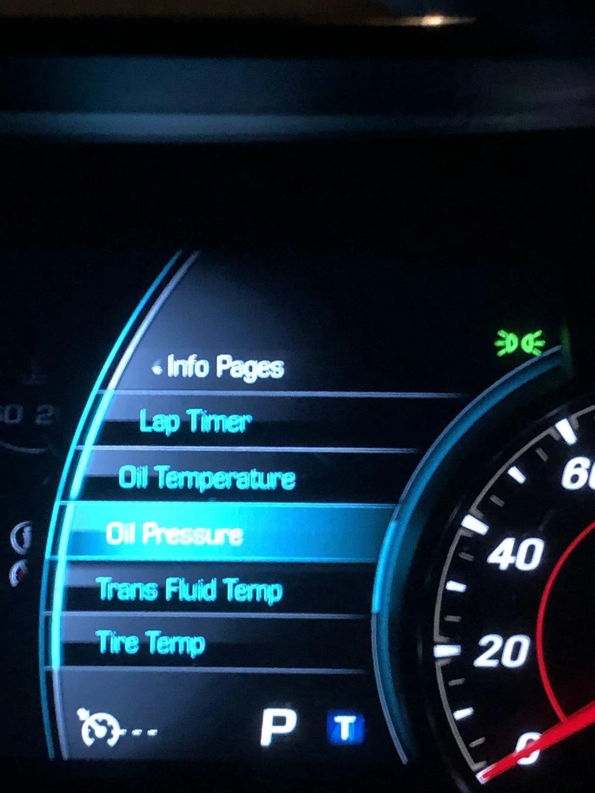

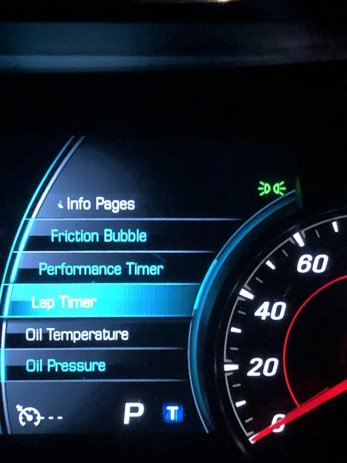

I unselected OIL TEMP so you can see what it looks like unselected. The text is white and the bar to the left of the text is white. If I left it like that, I would not be able to display my oil temp gauge by scrolling through the menus. It simply wouldn’t be there.
And then I selected it again, so this is how it looks in SETTINGS with OIL TEMP selected. The text is blue and the bar to the left of the text is blue. I am thinking it’s a similar process for Mustang.

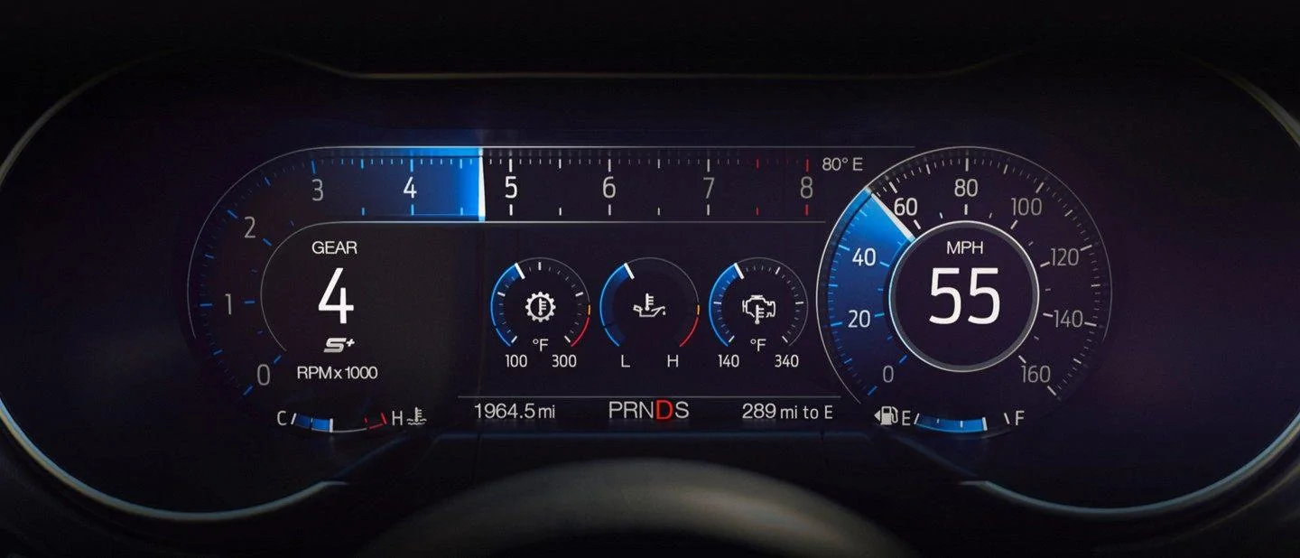

I have a March 2018 build with the digital dash and I don’t have the engine oil temp gauge either. It’s literally my only complaint on an otherwise perfect car. It especially bothers me since the early 2018 builds have it.
This website image must have been from the early builds.
The Engine Oil and Cylinder Head Temp Gauges look directly proportional in the image.
