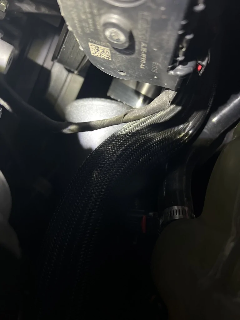

Still haven’t got that fuel priming sound yet. Replaced fuel pump, swapped fuses and relays.
My old reports showed the fuel system highlighted blue.
Tried to start on stock tune. No bap plugged in. Have a flat layer of smoke coming from exhaust.
