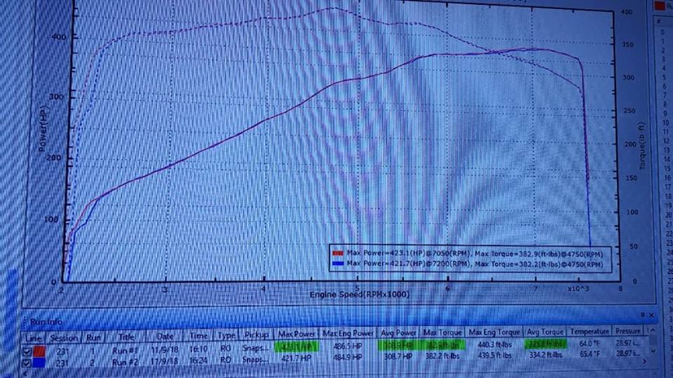

Agreed. My '18 Manifold, GT350 CAI, AED 93 tune dyno.Honestly if you're not going to rev past 7300rpm, you should just stay stock manifold, or 2018 intake manifold (preferably ported) is what I suggest.
Do not worry about revving to 7500-7700 RPM. This motor can definitely handle it. IMO the 2018 intake manifold is the goldilocks manifold for retaining as much torque as possible and maximizing the high RPM power within the limits of this engine. It is very similar performance to the GT350 manifold. It just doesn't hold peak power quite as far to 8,000 RPM. It also doesn't lose as much lower end torque.
