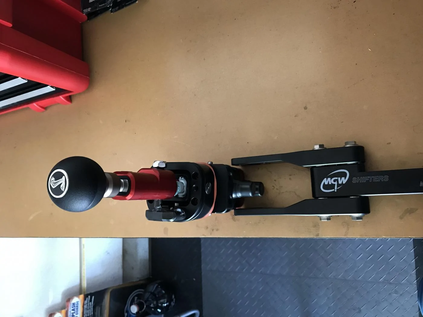

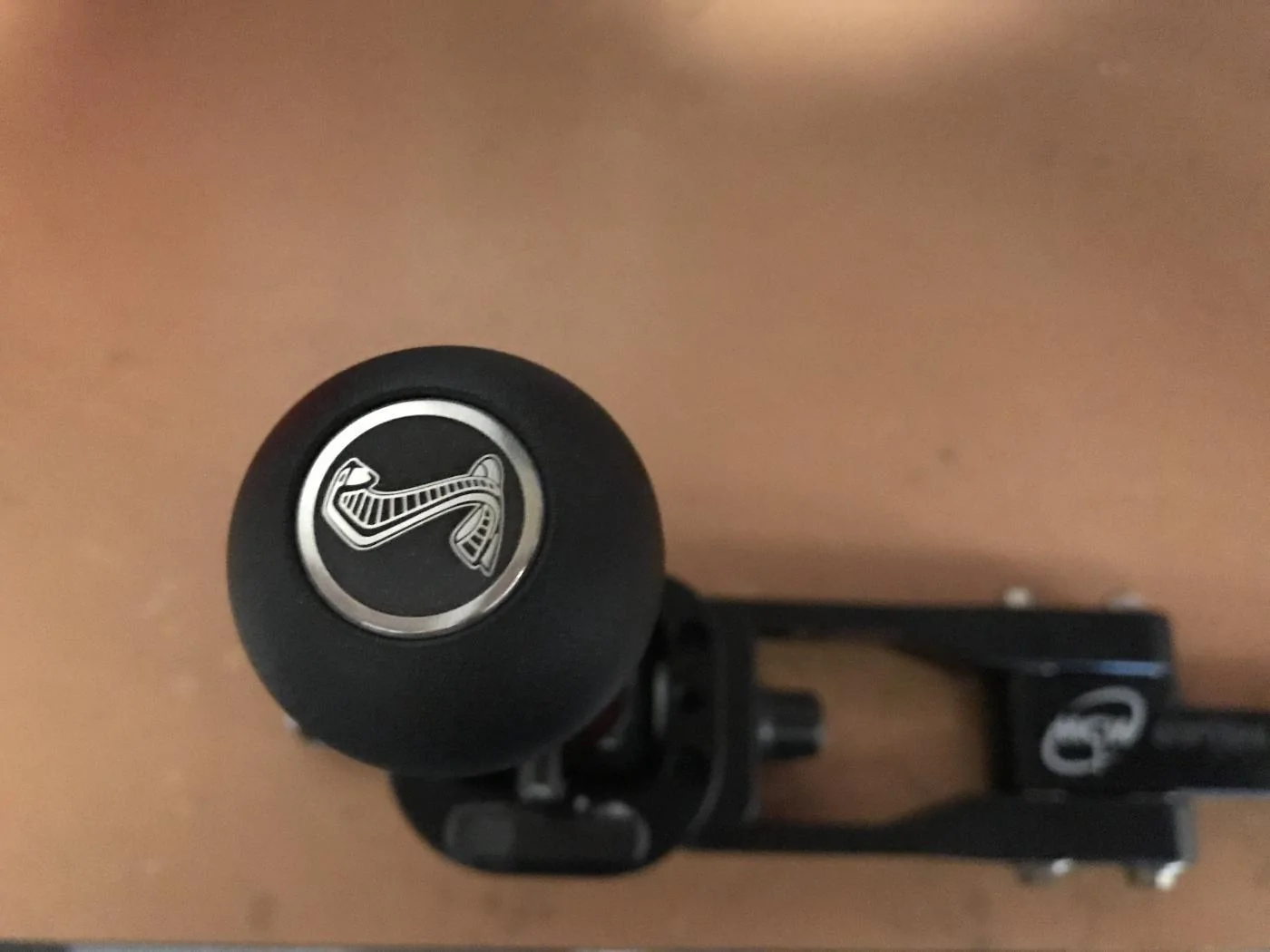

Where did you get that shifter knob? edit looks like from mgw... are the threads the same on the stock shifter?
No, they are not. The MGW has a dual thread design that accepts both the stock shift knob and their custom knobs.

The GT350 great shift feel comes from the Tremec, not the shifter. There is absolutely no feel in the GT350 shifter itself, as it is a joystick in design - a ball in a plastic socket.
The MGW has built in spring loaded gates, to some degree, which, in addition to the great Tremec feel, makes shifting feel even better.
The MGW certainly isn't necessary, but it does improve the driving experience for me.
