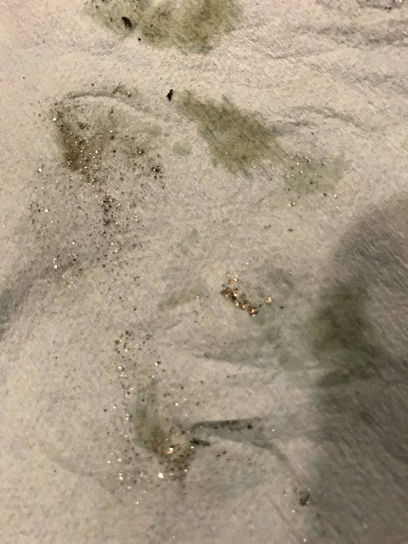

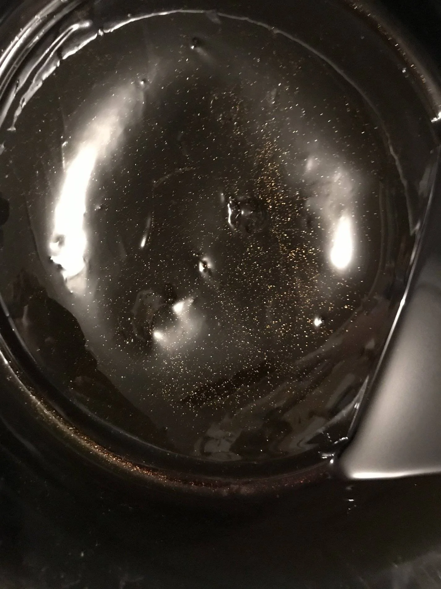

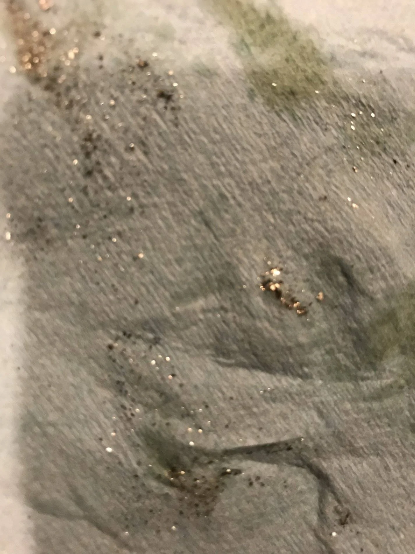

I wanted the Ford to open the oil filter. I went there show the pics, they said "if you have any complaints about the car, there is nothing we can do." Service manager also said they dont have the tools to cut it open. If they cut it with a saw, there will be metal flakes because of that... I will try to open it with a can opener this afternoon.
Any other recommendation?
Can opener may work. If it doesn't, you can poke a hole with a screwdriver and cut the rest with snips.

opened the filter, looked pretty clean.
Not sure where the particles came from that I found on my oil pan. I guess I will keep driving...

That’s awesome news. Drive the crap out of it and forget about the flake. Could have just been a machining flake that got wedged somewhere that the washing process couldnt get out.

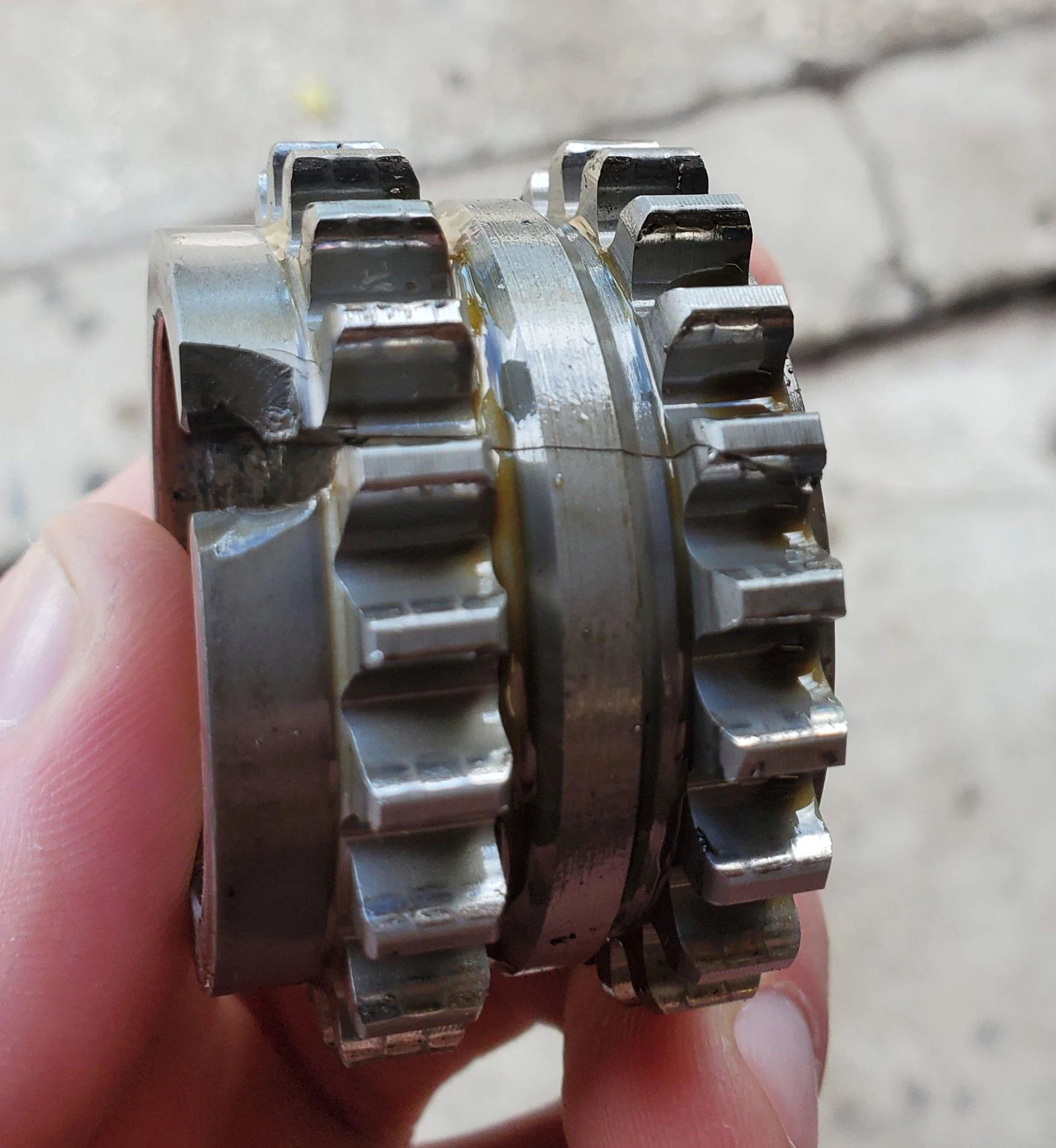

So just an update:
Shortly after this post the car started having some timing issues and was throwing several codes. The car has been sitting for a bit as I just opted to purchase a built short block and other parts instead of doing a bunch of investigating. Turns out it would have been a quick find. Upon pulling the engine it looks like the crank sprocket/gear was the source of the metal. This was a Boundary crank sprocket and it appears to have chipped at the keyway and cracked all the way through. Because of the crack it was loose on the crank. This definitely explains the timing issues and the chunks I found in the oil. I'm not sure if this was a fluke or if the Boundary crank sprocket is not a well made as the others available, but the new OPG and CS set I bought was from MMR.

When I reached out to Boundary regarding the breakage their President, Travis Rosenbarger, was quick to reply, apologize and replace the part. He told me "...it seems to have been a particular batch of material that caused the issue you are seeing." and in another email, "Those original units we had to outsource the lathe work, and then we milled the teeth in. The new units are 100% in house sourced so we can control everything. You won’t run into this issue again, and I really apologize for it."

Geese. When did you buy yours? Im wondering which batch mine is from. I bought mine around may 19. An apology is great and all on their part but man you got lucky that it didnt completely break apart. That would of trashed your engine. Heck you dont even really know if those metal bits did any harm. The new cs are being advertised as 4340 but I wonder if the original ones were.
