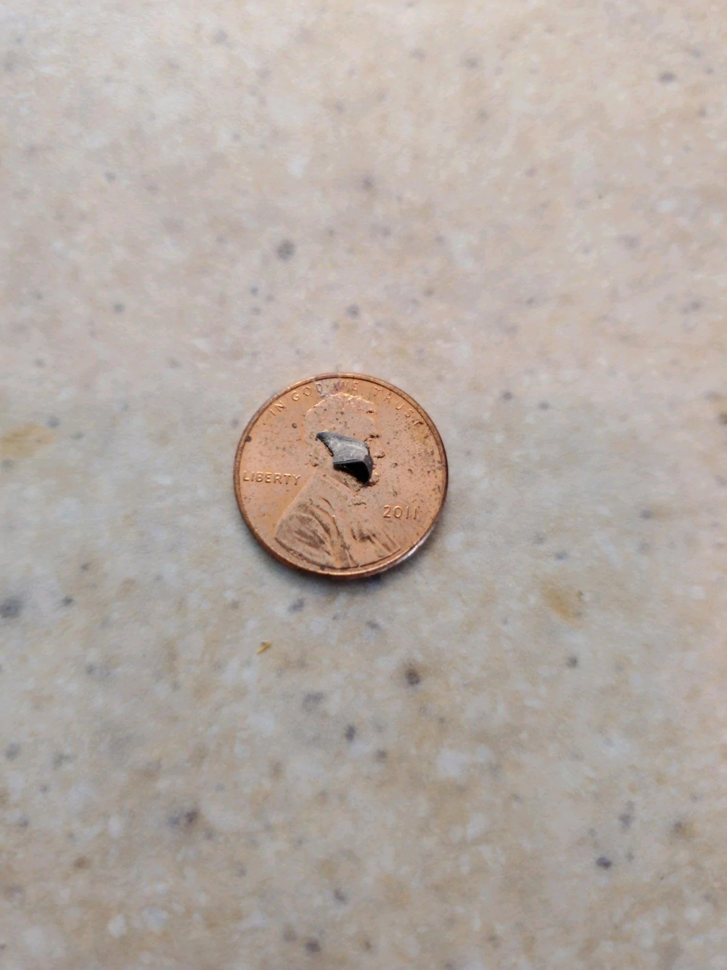

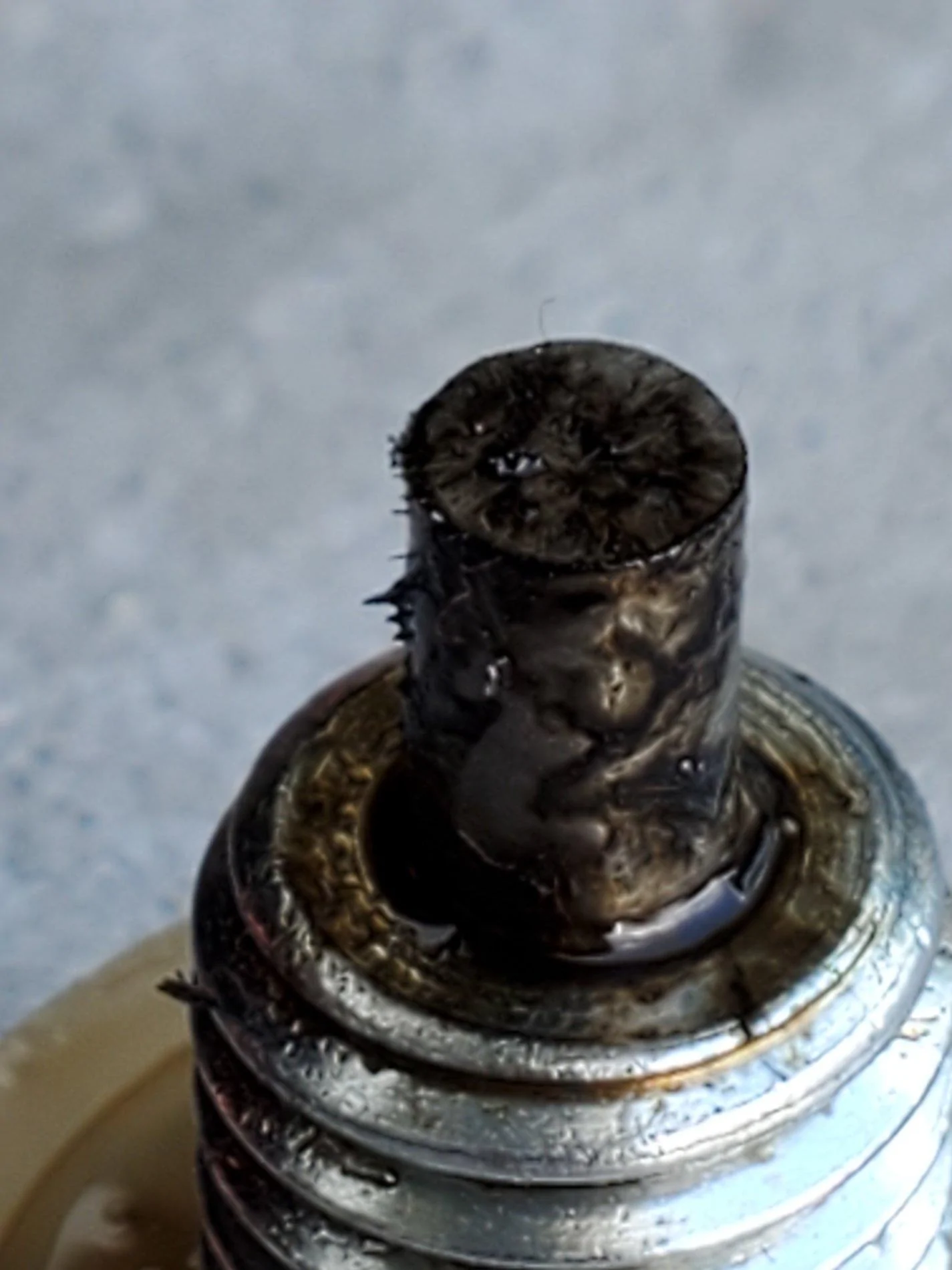

So I was working on the car this weekend, and among a few other things, the oil pan was one of the items being replaced. Upon draining the oil I had a mini heart attack as I pulled the magnetic drain plug and saw a metal flake on it. There were also some more tiny metal fragments as well. I didn't really see anything else in the oil and the old pan appeared clean as well.
The car has driven/drives fine, I've had a stage 2 Procharger kit on it for about six months now and haven't had any engine related problems(that I know of) just a bad O2 sensor and rear wheel bearing. I wouldn't say i'm the gentlest driver, but I don't beat on it constantly.
Tomorrow i'll be cutting open the oil filter to check out what's inside, but what else can I look at/check? Where do I go from here? Is this my excuse to rebuild and do forged internals? (If so, anyone know of a reliable place in/near Pasco County, Florida?)

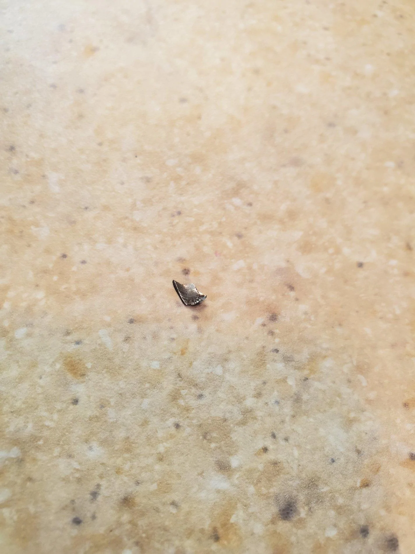

Yea that's a pretty big chunk. Was that the biggest piece?
Besides the tiny bits on the end of the plug, yes. This was the only piece I found in the oil.

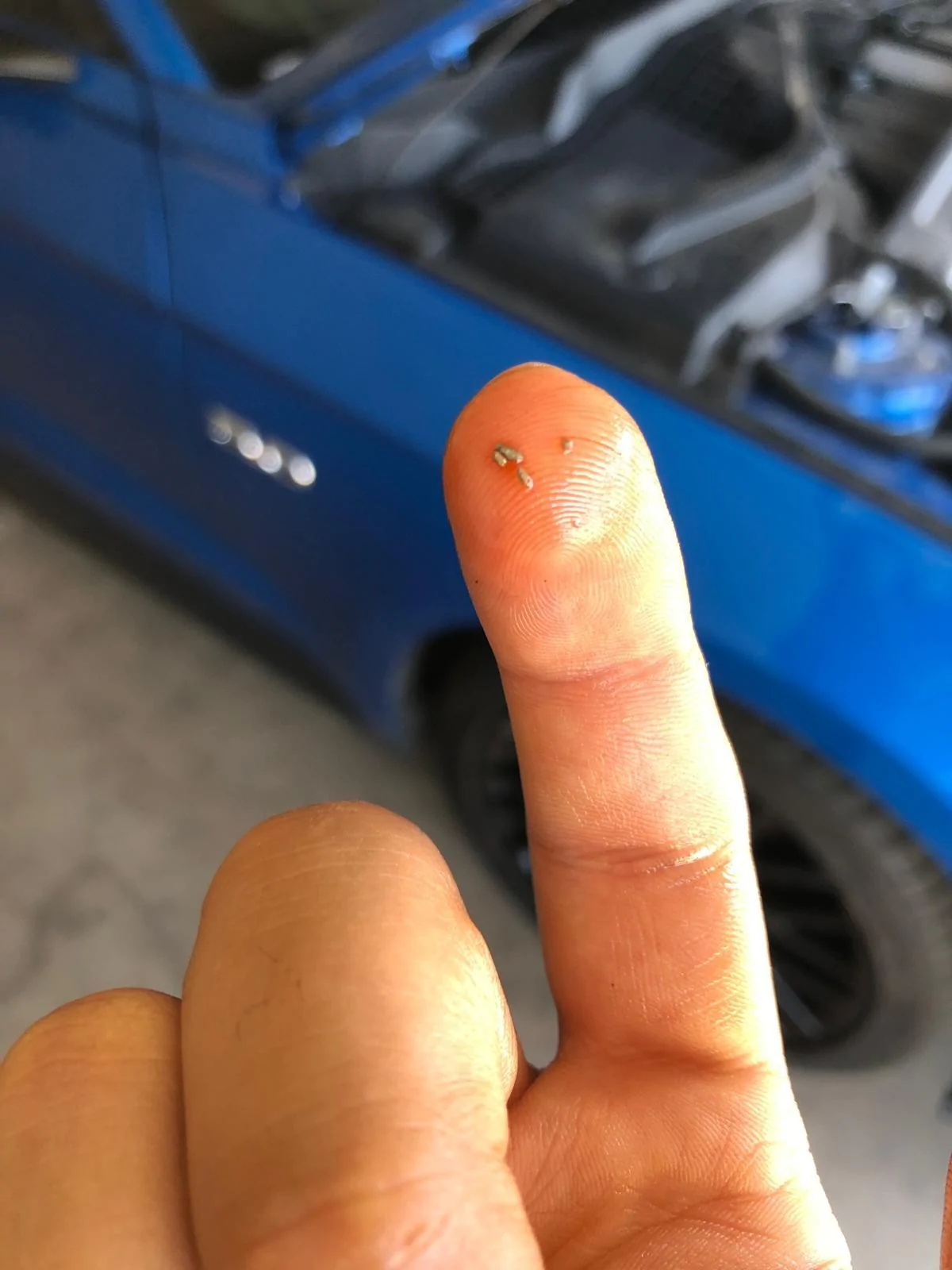

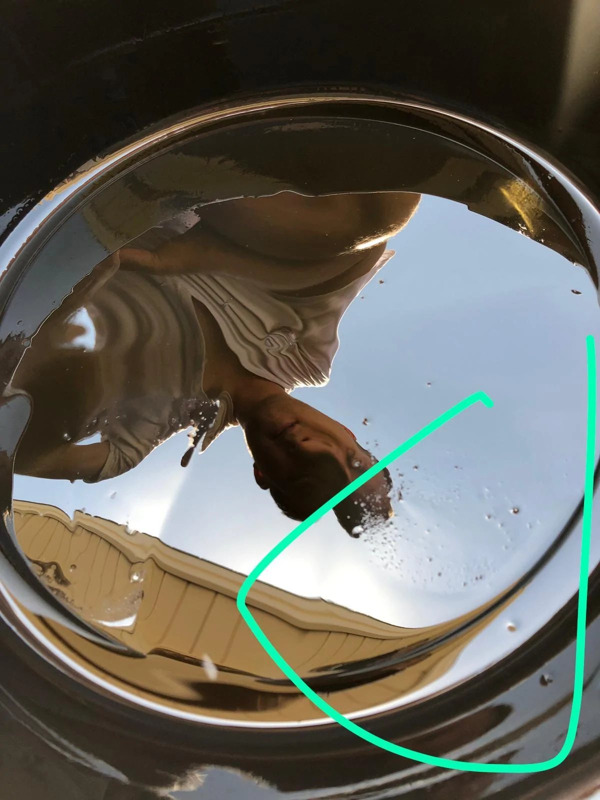

I just did my first oil change 1 hour ago, and I was about the create a new thread and saw yours. Mine is not as bad but here are the pics;
we didnt pay attention much to not contaminate the oil but The magnet was holding the big pieces that are on my fingertip. there was too much shiny stuff all over. It is 2019 btw.
I had the knocking and thudding till 2000miles. After that, it got quite by itself. Now it is at 2500miles.

Did you cut the filter open?
ponyv6
May 25, 2016
188
ozzy
2019 301A PP1 Velocity Blue
I wanted the Ford to open the oil filter. I went there show the pics, they said "if you have any complaints about the car, there is nothing we can do." Service manager also said they dont have the tools to cut it open. If they cut it with a saw, there will be metal flakes because of that... I will try to open it with a can opener this afternoon.
Any other recommendation?
