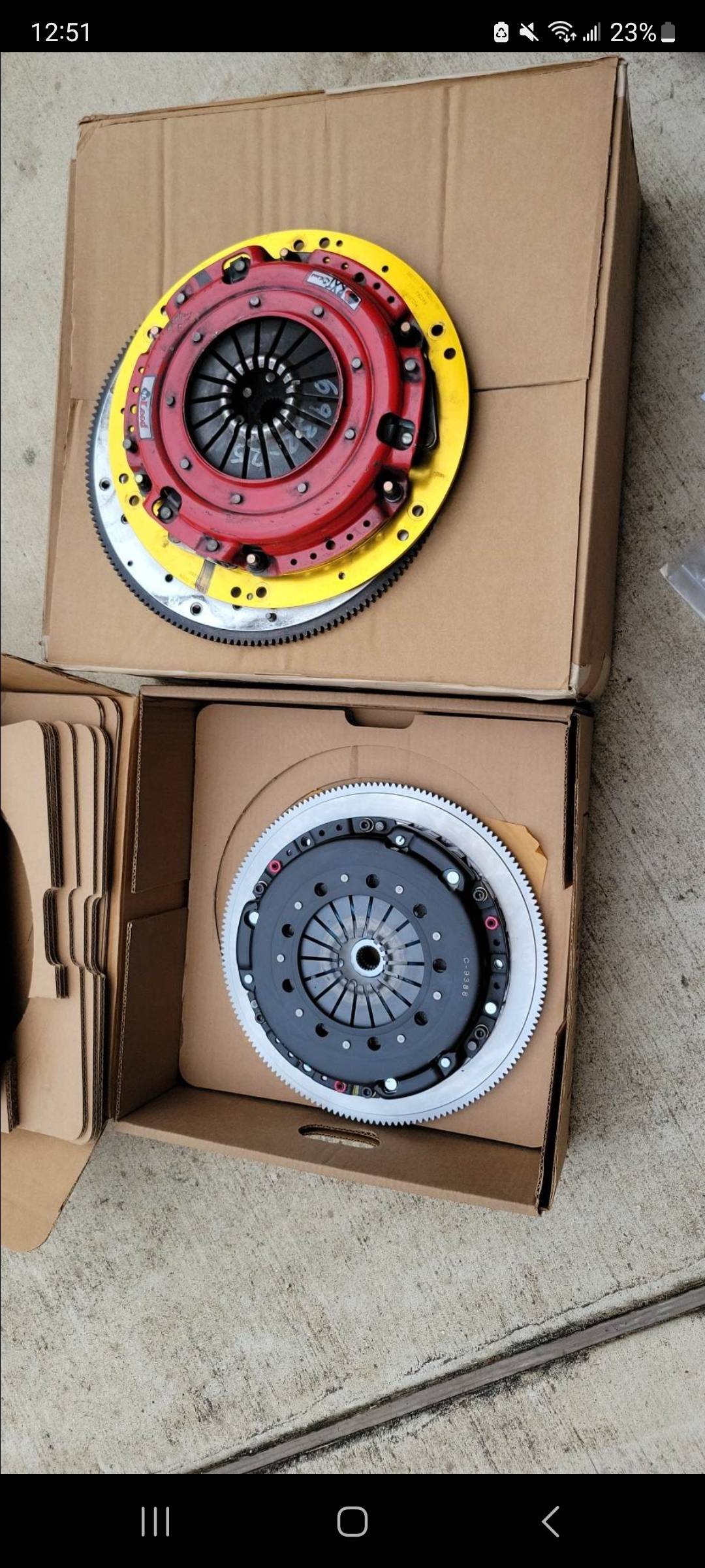

I finally destroyed my mcleod RST clutch.. so this is a video looking at the RXT vs Vengeance stage 2.. recommended by beefcake
https://www.tiktok.com/t/ZTRKHWyYm/

Thanks for posting the video comparison. How did the two compare in pedal feel?

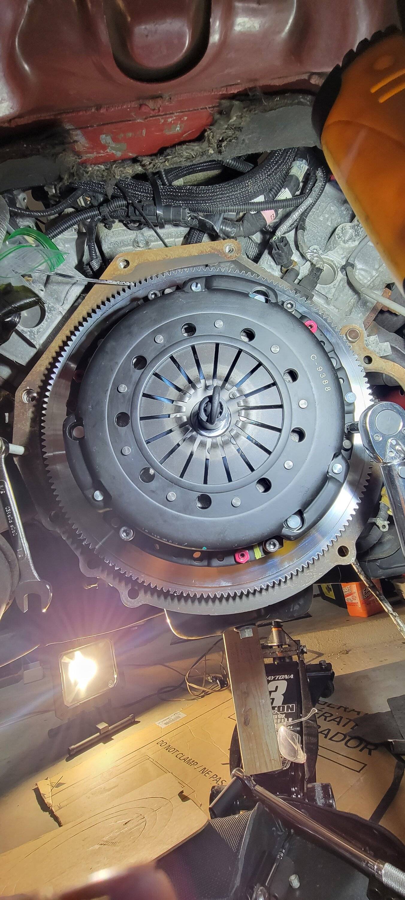

I'm only 50 miles in on the break in... but the pedal definitely started off harsh, high grabbing, and has settled down quite a bit. I'd say the Vengeance stage 2 pedal feels the same as the RST.... I never installed the RXT, buts its the same hardware as the RST just different clutch discs.
Going from the RST organic friction discs to the vengeance cerametallic makes smooth take offs more difficult, so I'm still adjusting.
