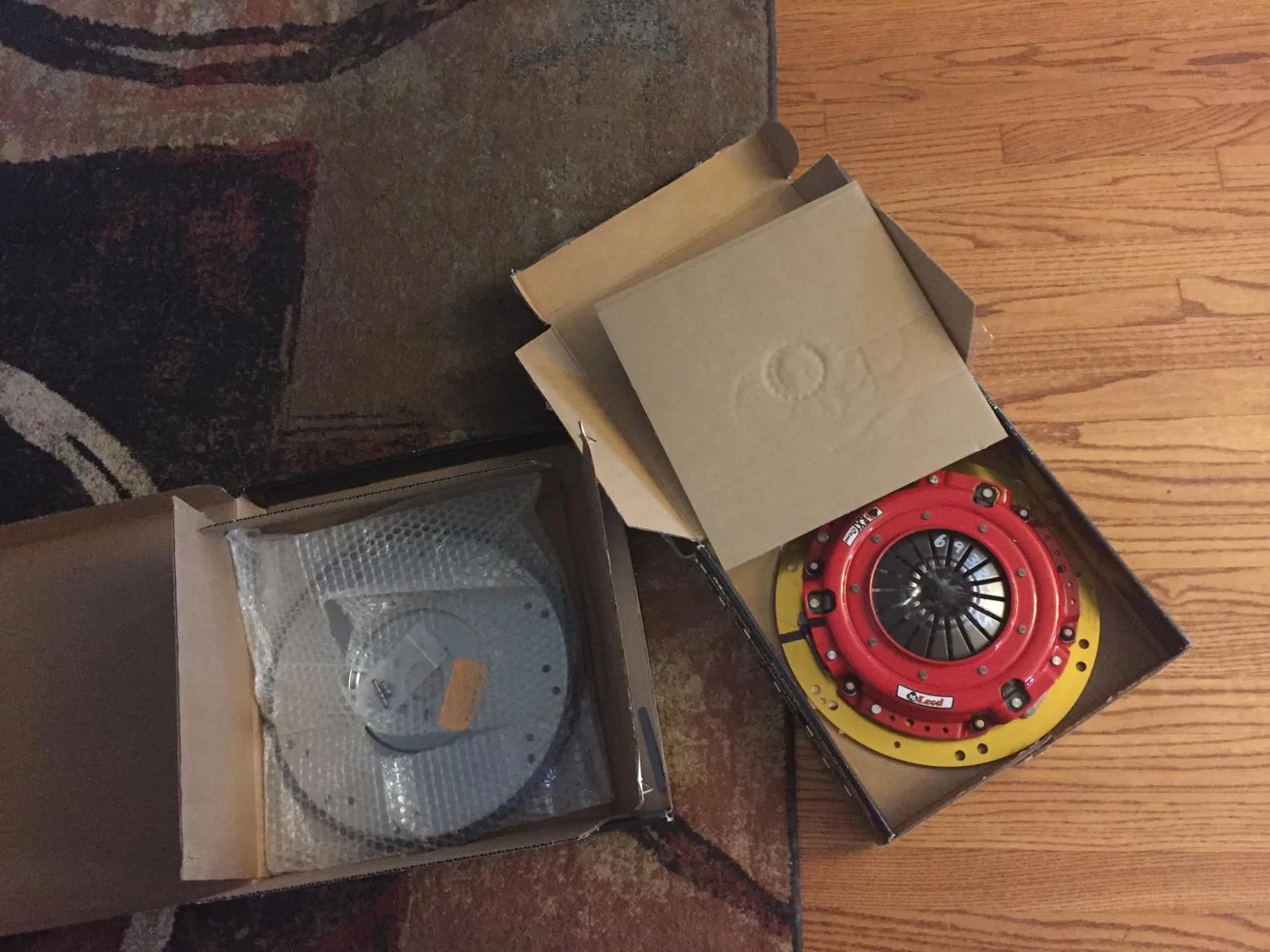

Just wanted to give my opinion if my new McLeod RXT twin disk clutch I installed:
It's freaking amazing!
If my wife didn't know I blew up the clutch she probably wouldn't be able to tell the difference.. It feels a bit lighter than stock actually.
No chatter unless I really bog on take off
Slightly more NVH as I got the lightweight steel flywheel, you can hear it wrrr up.
Install was easy and straightforward. I replaced the pilot bearing and throw out bearing while I was there. The pilot bearing was a pain to locate but installed easier than my WRX's was as it has a collar to help it sit flush.
I'm still in my break in period but all in all for a grand total of 50 bucks cheaper than ford wanted to install a stock shit clutch I installed this masterpiece of a clutch kit. 5 stars so far

op... you did the install on jack stands? Is that the aluminum fly wheel?
I did. Borrowed a buddy's jeep stands so I had it about 2 feet up..
Went with the lightened steel as I heard it had better DD characteristics.
It spins up a bit faster but otherwise feels like stock
