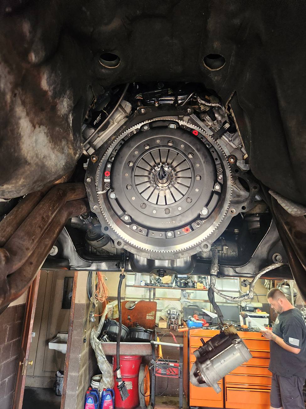

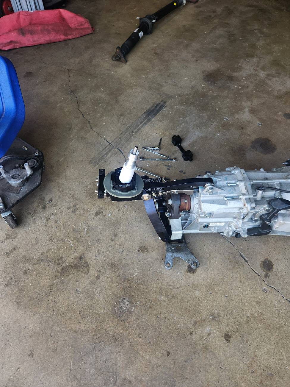

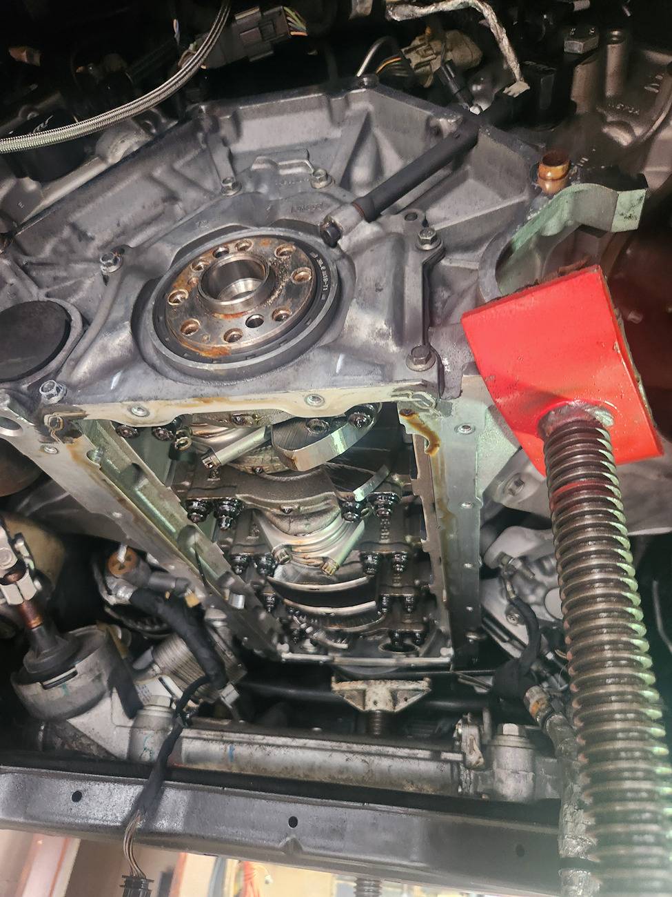

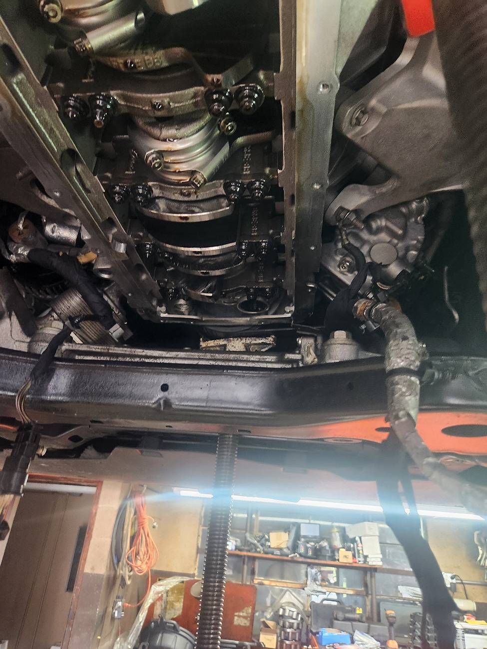

Update...the clutch is finally in the car and torqued to spec (with loctite as the directions specify). I also had the PBH Gen1/Gen2 metal oil pan conversion done to the car while it was down. I hope to have it back on the road here by the end of the week and begin the clutch break-in procedure. During the transmission removal the Barton shifter was damaged, so I got another one and it's installed on the trans, as well.

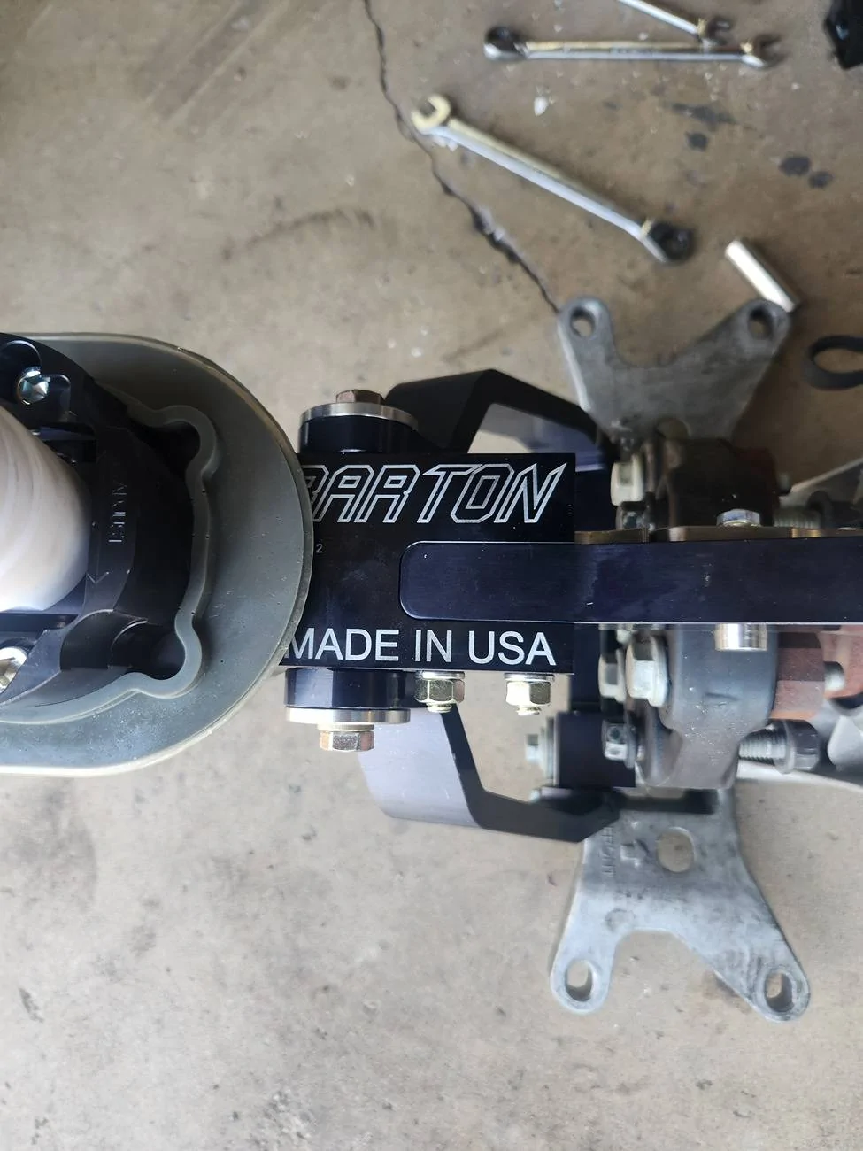

How'd the shifter get damaged? I need to upgrade to a trans mounted shifter lol
The trans fell off the trans jack. I wasn't there when it happened and the shop owner and I have been friends for 37 years so I couldn't be too mad at him.
